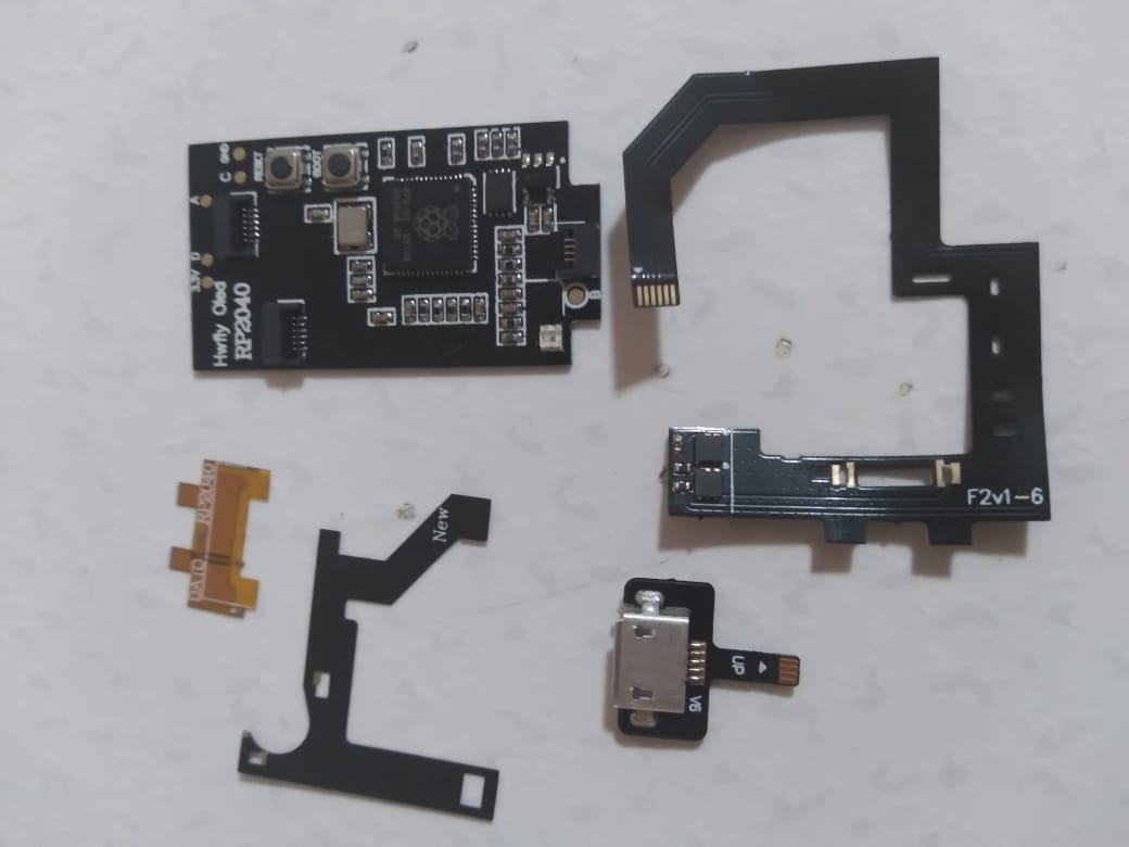

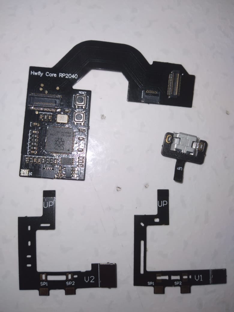

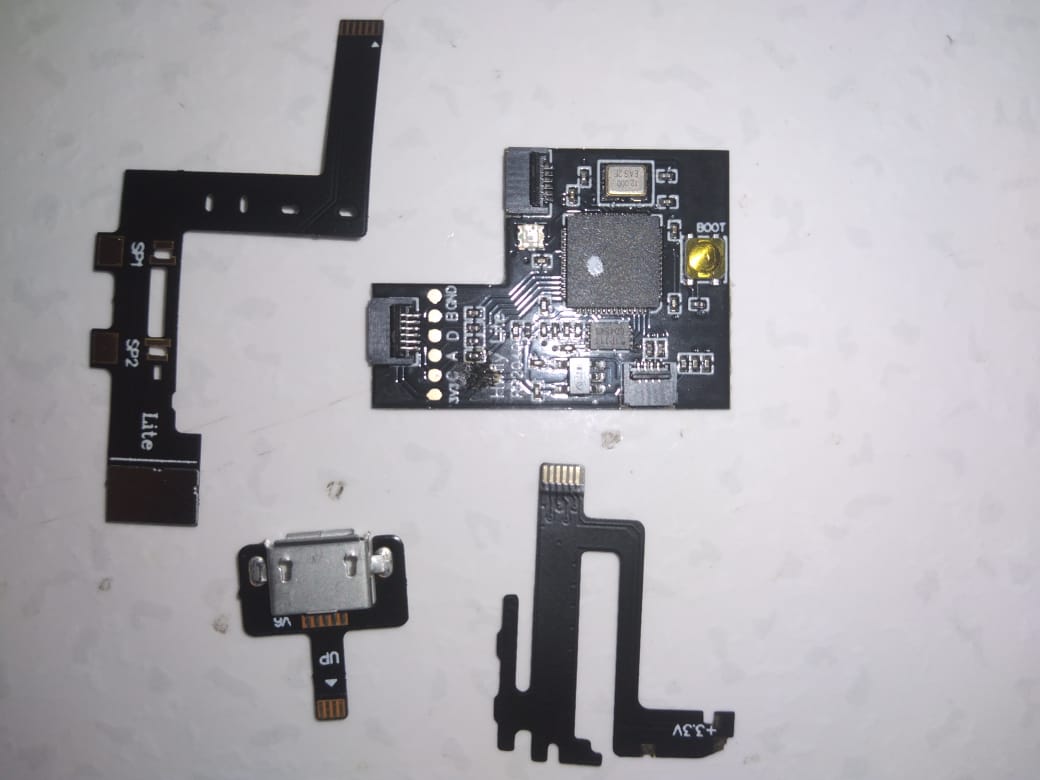

yes i see the update the firmware some hours ago,BUT the diagram you send me here,my chips are totally difrents,they looks like a hwfly,so how this diagram works then?

See that square black chip in the middle of the board? It's an RP2040 System On a Chip. The diagram I sent you is a pinout of the pins coming off that chip.
