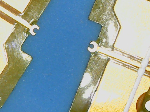

Alternate SDA/SCL points on the switch lite, on the APU side of the motherboard. Don't even have to remove the apu cooler! The points are tiny and have to be scraped though.
Reactions: sheggy012
Rehius pointed these points out in one of his posts, as they exist on all motherboard variants, but recommended against it, due to the small nature of the points.

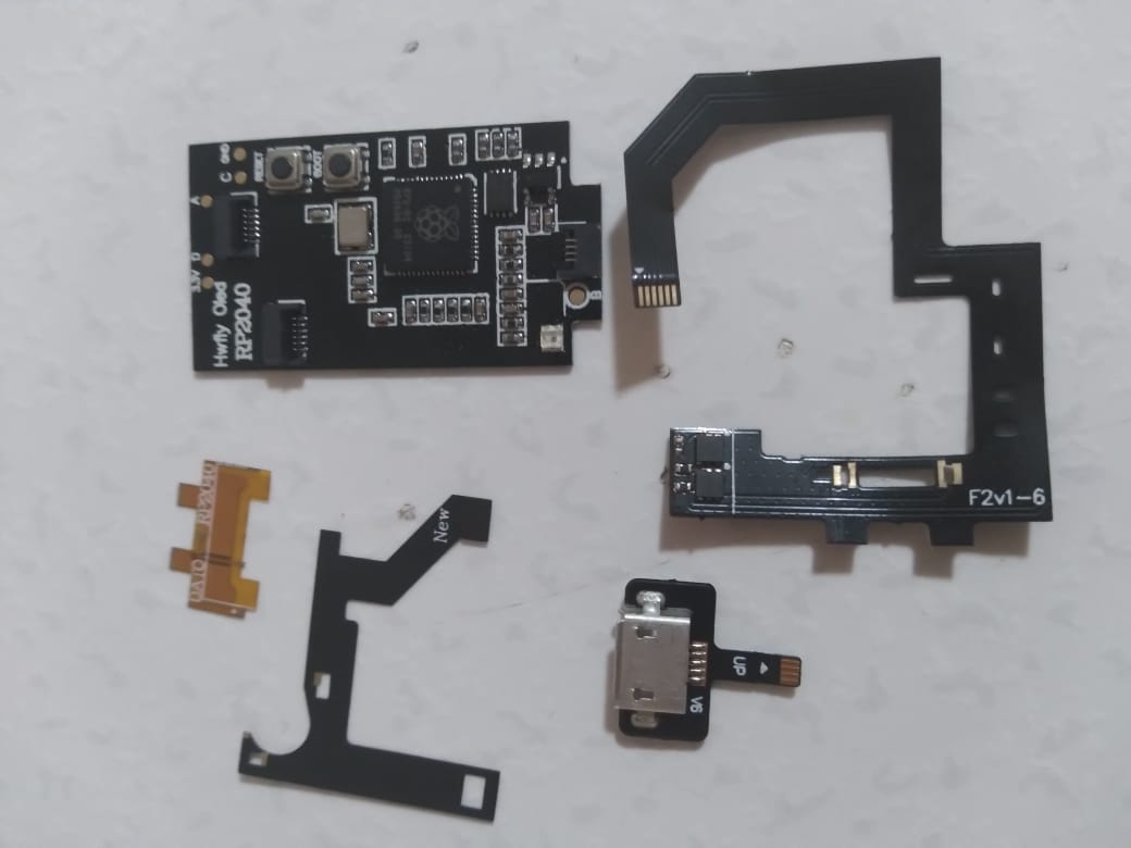

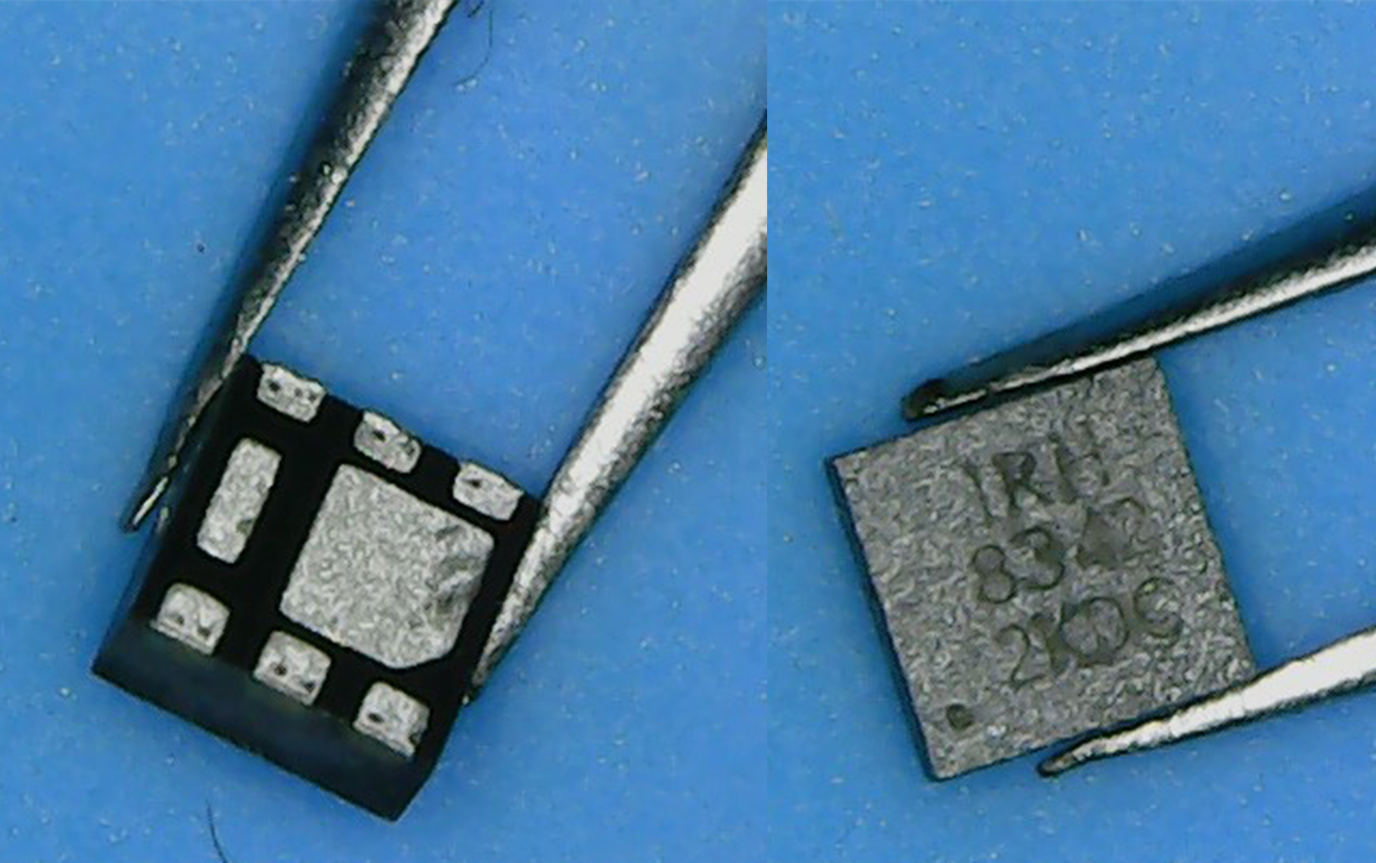

Hello everybody.
today the parts I bought from china to make the mod chip on my oled switch and 4 more customers arrived.
I already made hundreds of HWFLY and it will be my first PICOFLY.
I was confident with all the documentation I read and the solder work, but after reading some pages of the forum here I got a certain fear.
first and it would just do the job, but as soon as I installed the firmware on the 2040 I already had problems. when uploading the 2.72 firmware on the chip it flashed a "yellowish" light, maybe a green mixed with yellow?
I made the rgb mod and didn't get any difference.
after uploading firmware 2.67, the colors reacted as expected, red without mod and green with mod.
Was there any change in the leds in the new update? is it safe to use it? I saw it was posted yesterday, maybe it's too early?
I have 30awg colored cables for the APU mosfet, 3.3v and 0.1mm enameled copper cable for the others, would that be correct?
And then there's the big problem that I saw in some posts and that's what scared me the most.
I bought DAT0 adapters and they came with 3 anchor points. I put pictures, recommendation? I can't wait for other adapters, they would take almost 20 days to arrive.
I'm putting pictures of the mosfets and the DAT0 adapter:
View attachment 372512View attachment 372513
if u would the updates to the new firmware u would know the yellowish color is normal withthe new update.
yes safe to use
well u dont really need colored cables for the mosfet i would perfer 0.2 magnet wire since the soloring also adds to the thickniss and maght squezze wehen adding the Apu/ram shield.
0.1 for everythign else is correct .
well dat0 Adapters is a big discussion everybody swears on them but i always recommen take the emmc of reball and set a permanent dat0 Adapter.
and u will never have issues and thats the proper way to install then since dat0 adapters ar ein my eyes just a half ass job.
plus lot off cheap ones will give u issues over time but thats ur decision.
but since u make money of off them learn how to reball if u cant do it yet and do it the proper way :-)
