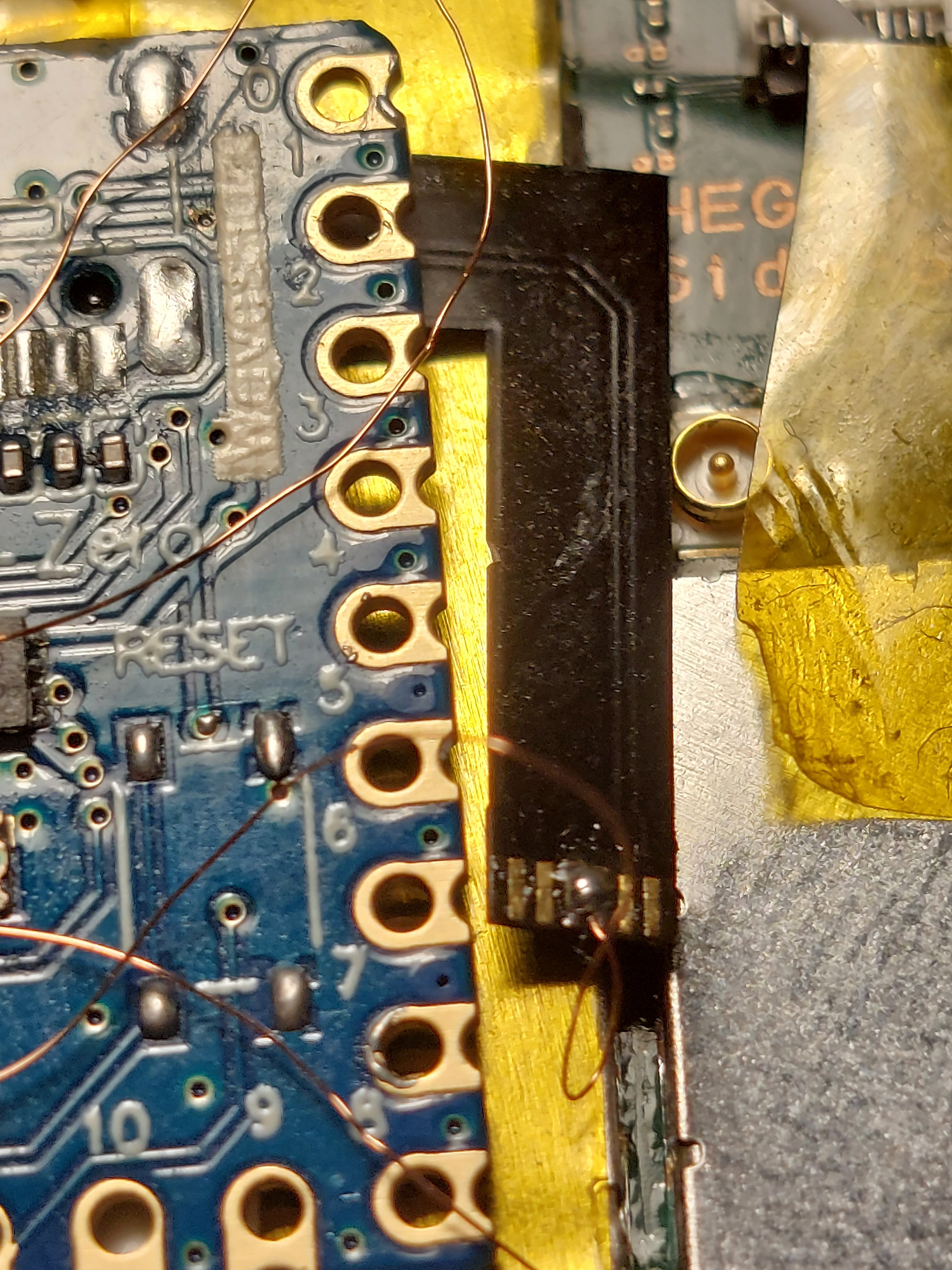

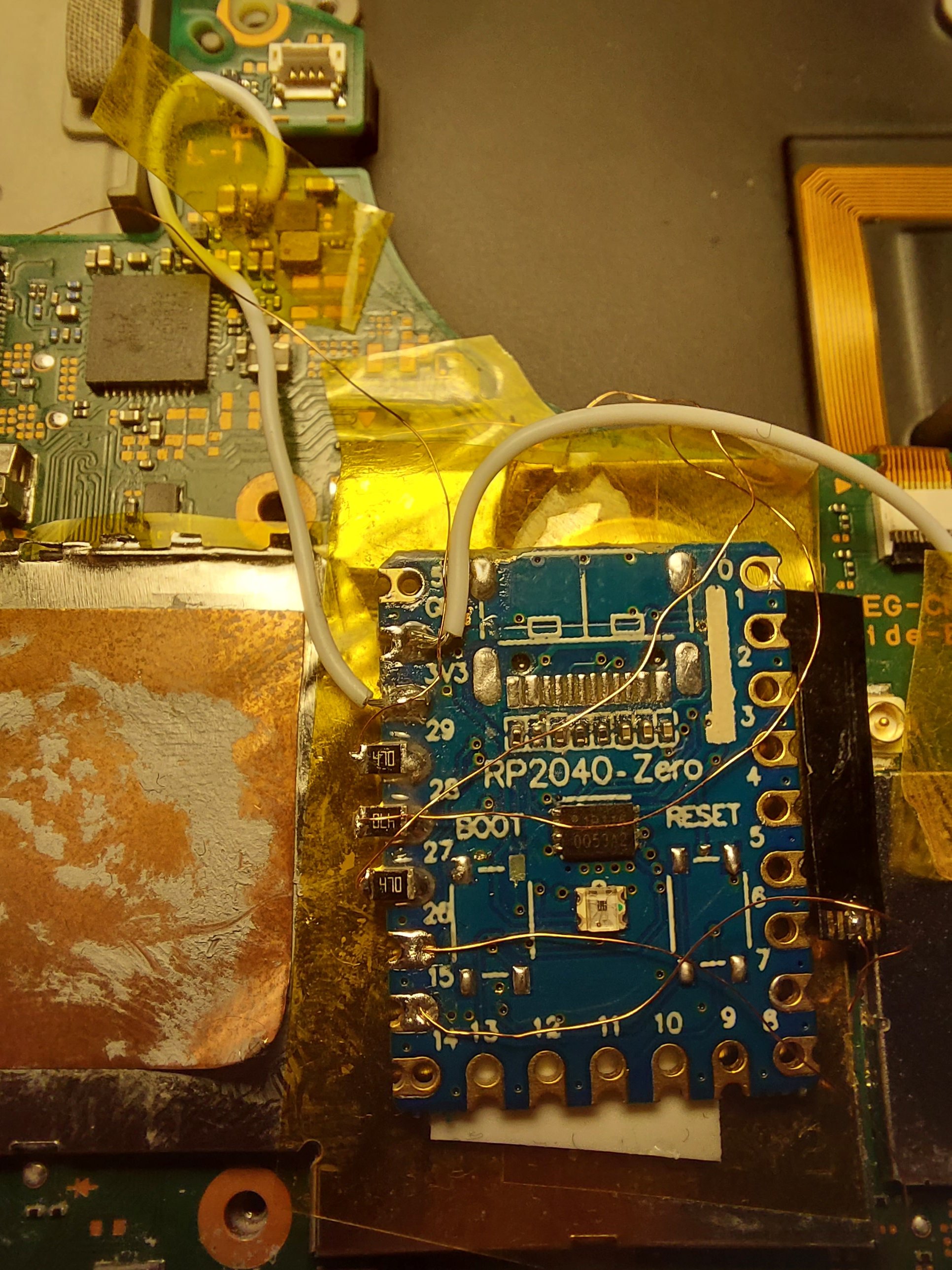

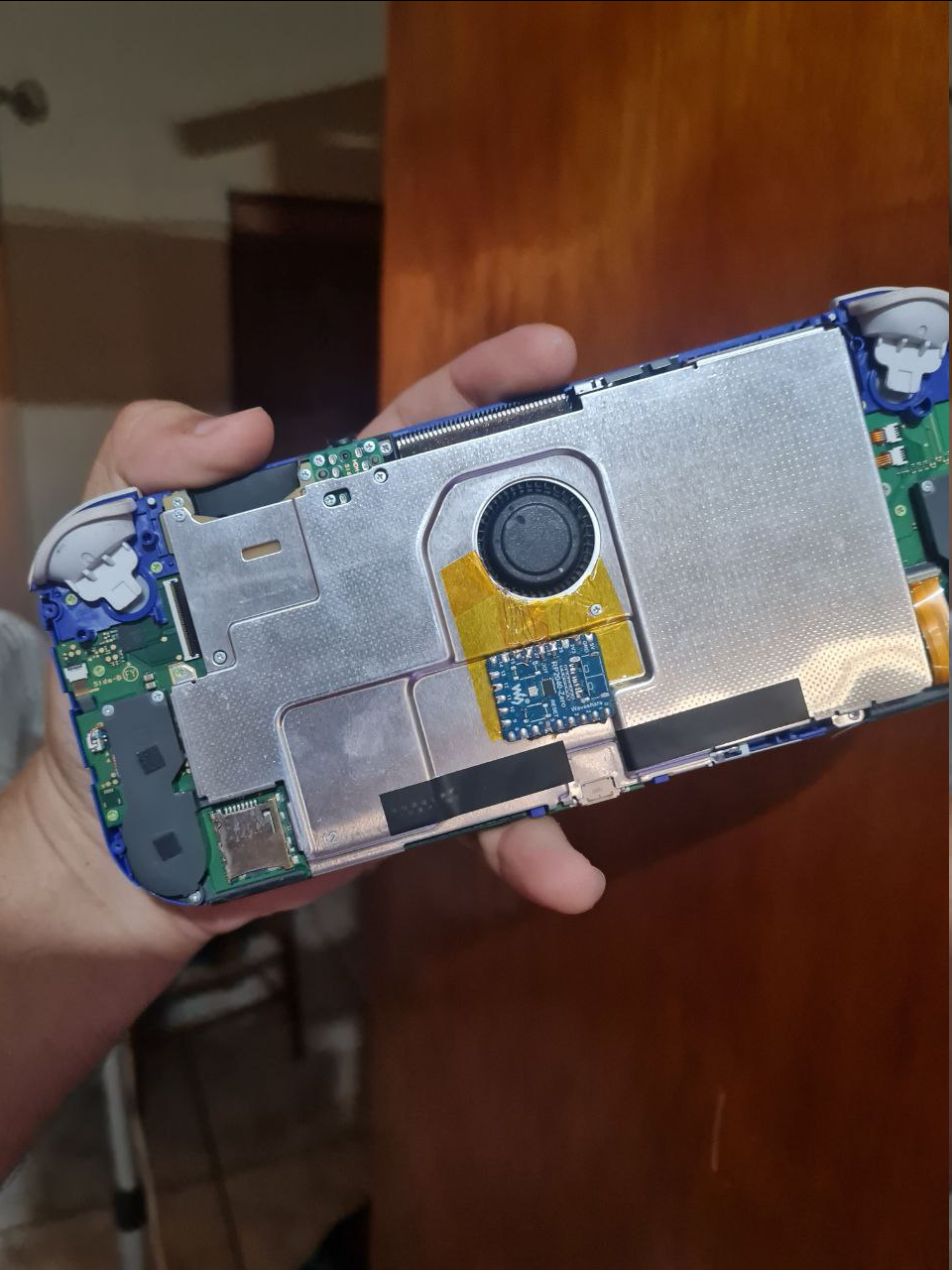

Hi everyone, i am installing on my lite, i just wonder why we put pico on top of mmc, it seem fit quite good, place it ontop of ram require cut the shield, and i want to keep it intact as much as posible. Anyone who put in on here can help me with the pinout closest with it? , Pinout on the pdf tut quite far from here. for eg, the 3.3v
ur white color is actually cyan check mosftes/flex cable and cpu cable

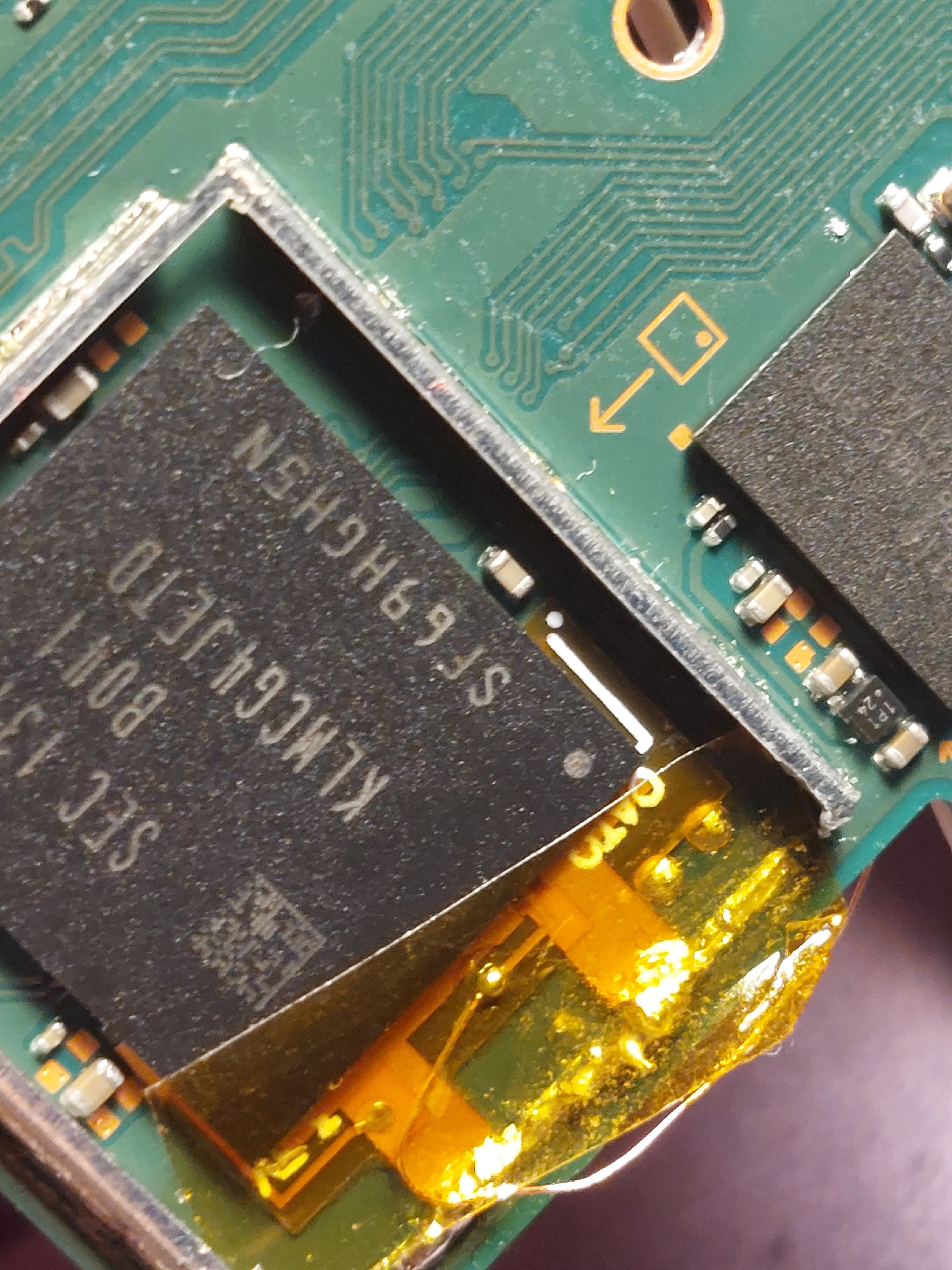

on the otherhand ur dat 0 adapter isnt set properly your supposed to align the white line with the emmc
edit : Why are u using a thicker wire for 3v ? there is no need just use ur 0.1mm like on ur other connections there is no need for thicker wire on 3v/gnd
Hi everyone, i am installing on my lite, i just wonder why we put pico on top of mmc, it seem fit quite good, place it ontop of ram require cut the shield, and i want to keep it intact as much as posible. Anyone who put in on here can help me with then pinout closest with it?
the pinout is still the same , u cant get alot closer to them.most of them are right infront of the rp2040
yep, most of them are close, but for gnd and 3.3v, I think there are plenty of pin that I could make a good routing, gnd is easy to get, but I can find 3.3, so if you have another point of 3.3v, please let me know
Does the wire the cpu cable need to be thick or it can be 0,1mm magnet wire?
0.1mm will not work the Cpu Mosfet but for mosfet gate 0.1mm will work fine. Use 0.2mm or 0.25mm or 0.3mm For the mosfet. For other points CLk, CMD, Dat0 and RST 0.1mm will be fine but using 0.2mm will also be fine.

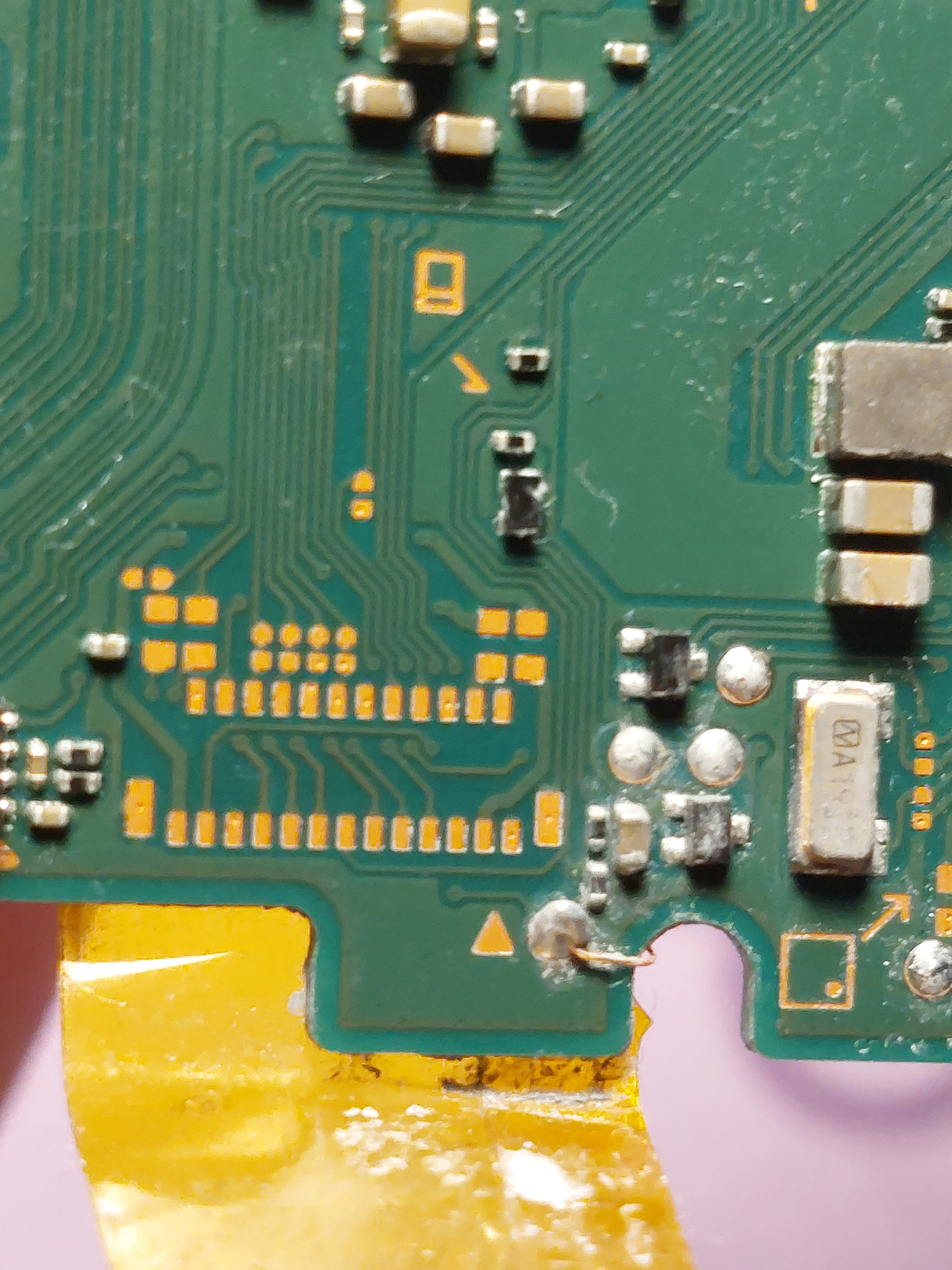

if you use DAT0 adapter, it could shift a little, shorting neighbour pins
probably you insert the flat cable in opposite direction, you can probe USB lines right to the rp2040 pins with multimeter to ensure the pinout is correct

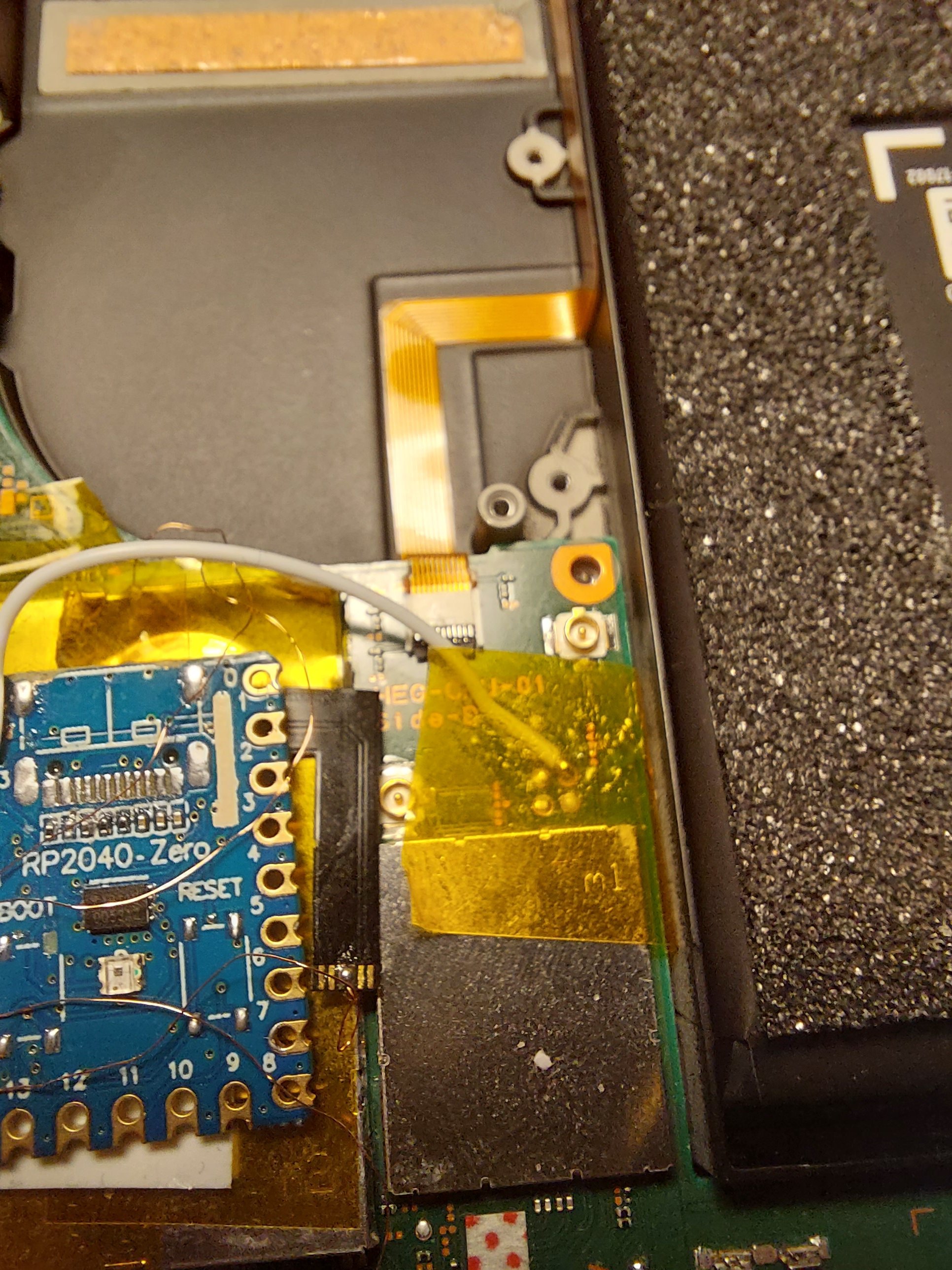

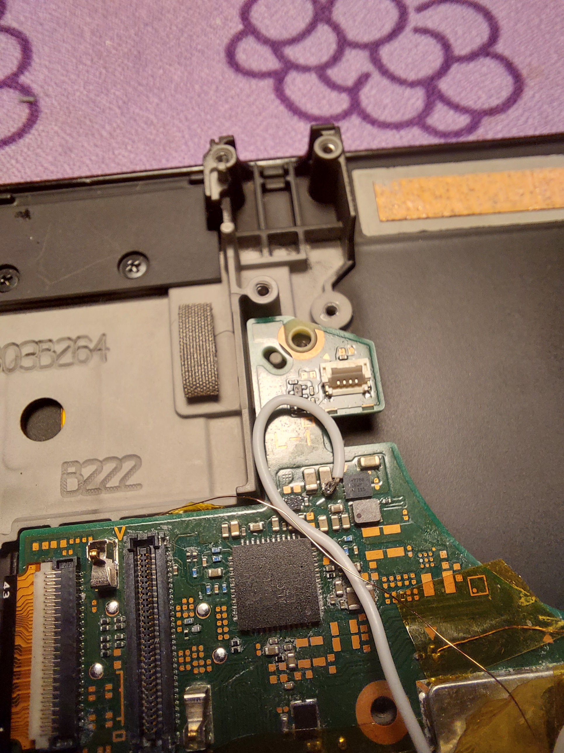

Just route it outside of the shield. That's what I do to all non-OLED models. like so:
Just be sure to leave the wires as short as you can to prevent any issues during the injection process, but by my experience it's never failed so far and I've done half a dozen Lites.
