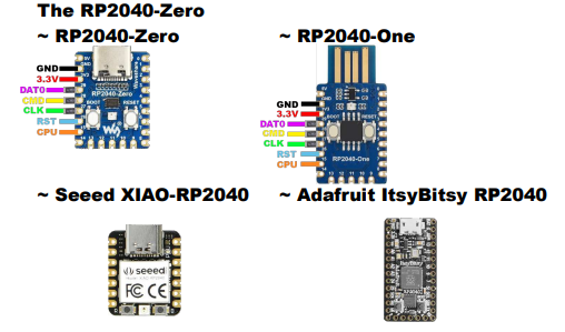

I don't think I seen anyone try installing rehius fw on Chinese hwfly rp2040 boards. As far as I understand, these models are using completely different closed-off firmware than the one posted in this thread. We do have guides for the non-hwfly boards, which what the rehius firmware in this thread is specifically written for, not hwfly boards.
https://gbatemp.net/download/a-definitive-picofly-install-guide.37968/
ohhh so,this chips are not rp2040?? but they say in the boads,and supliers say they use the same picofly firmware
See that square black chip in the middle of the board? It's an RP2040 System On a Chip. The diagram I sent you is a pinout of the pins coming off that chip.
yes i see the diagram you send me in the another post,hope can test the traces and also use the diagram,BUT then,they are or not picofly rp2040??
PicoFly is the Firmware, RP2040 is the actual Chip (you could order the chip by itself and make your own board)

Now if I'm totally lost, then which chip do I have? they say very clearly rp2040, but they also say hwfly, so? What can I do to know exactly how it should be installed and updated? The problem is that I don't want to install another one in an OLED without first updating the chip to the latest version. to try the tracks that you told me before but I don't think they all come with damage to the tracks, although well anything can happen, really a million thanks for the help, I don't know what to do, I have a brand new oled that died because of this chip
NOTE:Is there a way to test these chips with multimeters or other tools to see if they are safe to use?

My concern is "PicoFly firmware" could be referring to completely different firmwares, there's one we know existed since January. Another one is the one we currently using, released by rehius in March.

they say :the chips exactly the same as an rp2040, only a board is used to use the flex and the correct capacitors to make more plug and play so to speak, so the provider says that it is exactly the same as the hwfly installation, it is even the same factory, what he has not been able to tell me because I cannot update them
Try using Picotool and try saving the firmware of the chip. Then you can probably check with a hex edit if you see if it matches like the 2.5 or newer firmware.

His current issue is that he cannot get his computer to recognize the RP2040 over USB at all.
More confusion for you "picotool" is a computer utility to dump firmware from rp2040's.
