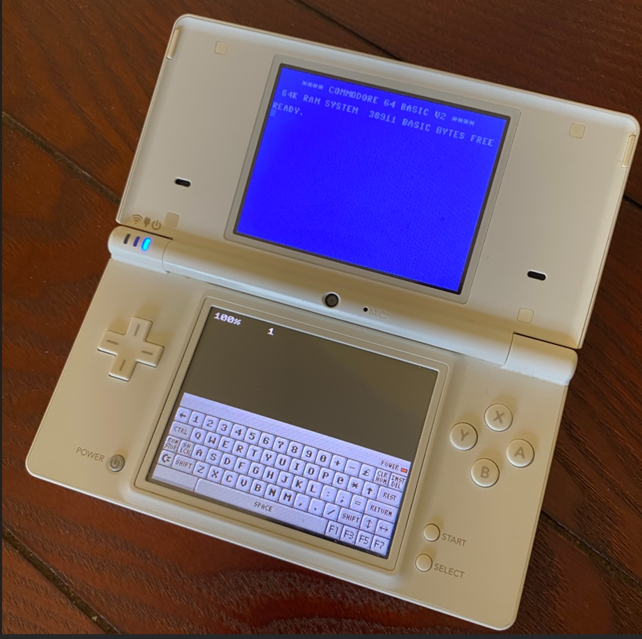

The first thing that I'm jettisoning is the 'tiny key' keyboard. I can't use that at my age... so I'll work on something.
This key layout isn't entirely correct yet... but I think it will be something like this:
That gives almost enough room for the required 56 keys of a C64 keyboard and provides for a status line between the keys and the logo.

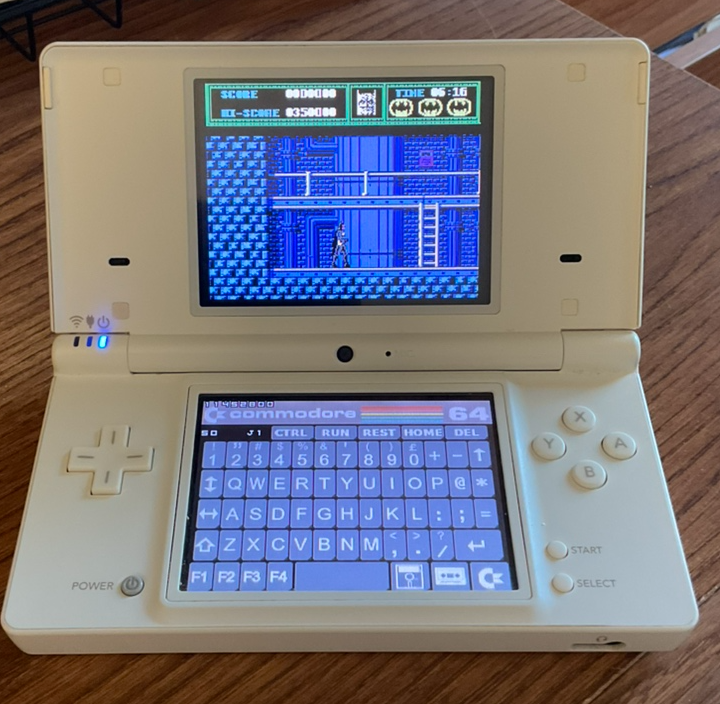

Okay... make some progress last night. A bit frustrating just coming to grips with the existing code base.
I added a proper frame/speed counter and improved the frame-to-frame timing.
I've also integrated a prototype version of the new keyboard - it's nowhere near final version.
I also enabled the more accurate emulation of CPU as I found almost 50% failure rate in loading up d64 disks... with the more accurate emulation, the load rate is well above 80% now. But it comes at a cost of speed.
I've also got some debug registers - and you'll see that in the upper left and that number is the number of bytes we're moving around in memory when the screen draws... yes, that number is 11 million and only represents like 10 seconds of gameplay.
And that's the crux of the current problem - we're moving so much memory around when the screen scrolls that it's killing the emulation speed. And when the frame rate varies with scrolling, that also has a deterimental effect on the SID music chip output (even when running at full speed it's only passible sound... but it gets much worse when the emulator gets hammered with memory moves).
So next step is to figure out how to speed up (or partially eliminate) those memory moves and see if I can't get it all running at 100%.
More progress...
Speed is just about 100% for the DSi and above... the DS-Lite/Phat will have to wait.
Border colors are now mapped to the lower screen.
New joystick icons that let you toggle between Joystick Port1 and Port2.
I bumped up the sound fidelity for the SID chip so it's starting to sound pretty nice. Not perfect but better than anything I've heard out of any previous FrodoDS version.

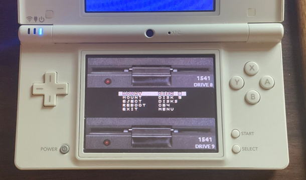

Next up is the disk menu to allow mounting of Drive 8 and Drive 9.

Okay... more improvements today - true drive emulation is now working and is about 50% faster than any previous version of FrodoDS. This should allow more games to run properly.
I've also fixed the keyboard handler - in some games (especially pre-game Trainer/Cheats/Cracks menus), the keys were not very responsive. But this should be quite solid now.
Need to add back in Save States and some per-game configuration settings and I think it might be available in a week or so for a semi-public beta release.
