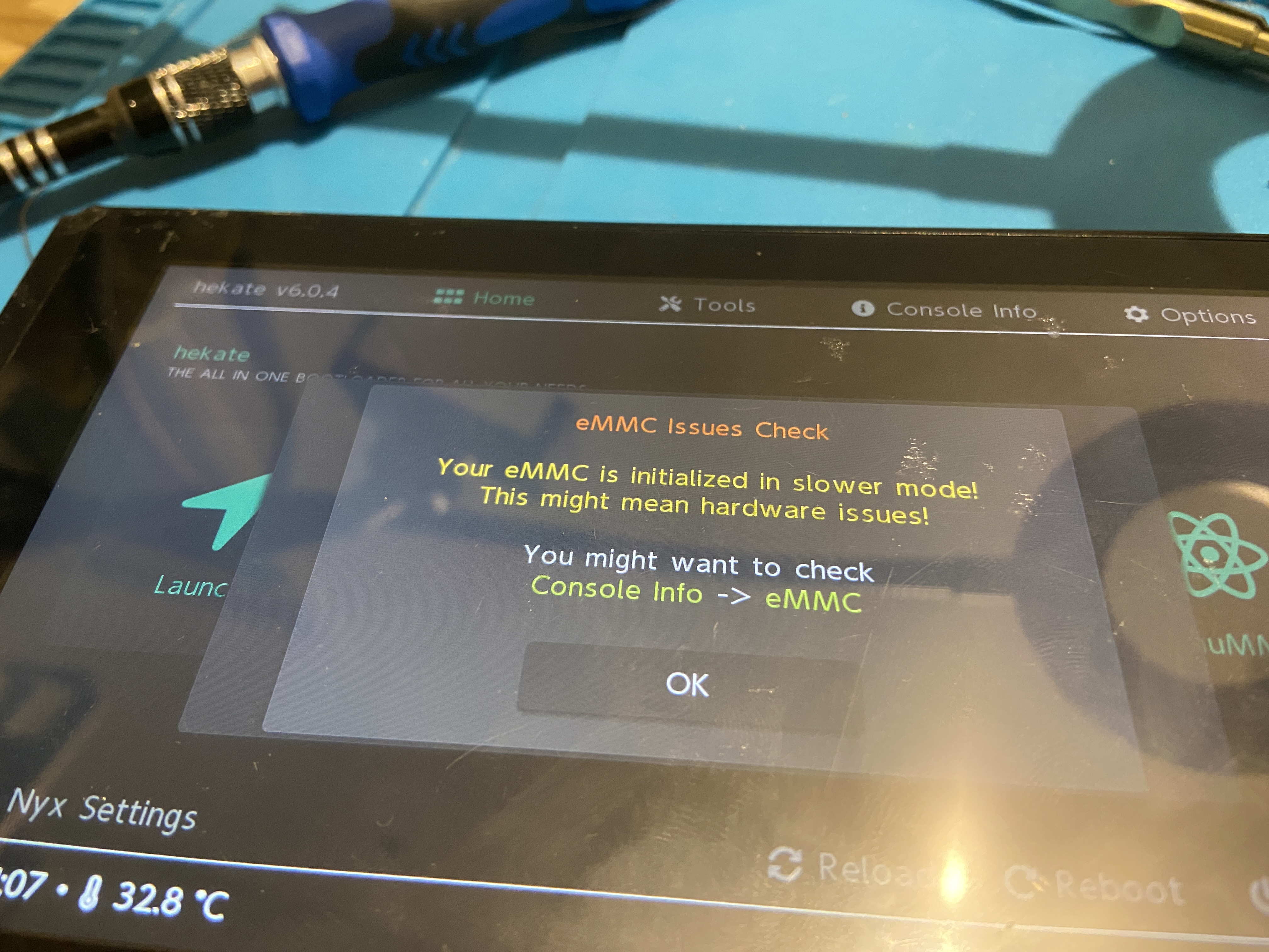

Thank you guys. Got it to work. But what does this message mean?
