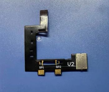

Does anyone know of any cpu cables that will be used instead of MOSFET?
I saw that the V2 cable is used in OLED and LITE versions. By the way, Mariko used V1 cable. Can't I use V2 cable in mariko?
Conversely, is V1 cable not available in OLED and LITE versions?
And V3 cable seems to be compatible in all versions, but the store doesn't sell it..

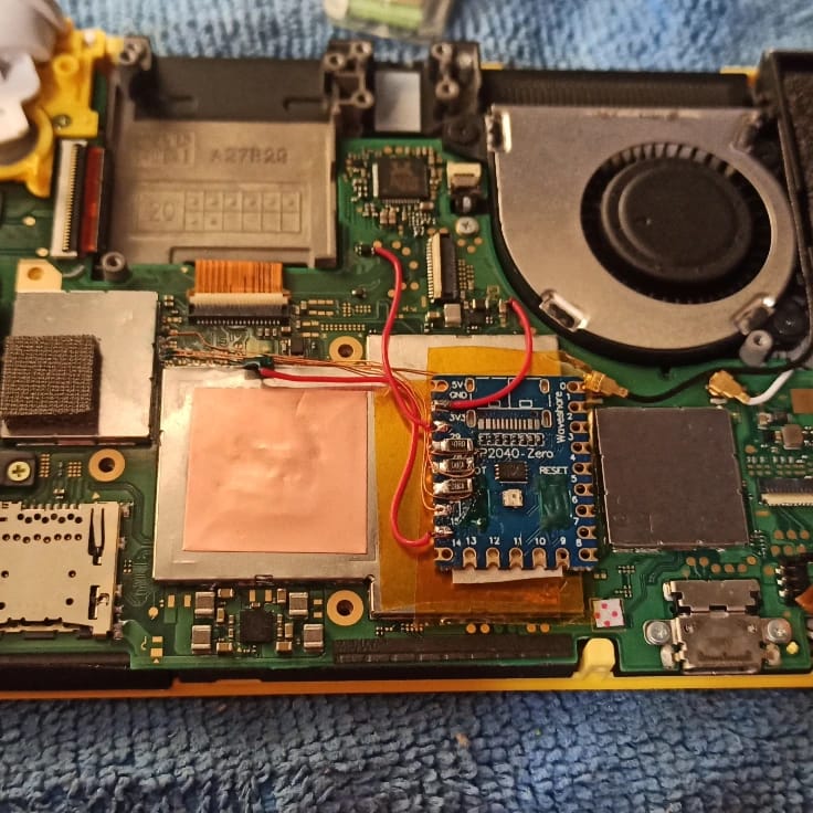

GOT one TOSHIBA switch lite by hand, 47 ohm single MOSFET didnt make it.
BLUE-> PINK then OFW boot.
Tried double CMD, CLK,DAT0 to 2x47 ohm still same.
Tried 2.64 and 2.65, no success. I think I need to digging up some old info

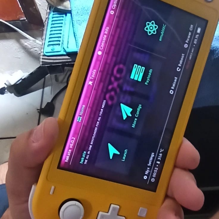

Done the first PicoFly.

just did dual mosfet. V2.65_I and v2.65 both tried w/ 47 ohm resistor, still blue->pink-> OFW
I noticed if you add 2x 47 ohm on all cmd, clk, dat0 lines, I have 3s glitching time, slightly longer than 47 ohm setup. But still, no luck.

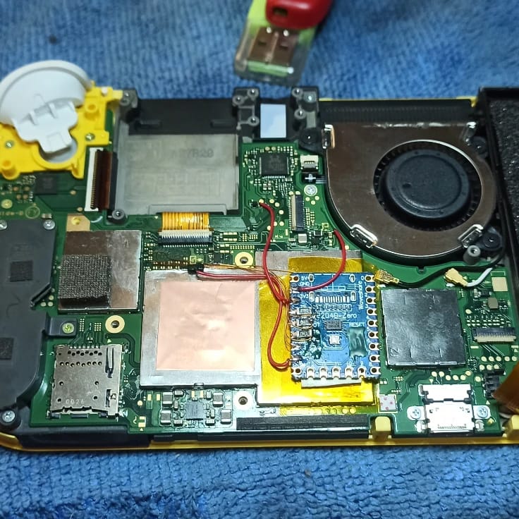

Is anyone going the mosfet route finding they don't work on SKHynix emmcs? Both dual and single mosfets?
But the flex works fine?
I just got the same behavior on V2 switch Mariko and switch lite where there is a blue light followed by green and the boot screen is OFW. The blue light does not pulse followed by a green light. It switches from Blue to green instantly. Both were SkHynix switches.
The first switch lite tried, don't know what the emmc brand was, but it worked the mosfet route.
However the flex cable works fine with the SKHynix emmc.

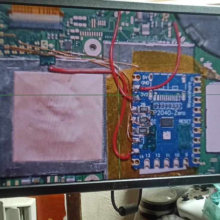

My lite is a Toshiba and it runs fine with FW2.65.
I use rp2040-zero and all smd resistors are 47 ohms.
The wiring could not be made this short and clean.
Try using rp2040-zero and lengthening the emmc related wires.

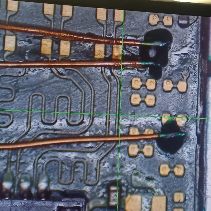

I've replicated my mistake. I think my mistake was scratching through the square pad on the cpu that is an alternative point for source on the mosfet. damn. Both units bluescreened. Crazy thing is that picofly boots.
I think that the problem is in the bad soldering of the cable. So do as I do, unsolder the transistors and connect as in my drawings and everything will work. Good luck!
It is necessary, in the multimeter diode mode, to check the connection between points D and S, then touch the red "+" to point G, and black "-" to point D. And check that the values between D and S should change. Then we reset the transistor (we run something iron through it to close all the contacts) and check points D and S again, if the value has changed again, then the MOSFET is working. We do everything in Diode mode.
