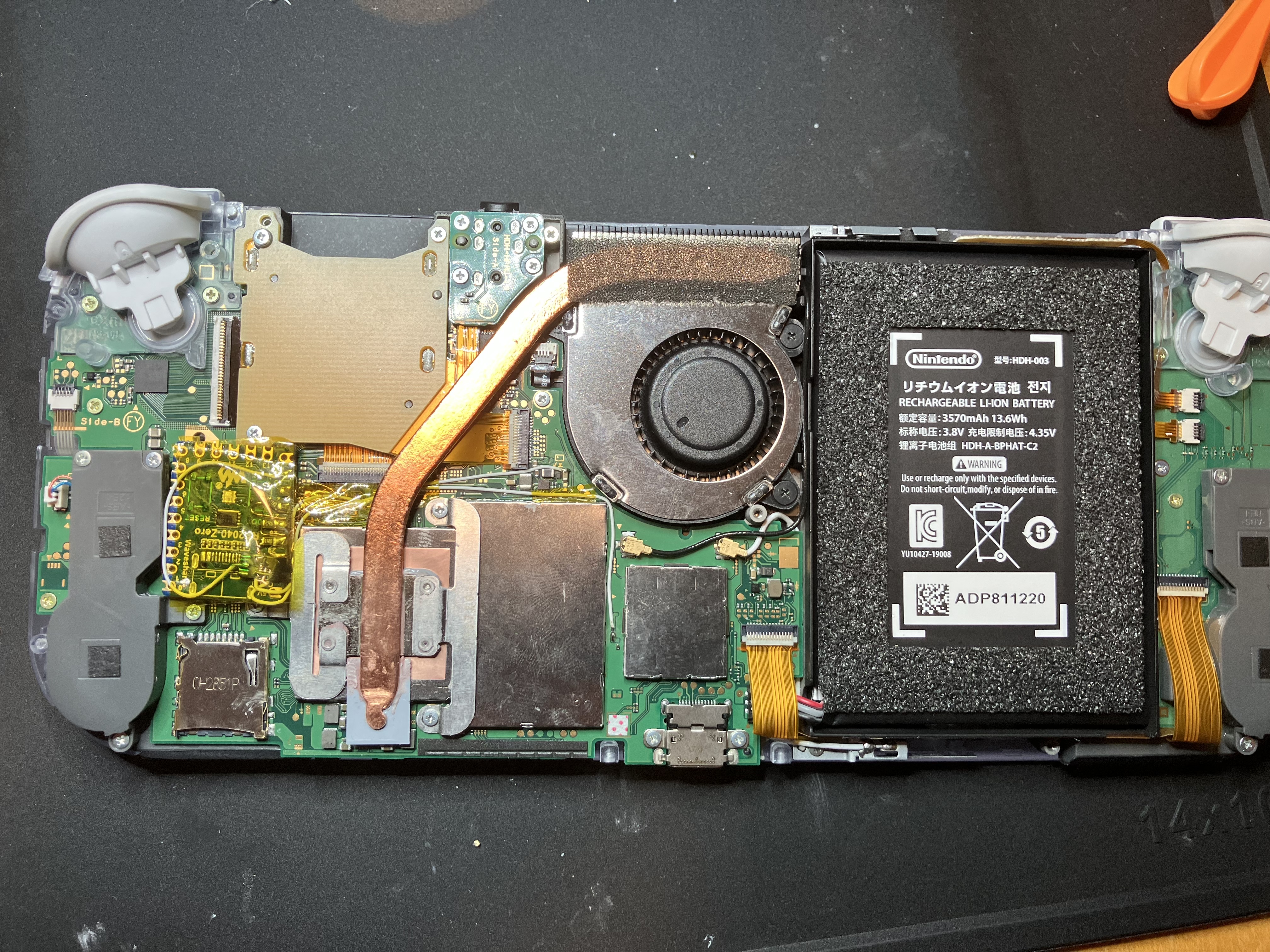

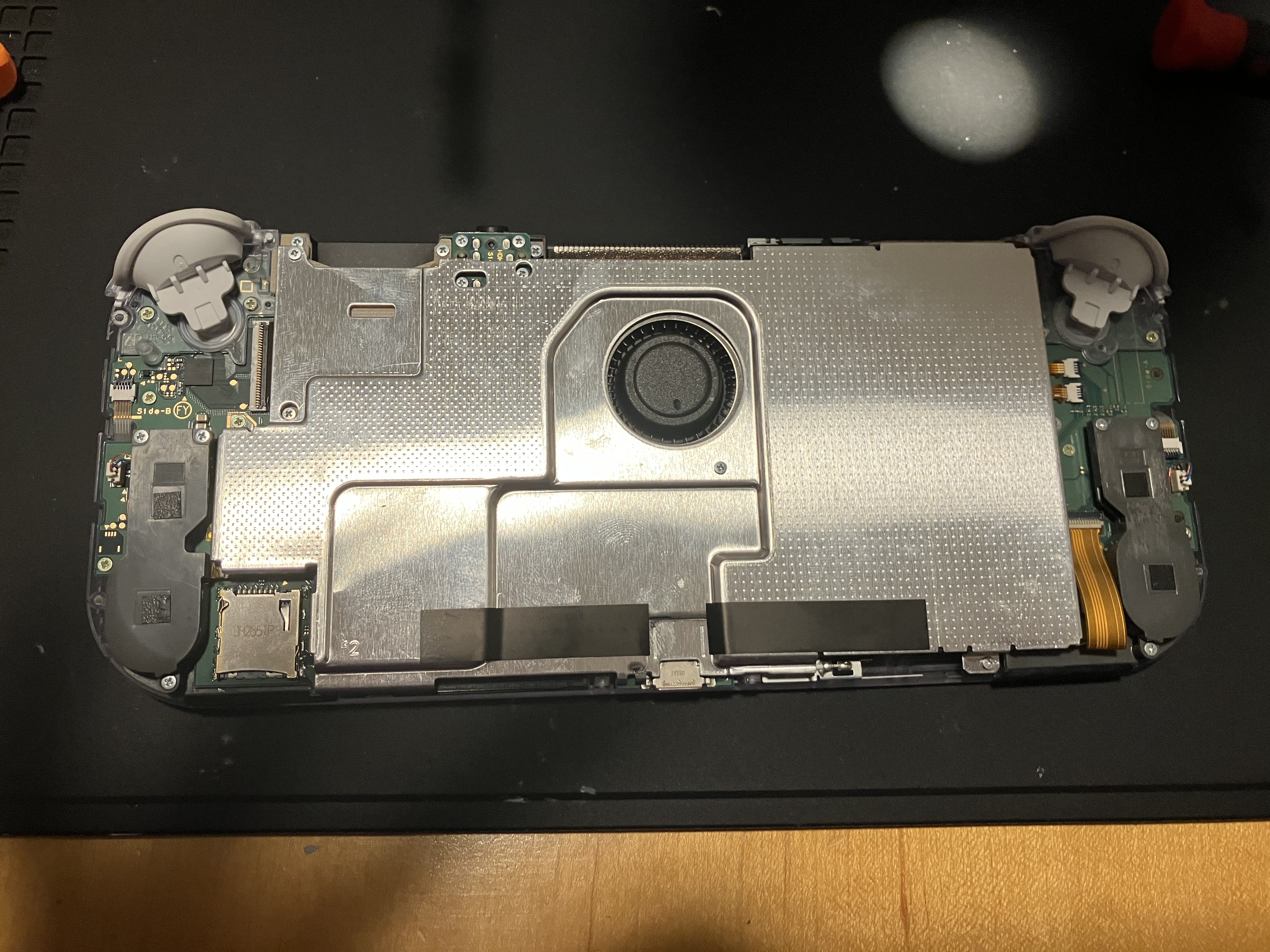

Issue: I turned on my lite a few times being able to boot into Hekate PL, but now when I press power nothing happens. I take the back cover off, the shield off press the power, nothing. I press power again and the rp2040 goes blue-to-green, and then boots into hekate pl.
I put the shield back on, try again, and it boots into hekate pl. I put the back cover and press power and nothing happens.
It’s probably the pressure being put on the wires on the rp2040 I assume. But if I get no lights, does that mean the cpu wire is shorting somewhere?
