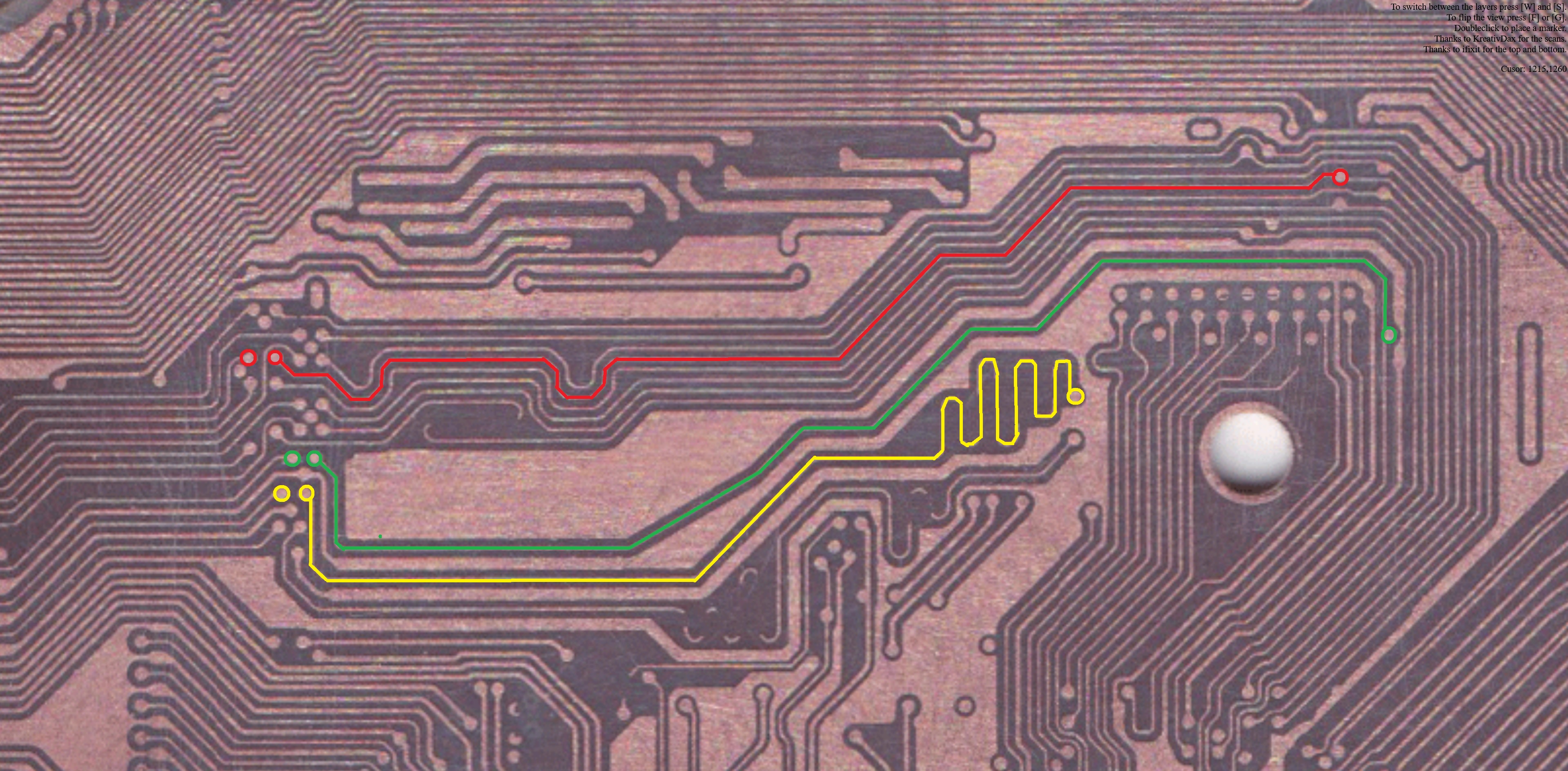

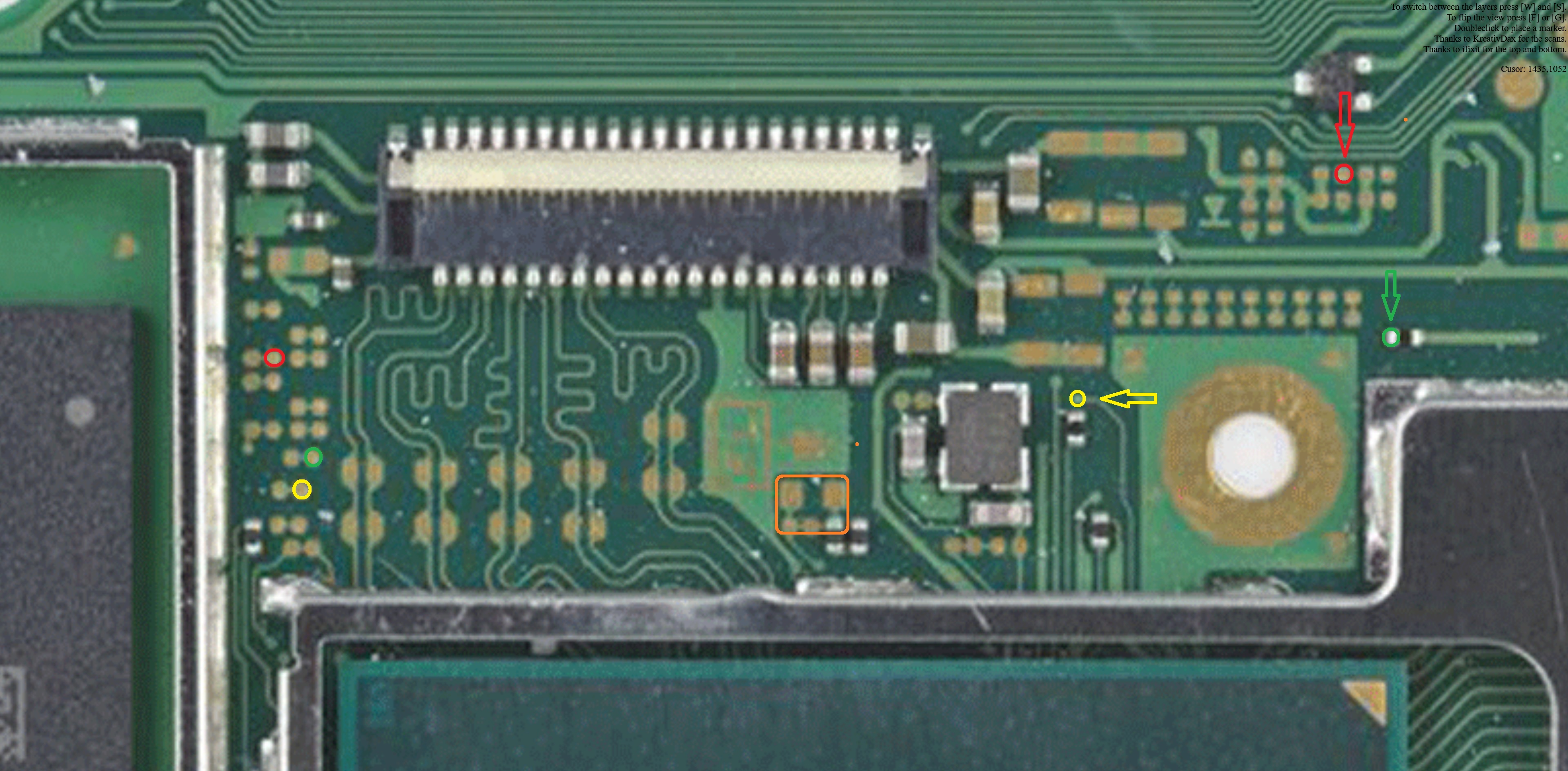

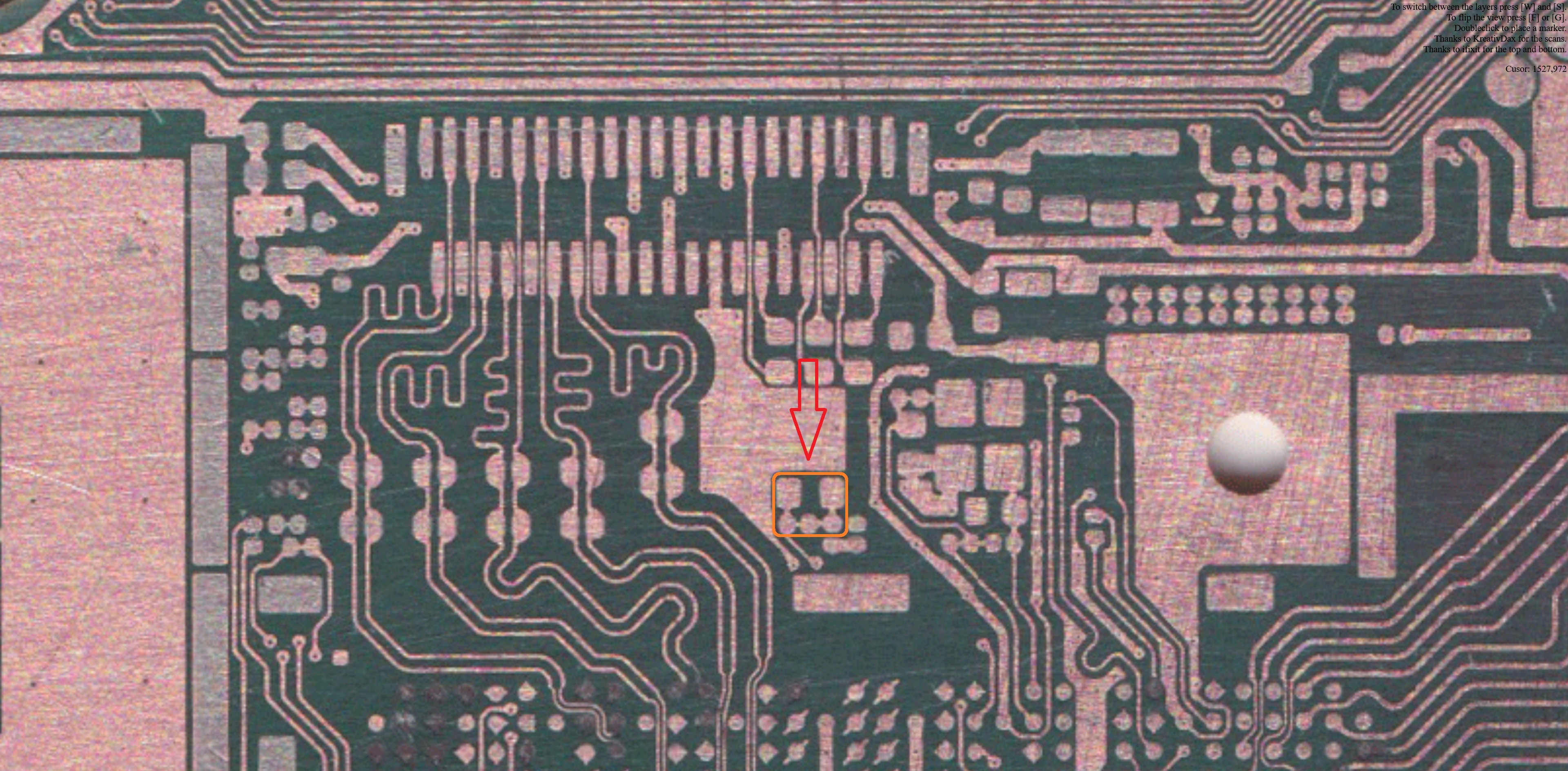

...Alternate Solder Points for DAT0, CMD, CLK, RST ...(??????????) on Switch Lite
For Confirmation....
from http://balika011.hu/switch/lite/
Soo i can use v2 flex cabel on oled? Do I need to solder both points?

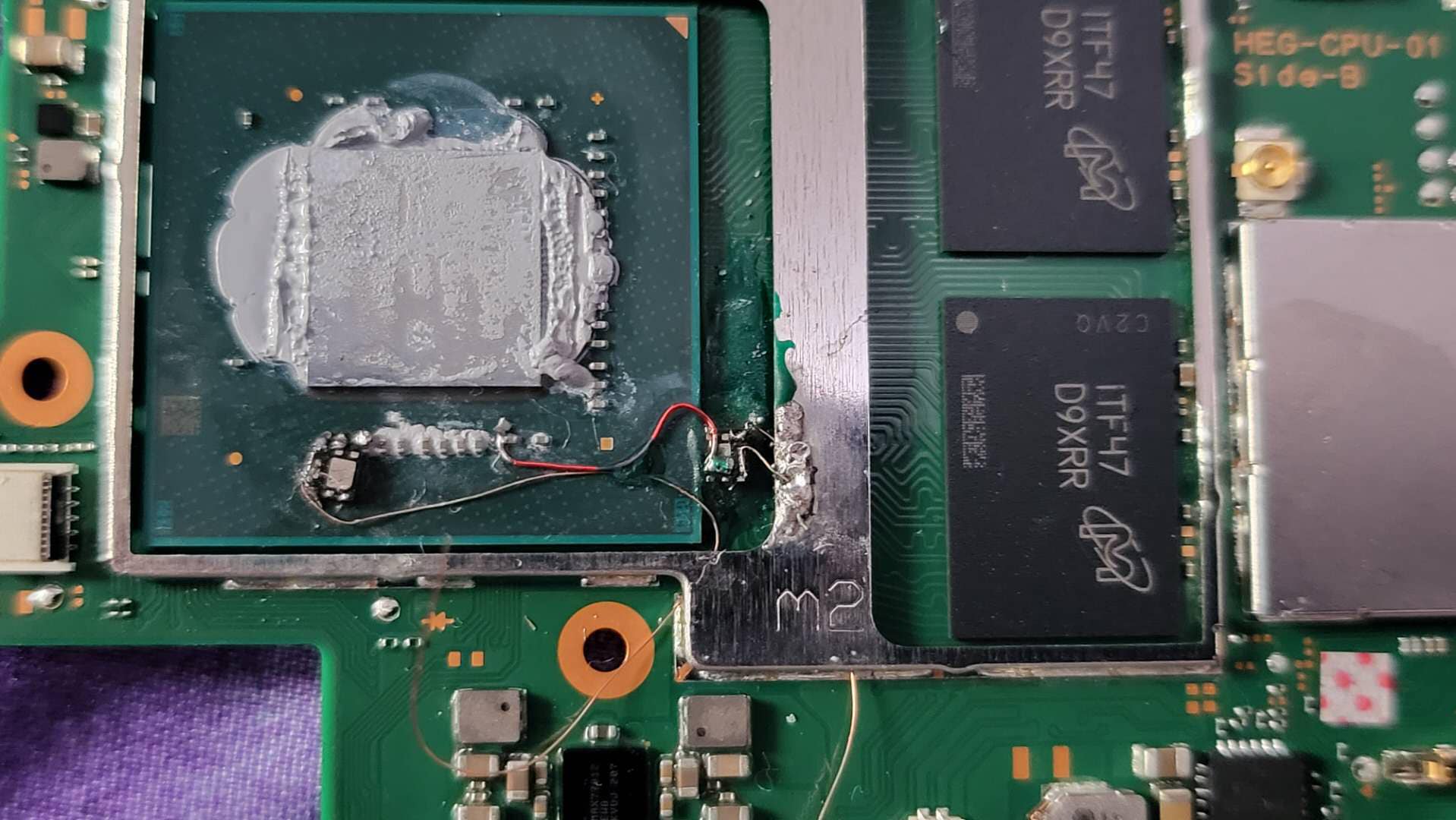

Hello. What color should I get if successfully glitched with a Raspberry Pi Pico? Should it just blink green?
No color. Before that is Green blink and then the LED goes off.

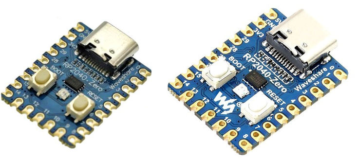

What LED color are you getting? Did you check if you need to short the RGB jumper on the RP2040? (if you get RED when writing FW to the RP2040, you get the correct LED color for troubnleshooting, otherwise, short the jumpers).

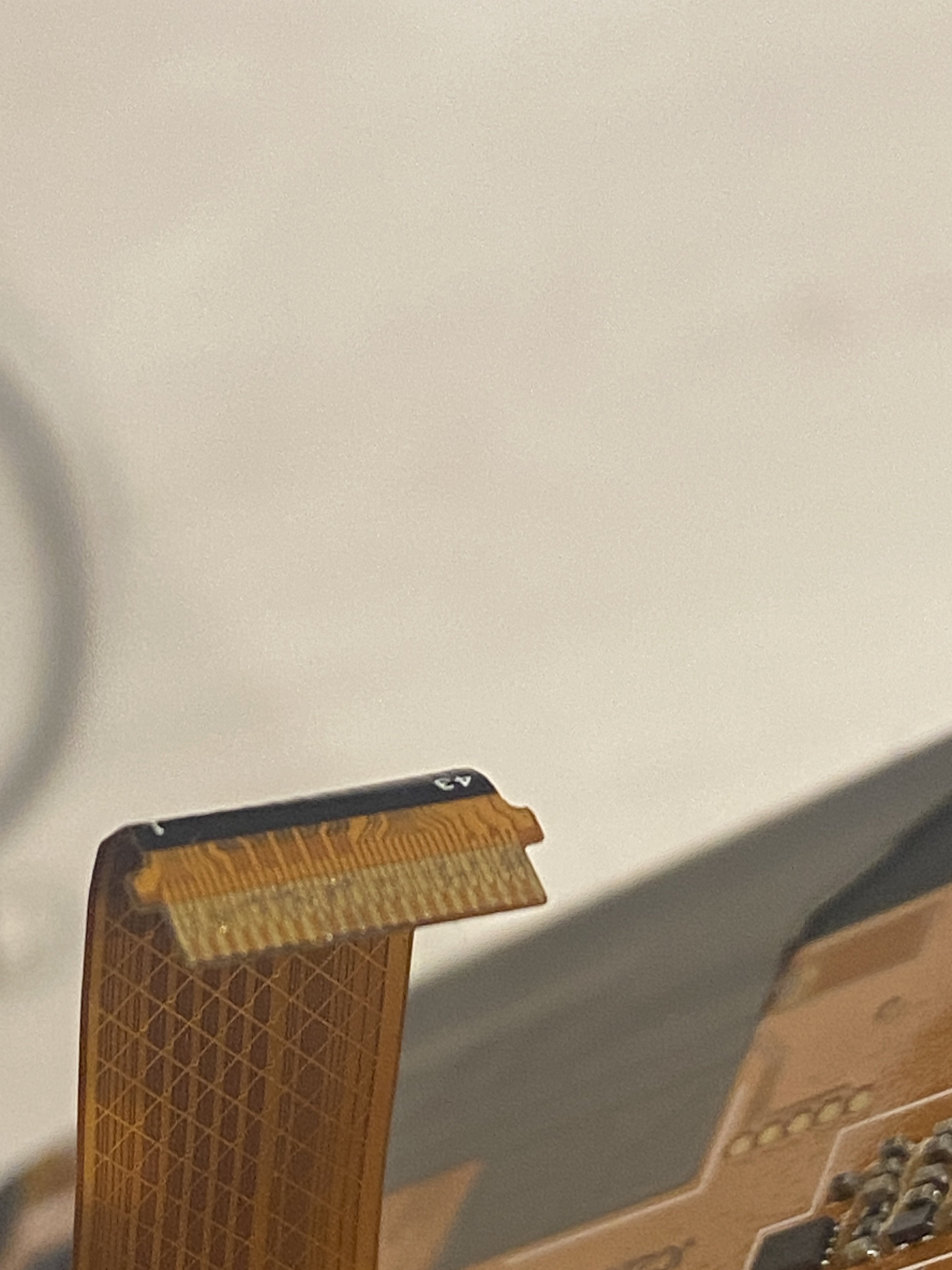

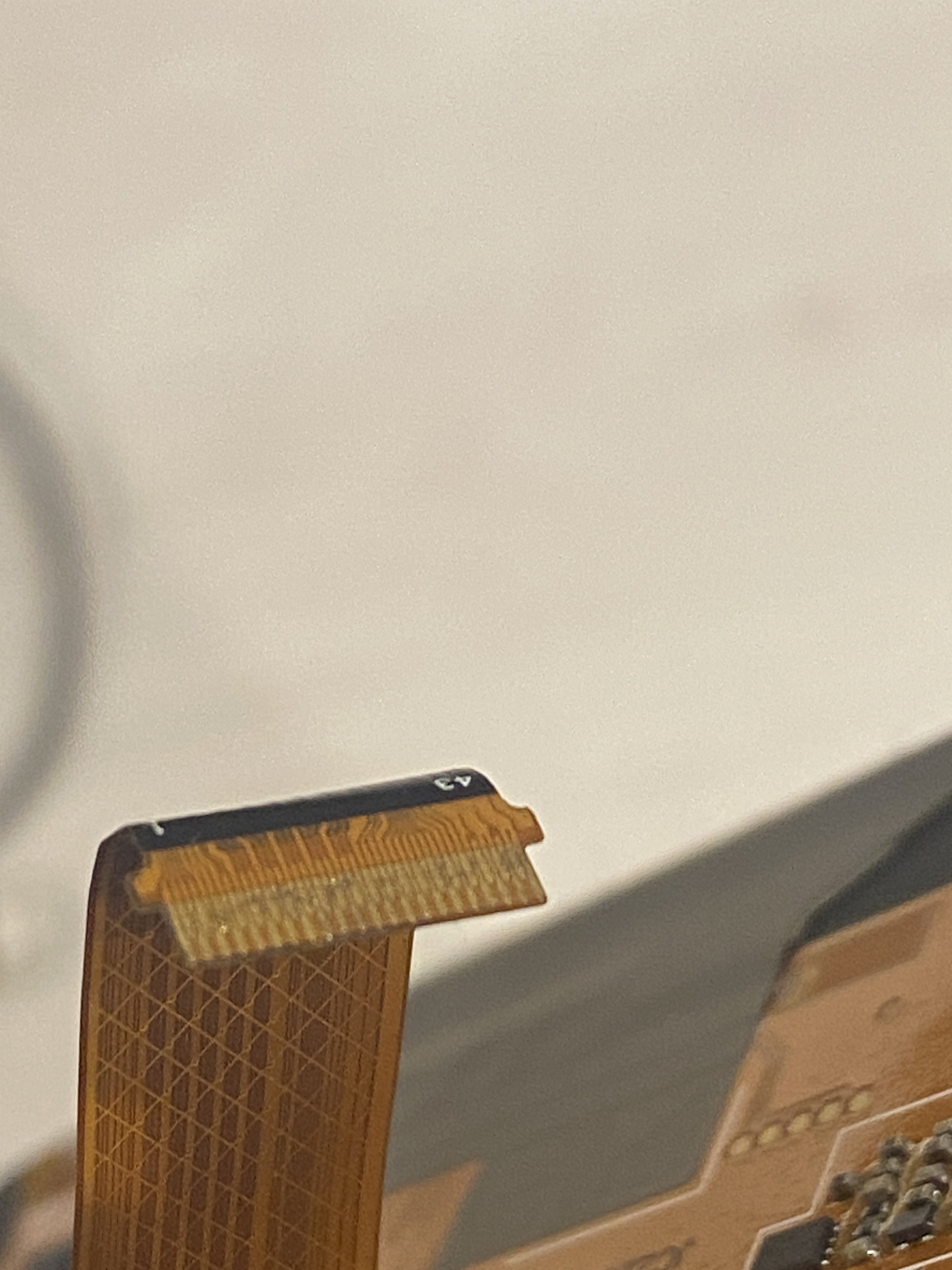

Hello. Thanks for replying. I do RGB jumpers on all of my rp2040s and get a good red color. I decided to try an RP pico and like you said, green then nothing as I understood the RR pico does not have RGB modification.
I'm 99% sure it glitched successfully, but it's so frustrating to know that I scratched the OLED's screen ribbon cable so much while removing it and I think I've damaged it. This was confirmed when I removed the pico and turned on the device, black screen but I'm getting sounds and joy-con vibrations.
Did the tough part and screwed up on the easy one. I ordered another screen and will see how it goes.
What happens if you put the Switch in the dock? Do you have TV output?
Did you check the FPC screen connector on the board? maybe the problem is not on the Flex, but some twisted pin on the board.
Never thought of that. Thanks. Yes, it does work when I place it on the dock. I inspected the pins, seem fine to me. I hope it is,the screen should be on the way.
