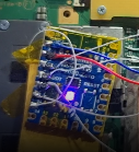

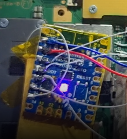

hello all, first I want to thank @rehius for his dedication, and the community for all their tips an tricks, after doing my research I went and performed the install, and the first time it glitched fine, but when I went to put everything back together some wires got ripped off the board. after reconnecting everything the switch now wont boot anymore.
I Beeped out all the connection and they came out all ok. does anybody have a idea what went wrong?

According to the definitive guide, this color indicates that you have an issue with your CLK line. You have either ripped your wire loose and the trace is still in tact (the console would boot normally) or you have ripped a trace somewhere else, and your console is not powering on at all, and therefor errors out on the CLK line.

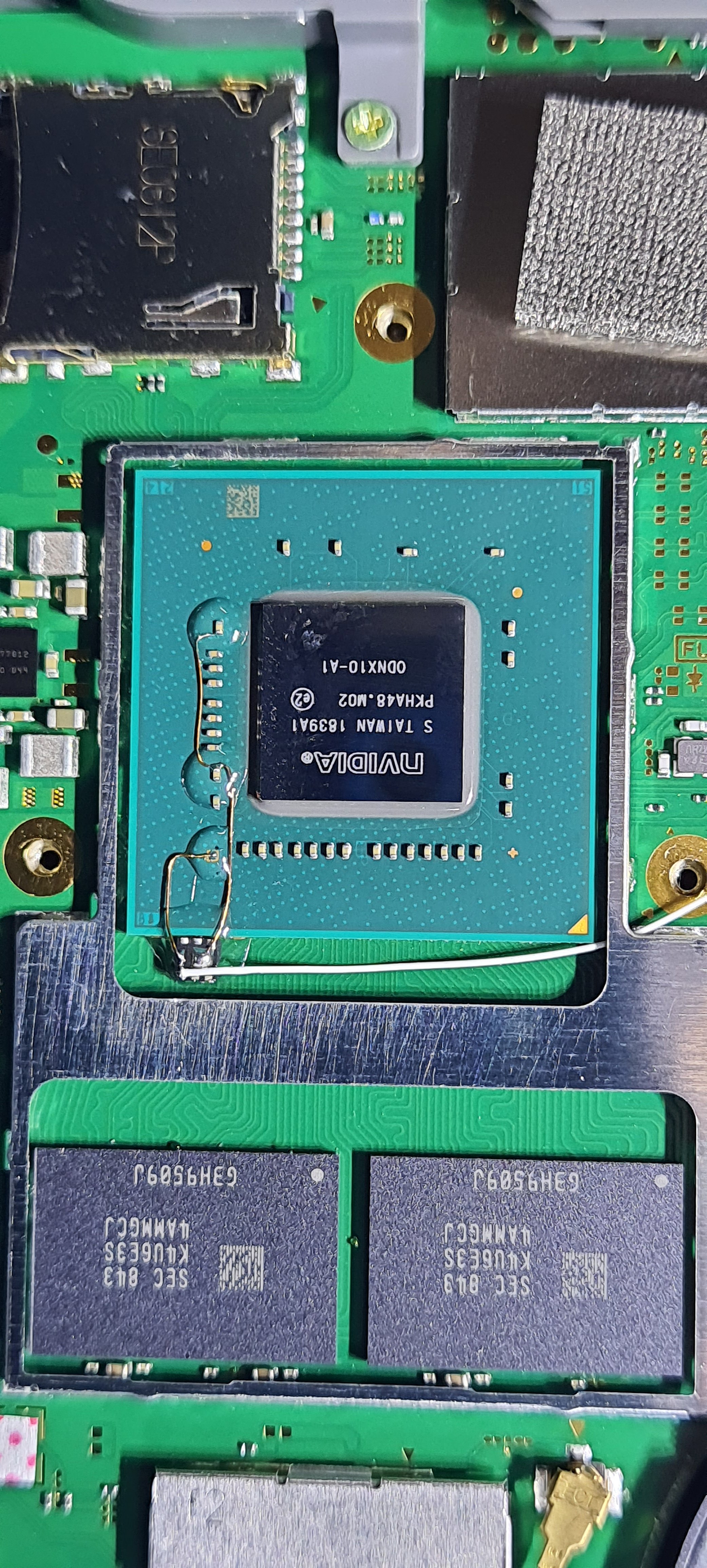

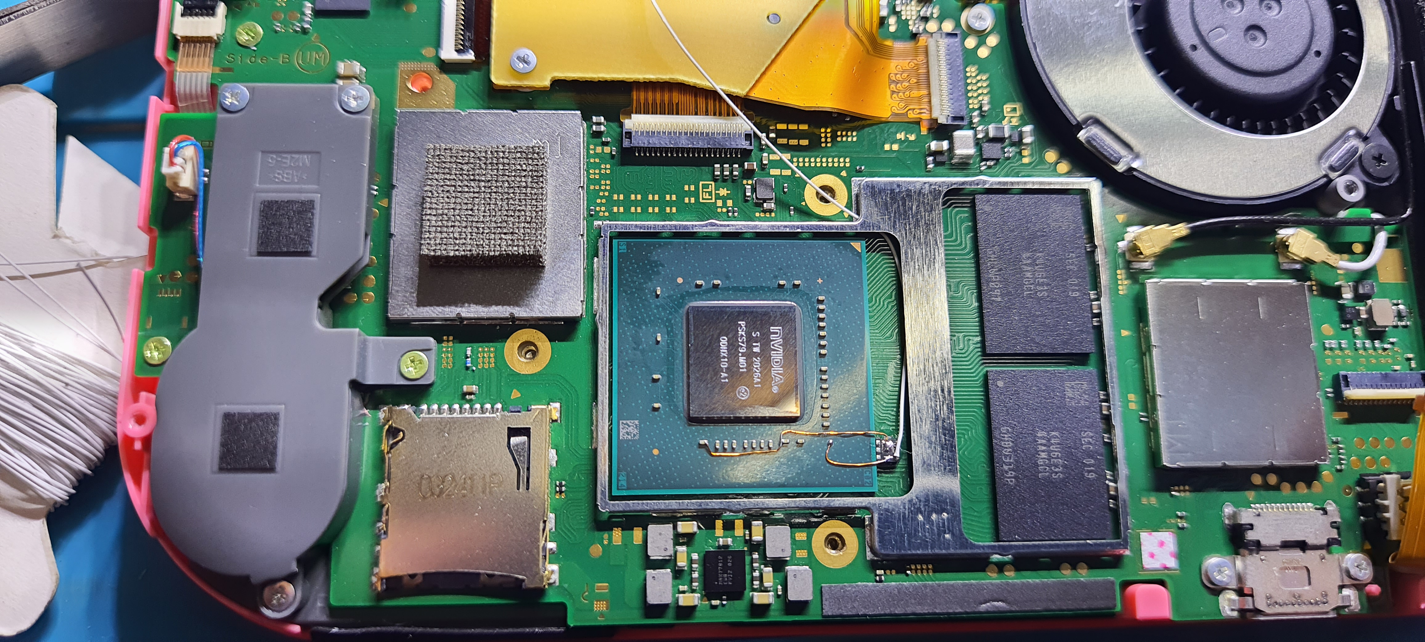

unfortunately one of the cmd pads got ripped:(. any idea how to fix this?
Is the console still booting, or no? If no, then you need to clean the area well with alcohol, then see if you can still see any shiny spots in the area you ripped. If there's still shiny and it's not connected to the other pad, then you likely experience issues turning on the console.
Bridge the pad to any exposed metal that is left of the trace, and try to reattach your wire, but then, like Dee said, UV-CURE IT DOWN
