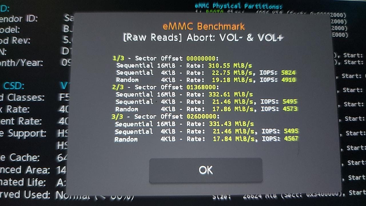

lite. It can start IPL, hecate, but emmc cannot be read (with slow error) and cannot start CFW and OFW. Is this the same problem?
No. "slow eMMC mode" = eMMC lines interference.
might be caused by not cleaned flux, bad soldering, lack of resistors, too long wires
there is a small range that works
47ohm - 51 ohm shouldn't have any issues
I see many people with slow emmc when this happens, you can put 2 Dat0 470+470 = 94 ohms that doesn't even give a problem solves slow emmc
