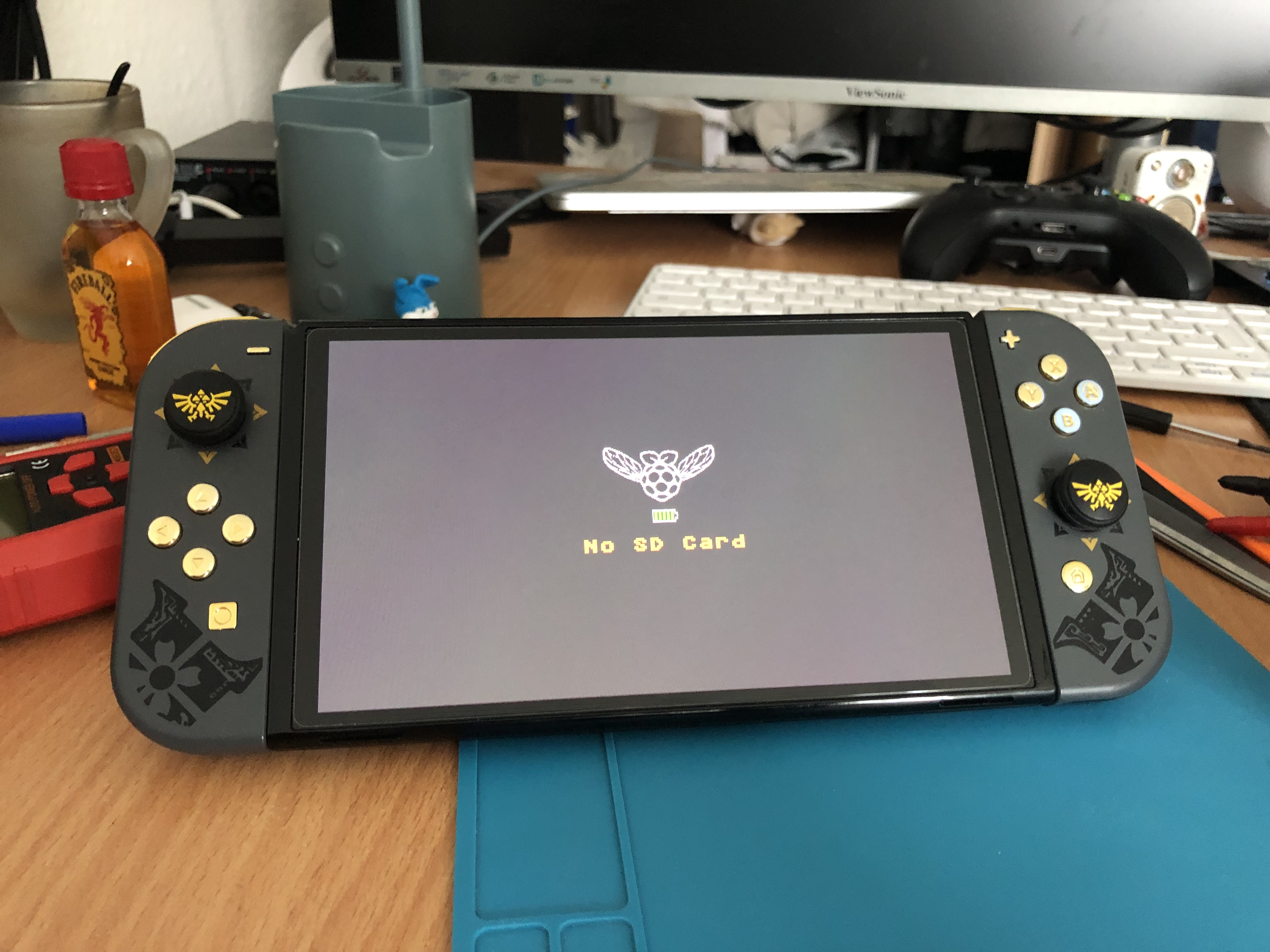

...mine doesnt even go to "no SD" / hecate screen...

...It works now :)

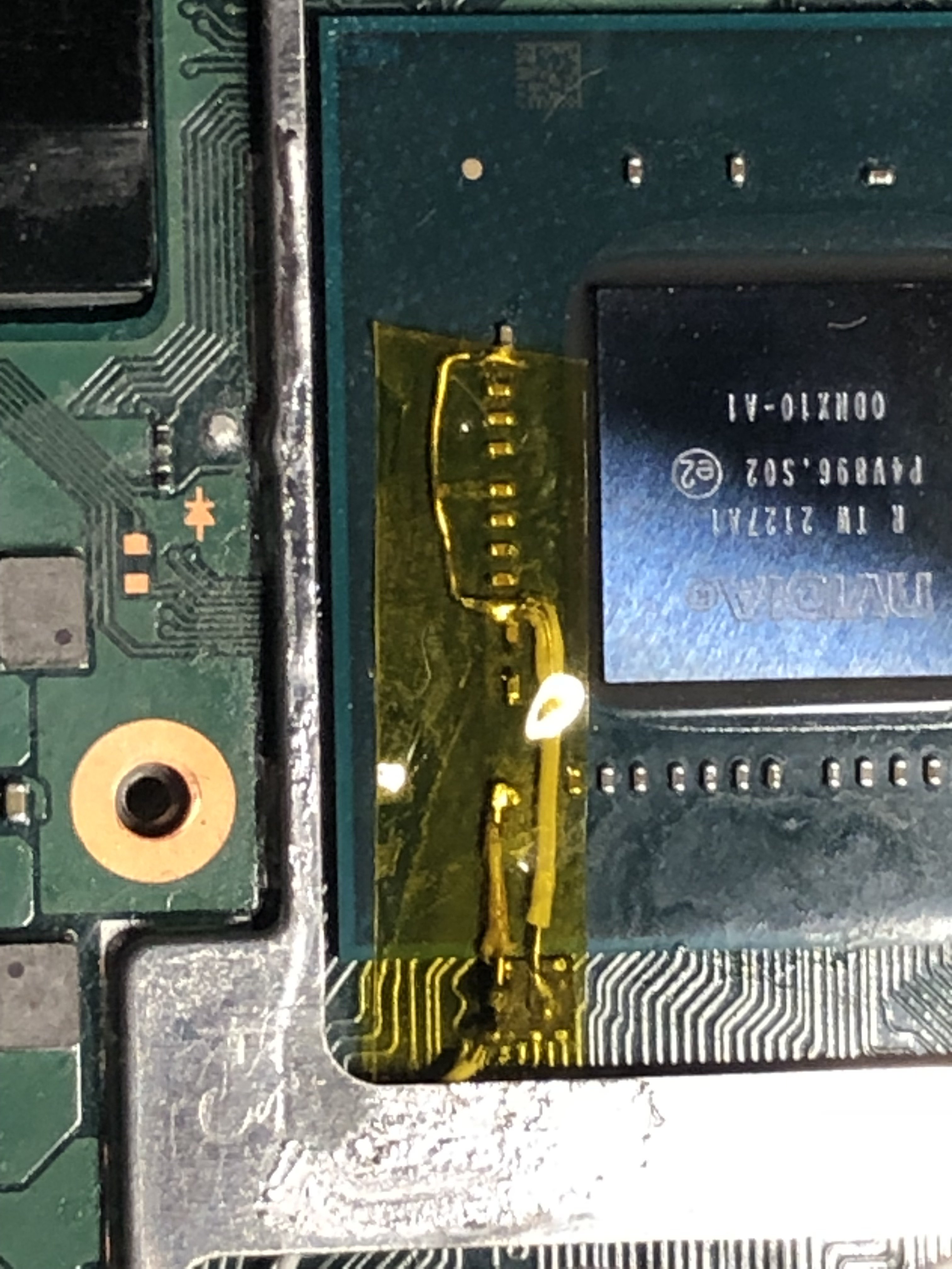

...it seems that for the RST/CPU/CLK/DAT0/CMD -- I should have used same type of wire (enameled 0.2)...
i was using a mix of kynar (awg 30) and enameled wire, and I was getting Blue > Red LED (maybe Timed Out? / Timing Issue?)
when I replaced the wires and made them the same type, I got 2 sec Blue then Green LED...

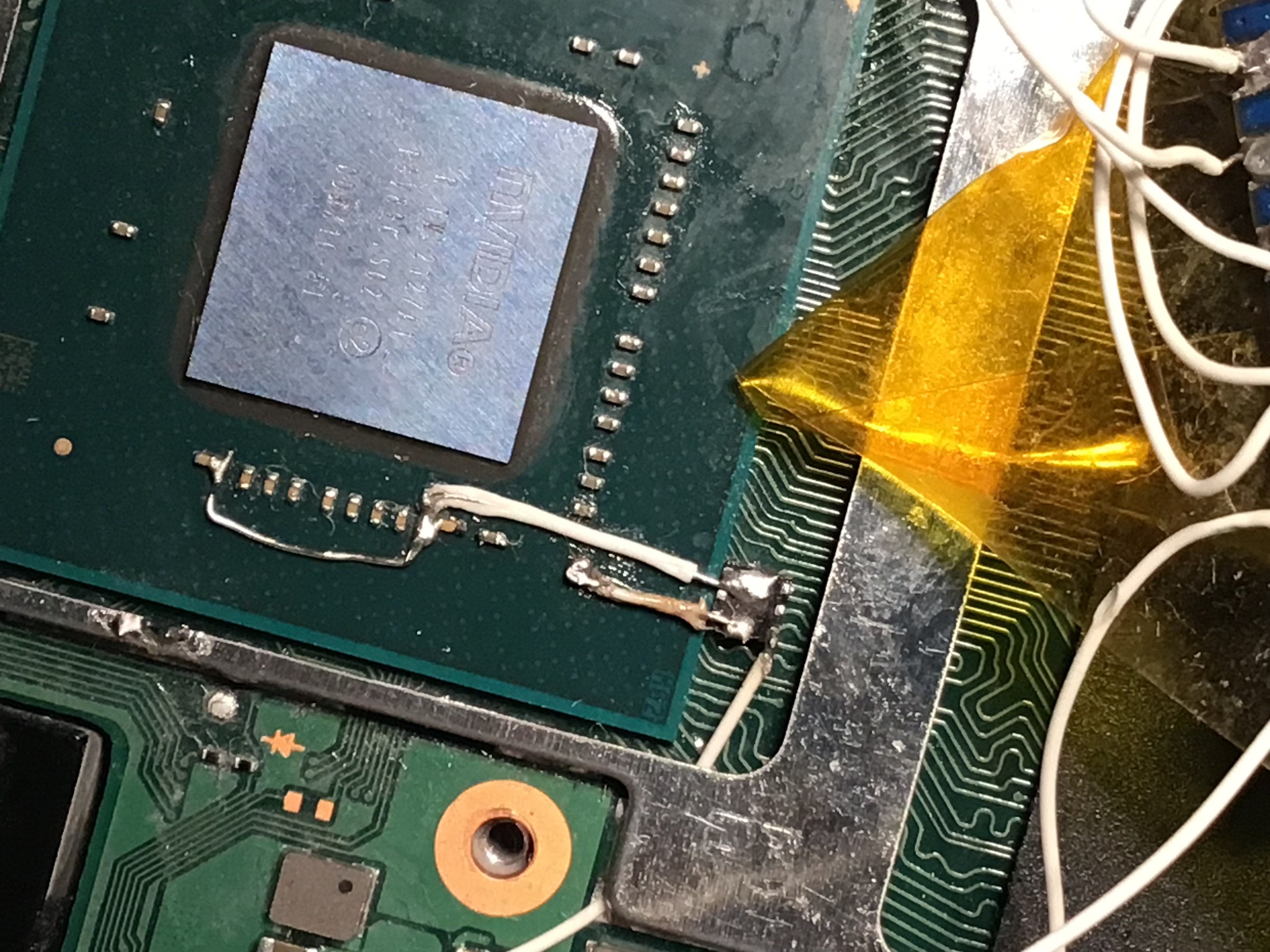

Finally I did it!
Of course, in fact, this is my first work with a soldering iron inside such devices and I encountered many problems during installation.
I strongly recommend that you use a thin magnetic wire (0.1mm) for all points except 3.3v, RST and GND (AWG30 Teflon wire is suitable for these). Also AWG30 is enough to connect one MOSFET transistor to the caps.

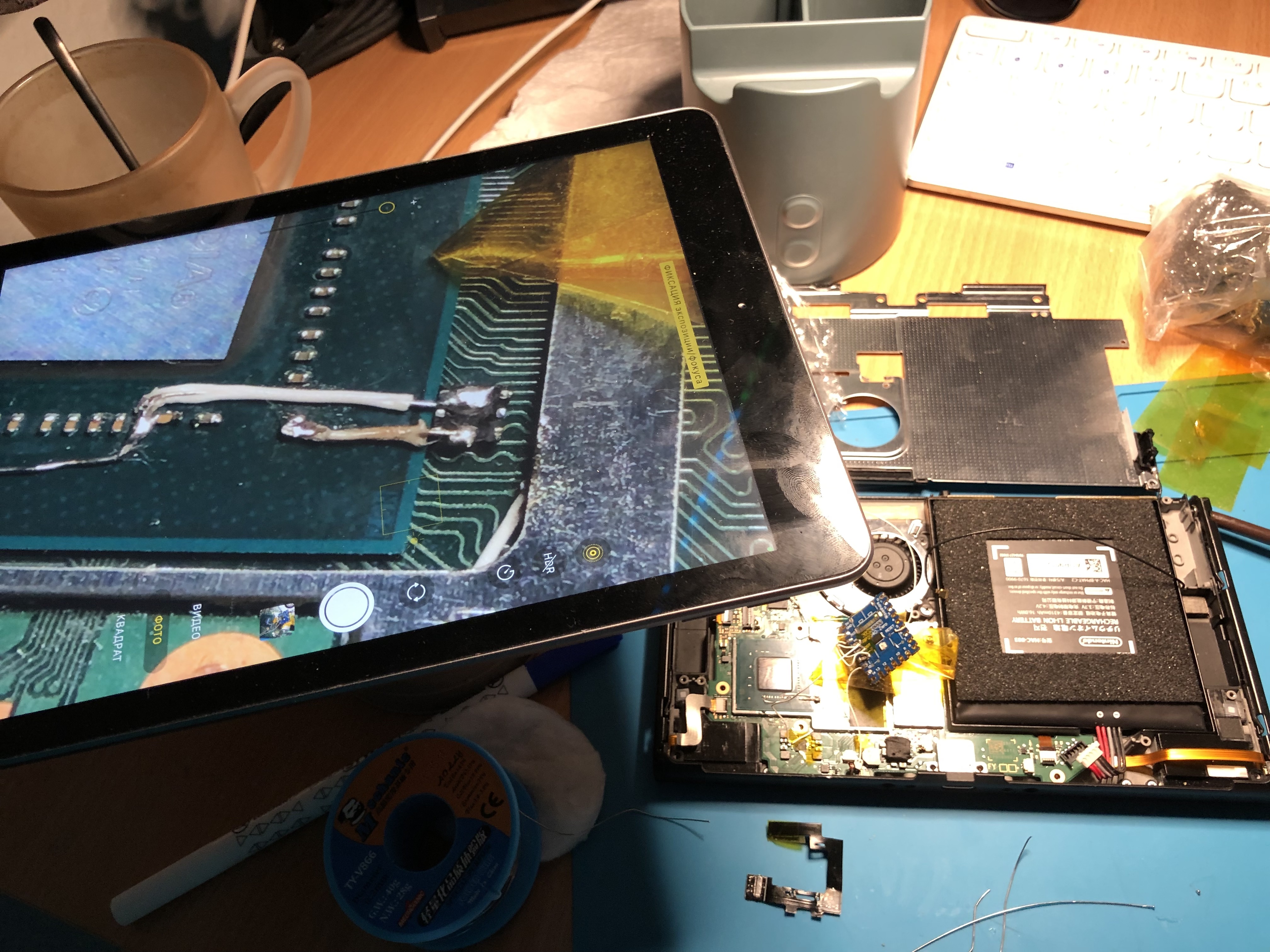

Instead of a microscope, I have successfully used an iPad or Smartphone in zoom mode, simply by placing it on a glass. I recommend:
Initially, I ordered such a cheap set from Aliexpress, soldered it 5 times, but it never worked:
Then I removed the transistors from it and checked it with a multimeter. They turned out to be workers. Marking: 2202a ct84y. I installed one with AWG30 wire and it worked. Solder point G only with a copper thin wire, and not like me:
Many thanks to all of you, the GBATEMP forum, and most importantly to the creator of the firmware! You are our hero!

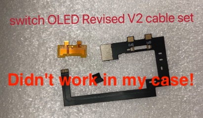

I used these flats and they worked, I paid around 13 euros for them
