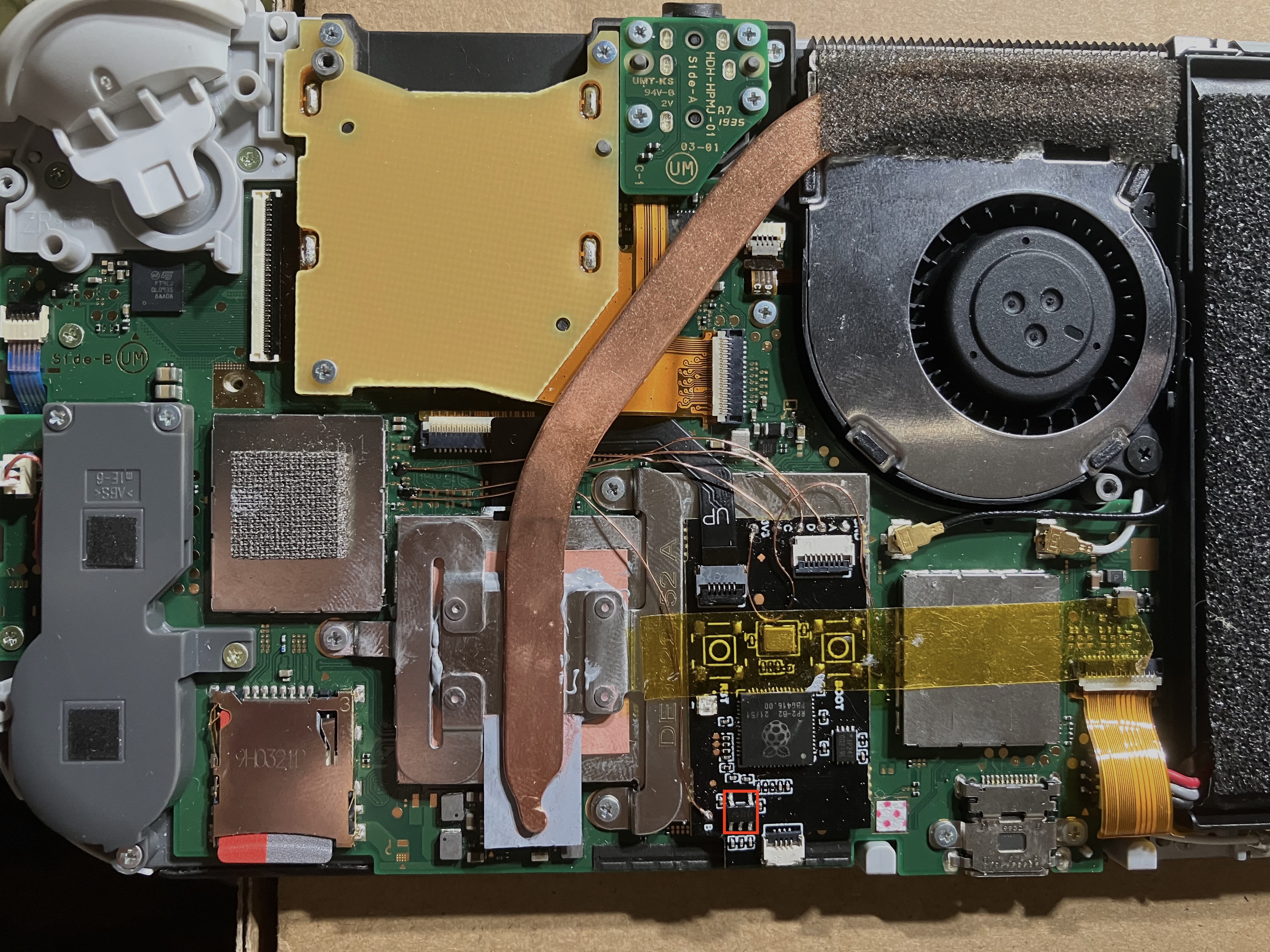

Just installed the rp2040 custom board on my lite and it works great except for a few hiccups.
I managed to fix these issues in case someone runs into:
The boot and rst buttons are a bit high on the lite, they can be removed.
The LDO (the chip in the red box in the picture) has to be removed or it would break and cause problems, after a day of playing the console suddenly gets stuck and the CPU buzzed and it wouldn't power on, I thought the CPU was dead, but everything went back to normal after removing the LDO, looks like reverse current killed it.
