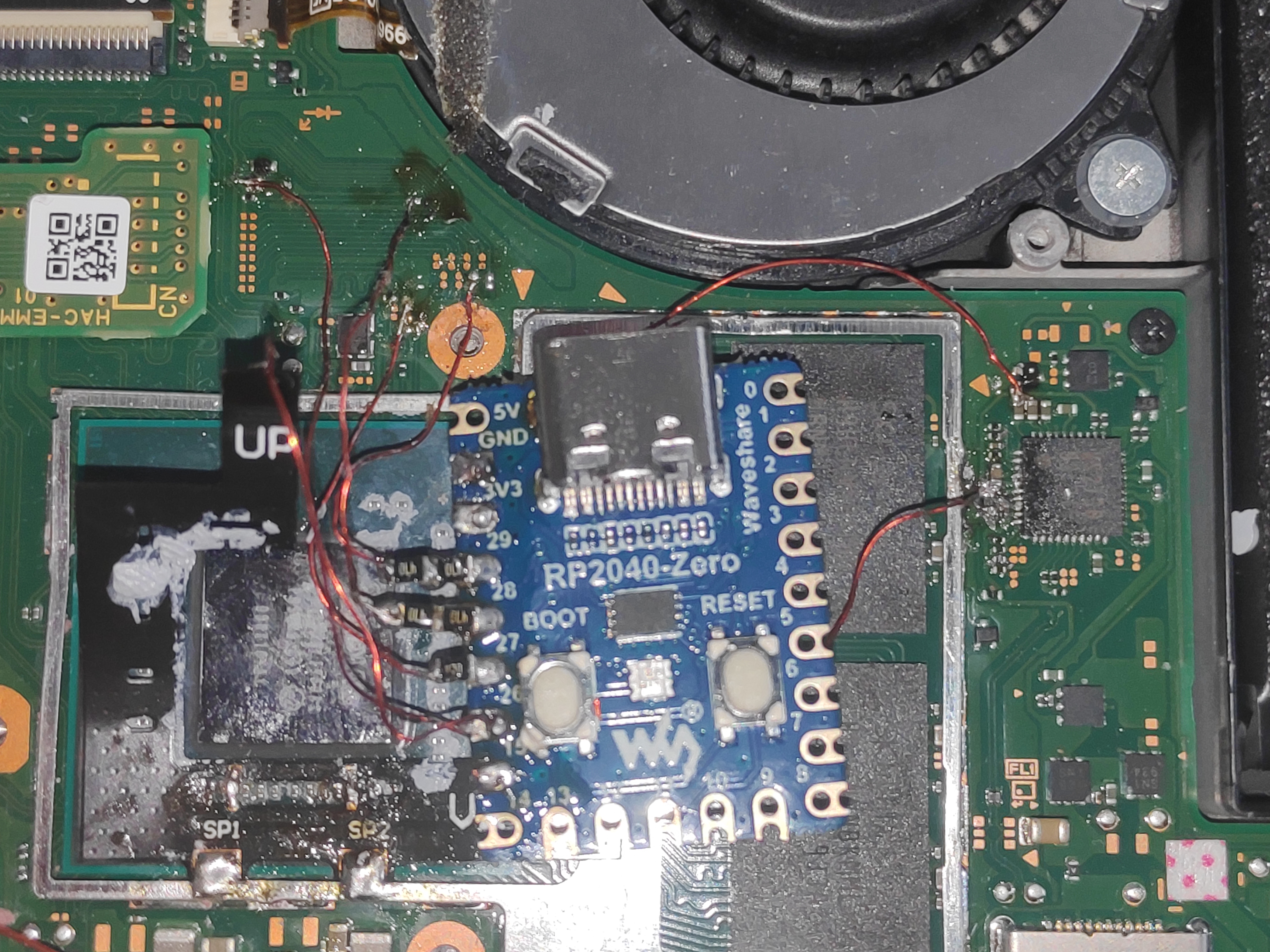

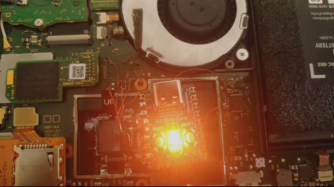

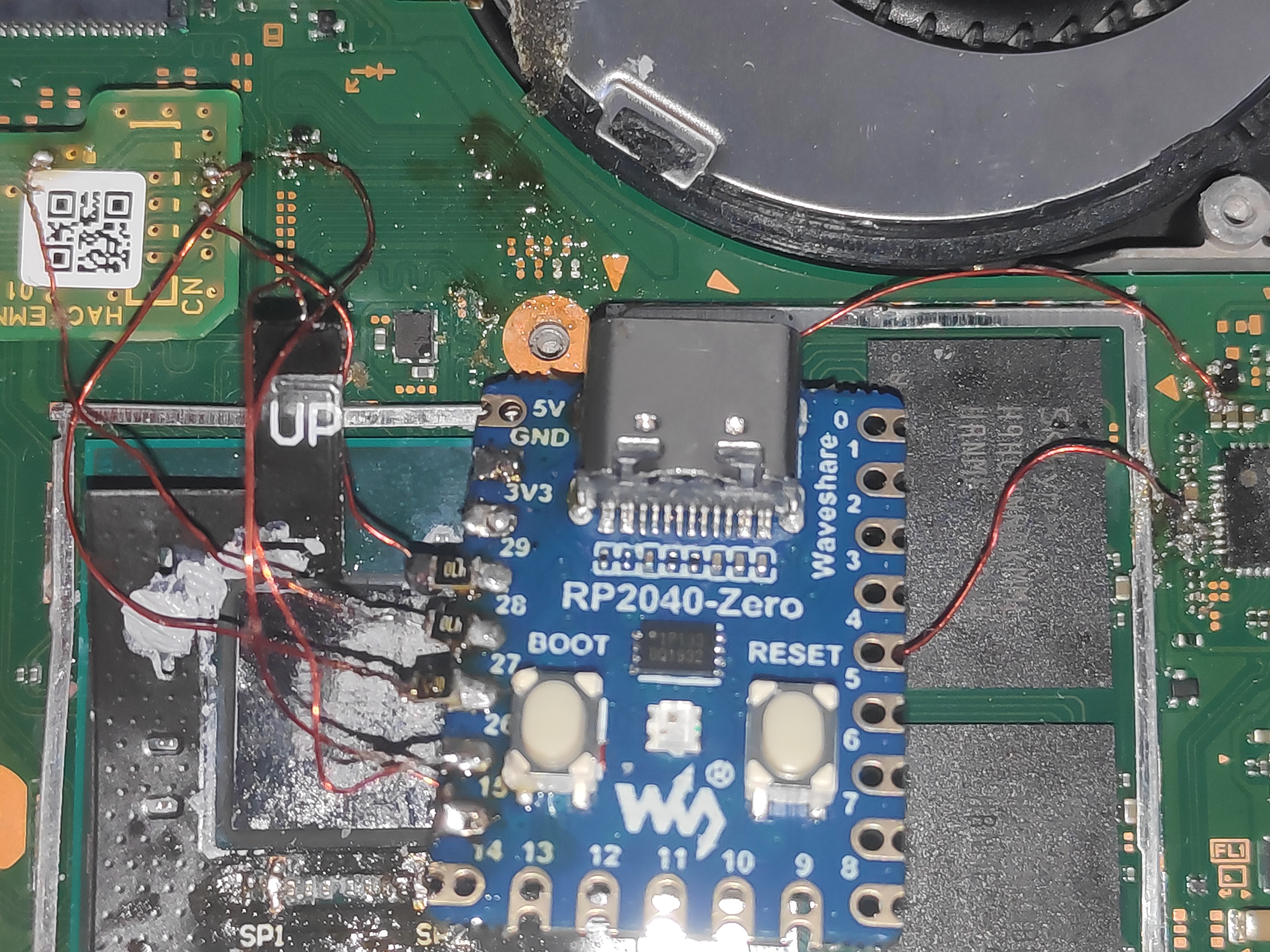

I'm currently trying to mod my V2 Switch using an rp2040 zero and the hwfly v2 cable, but its not working so far. I get a short blue flash followed by a short orange flash. The faq suggests that there is a problem with the dat0 connection to the emmc. I tried the solder/test points on the main switch pcb for clk, dat0 and cmd, as well as the points on the emmc. There shouldn't be any cold solder joints. I tested every connection using the test points on the main switch pcb. I've got the SKhynix emmc so this should also not be the problem. I've tried it with 47 ohm on dat0 and cmd, as well as with 94 ohm, both didn't work.
Some additional information:
- The switch doesn't boot when everything is connected
- The switch does boot to OFW when the rp2040 isn't connected to the 3V3
- I had to apply the rgb bridge on the rp2040
I'm out of ideas. It would be awesome if someone had some suggestions.

Your soldering doesn't look very good.
Reactions: Danook28
yes I totally agree. I tried to fix some joints and it didn't really work out. But the connections used by the emmc all seem to work perfectly fine.
Reactions: Danook28
I see alot of flux residue. I would clean those first (if you have not done so yet). I had a similar problem on Oled, everything was ok, the flux was the issue.
Also check edhe continuity of those enamel wires, it can happen sometimes that they connect to the solder point but they are not conducting anything because the enamel coating did not melt while soldering, (especially on this red type that you are using since it has a higher temperature rating)
