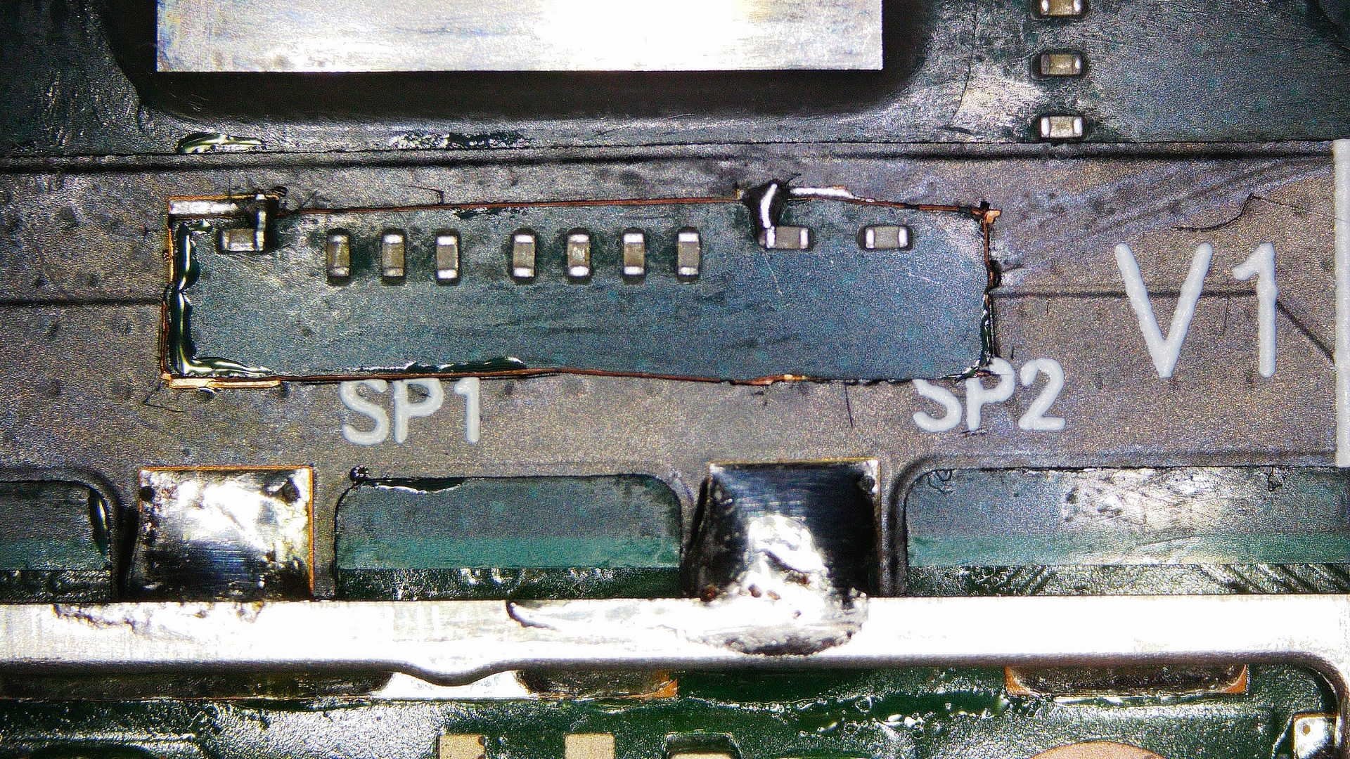

hello, I had an accident and that capacitor is no longer there, also the other capacitor where the mosfet is connected shows continuity on both sides, I suppose it is because this capacitor is no longer there, any advice?
switch can work normally without this cap. you should get continuity if you have already connect the mosfet to capacitor
Solder points are different from the v2 flex. If you want it to mod you need to use a jumper for the cap but it is very hard to solder a joint to a cap.
i have some images from someone post , mod his flex.. but i forgot who he was... , he cut the flex someway and still use>solder the caps, but he only use 2 point solder... but idk is he using lite or not...
yes, there are someone have already done that in this thread
the current situation is that the cpu does not have any of the capacitors where the mosfets are connected, does the console work the same without the 2 capacitors? or should I put at least one?
Ícono de validado por la comunidad
v2. lite, oled use the same flex cable, so if he modded for v2, it also works on lite
View attachment 365913I guess it should work. afaik the capacitors do nothing in this setup.
wonder who post this image?
Idk. You can trace the line to 2 upper point which the capacitors connected to, make sure not cut the line. you must connect 2 anchor point to the frame (it connects to GND and source of the mosfet) due to 2 lower point has been cut off.

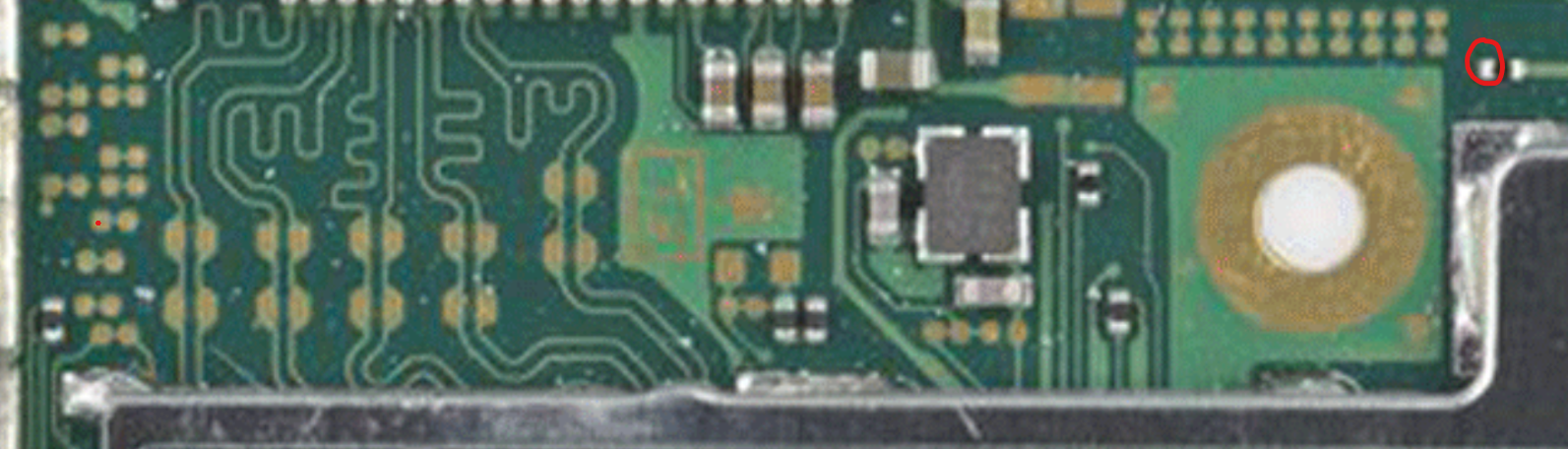

Thank you very much for help me ^-^! Can I solder the wire in the left pad to the left part of this instead?
I have reconnected the trace, checked the connection but the switch lite still won't turn on. It still powered on before I damaged the pads, repair it but still not working :( Does anyone know what is the cause, what should i check?
