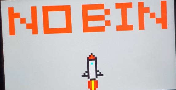

Hi, I need help pls.
I have Switch V2 with SX Core. Install Atmosphere with FW12 and want to upgrade to FW13.0. When I want to boot in RCM mode and inject payload with Tegra but its take long time. I close program and try to payload again, but can't enter to RCM mode. The switch will turn on and show No Bin. Any solution for this? Thanks.

Do you solved the problem yet? I got same problem
Not yet. I tried Press power and vol up button (hold vol up) until switch not enter to no bin. And then connect to PC and running but Tegra fail to inject payload. Triedon all version of Tegra and port USB with different cable.
Stop trying to enter RCM and inject payload, RCM exploit will never work on Mariko.
You need payload.bin on your root of SD card, since you are using Spacecraft-NX.
Download latest hekate release, extract to SD card, and rename hekate_XXX.bin to payload.bin
If it doesn't work, your SD card reader might have broken.
Thanks a lot for solution man. Its work!!. For the latest FW (13) i load fusee.bin from lastest atmosphere. Once again thanks for all your help.
