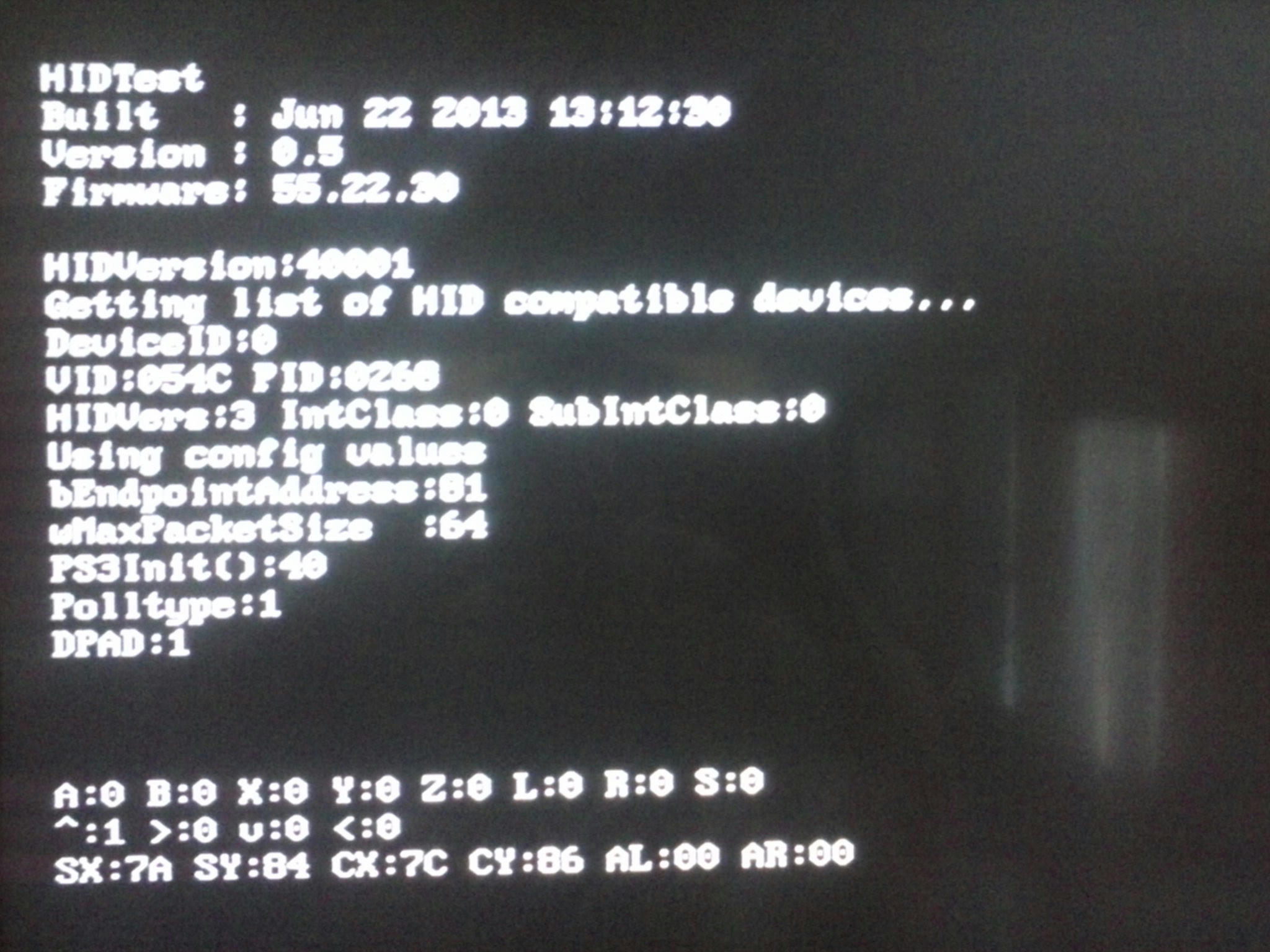

Hi there! I'm having a problem. My D-Pad is always pressing UP when I check it with de HIDtest and that cause delay when I try use other buttons.
[Dual Shock]
VID=054C
PID=0268
Polltype=1
DPAD=1
DigitalLR=1
Power=2,40
A=2,02
B=2,04
X=2,01
Y=2,08
Z=2,80
L=2,10
R=2,20
S=3,02
Left=1,04
Down=1,06
Right=1,02
Up=1,00
RightUp=5,01
DownRight=5,03
DownLeft=5,05
UpLeft=5,07
StickX=6
StickY=7
CStickX=8
CStickY=9
LAnalog=10
RAnalog=11
The rest of the buttons works fine.
I also tried with DPAD = 0 without diagonals.

Edit: Tredarnos A screenshot of your hidtest would be helpful, as the only two reasons that could cause your problem are that the controller itself is damaged, or that you haven't configured your DPAD correctly.
Reactions: JnL_SSBM
faku1810 here... Up is always 1, the rest works fine (A, B, sticks, Z, etc.)
You should try using HIDtest 6 since that allows you to see the raw values at the same time, to see what value is in the second pair (since you seem to have the dpad in that one), if it's 00 all the time, then that's the reason you get the "up" pressed, but that shouldn't be the case, so if it is, then you picked the wrong pair for the dpad. Remember that they're counted from 0 to 7.
