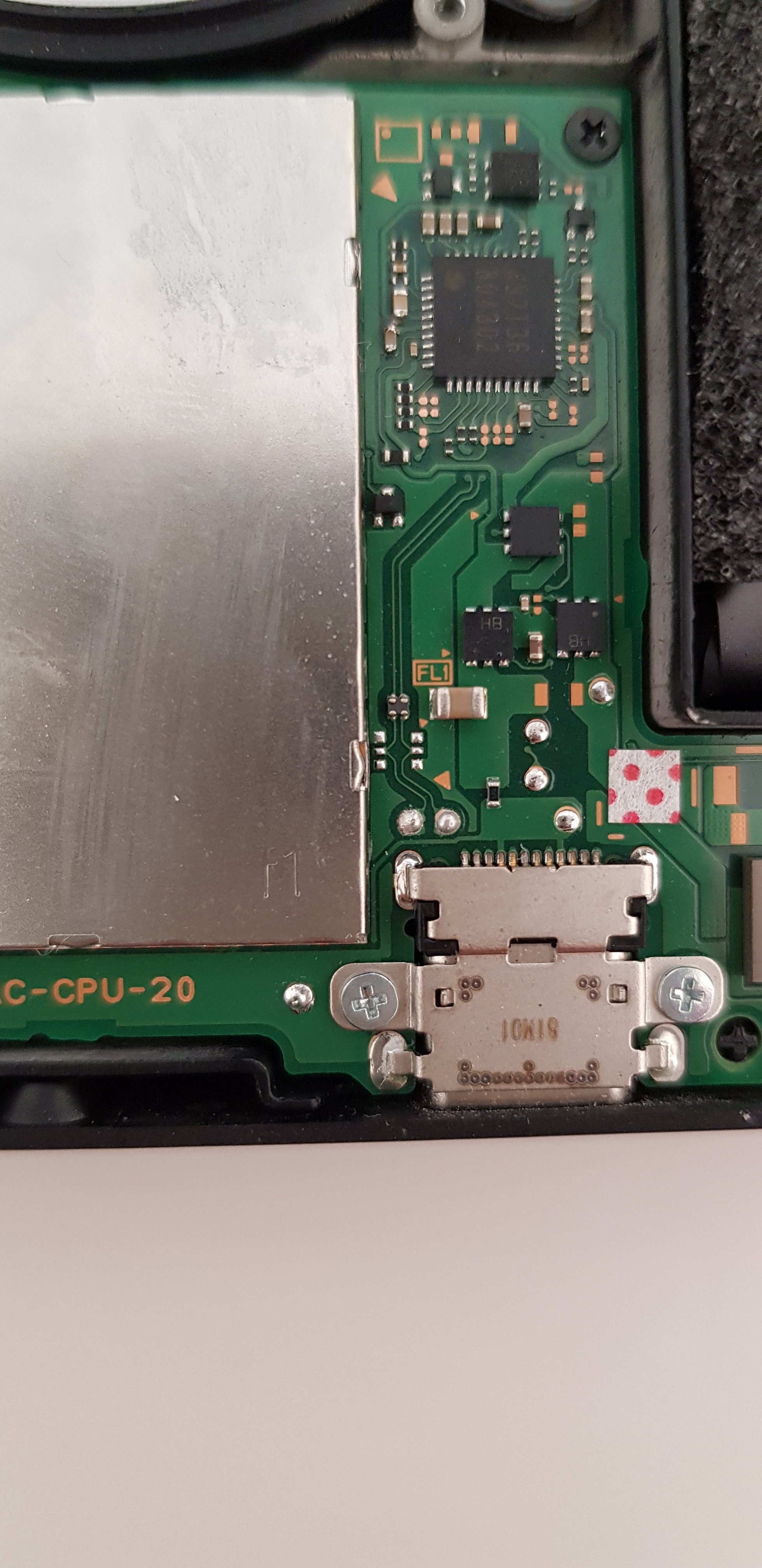

Hi Guys,
I am new on the NSW scene and hope someone can shed some light on the problem that I am having after installing the trinket accoring to the Method 1 guide in this thread using the SX OS payload.
Basically the battery will not charge anymore and I already read though the complete thread, but couldn't find anyone with the same issue.
So initially I thought the operation was succesfull, although I did have some trouble with the new 3V point. Since it was so small i bridged the bottom and top resistors, but I managed to remove the solder and it seemed all OK after.
However, I did forget to test whether the battery would charge. Each time I managed to coldboot and restart the device into SXOS, but the NSW started to hang at the Nintendo Switch (Horizon) logo after 5 reboots or so and I just couldnt get pass the screen anymore. The battery was somewhere at 10%, so when I put the NSW in the docking station, the power led on the docking station just started blinking fast. Tried it on other charges, but no luck.
Then after removing the back cover and connecting the charger to USB port, the trinket started flashing red.
Checked all the solder points, but they seemed fine. This was the moment when I went into panik mode, thinking I bricked the thing. Decided to unsolder the trinket and cleansed all points with alcohol. It boots into OFW horizon as schould, but it still wont charge the battery. I really hope I haven't bricked the NSW :(
All suggestions are welcome...

I'll start how we normally start
Can you post a pic of your install? As high resolution as possible?

Hi Guys,
Sounds to me that if you shorted, bridged a connection aka the 3.3v that goes to the Power Ic m92t36
And or resistor,
you may of ruined the charging circuit or Power ic chip,or resistor.
And seen as you have removed the modchip /trinket and removed all connections im guessing im right, you have blown a component, or you have a missing connection to wear you joined your mod chip..
I havent read my outputs with a multi meter, But maybe someone on here can provide you with the information of the components to check and what the readings should be ,
At may also be the bq24193 battery IC,
Like any install or uninstall soldering etc, always check your solder point and or connections..
Have another look at your main board for any missing components, bad solder points bits of solder bridging connections etc..
Reactions: Kobazzoni

Hi Guys,

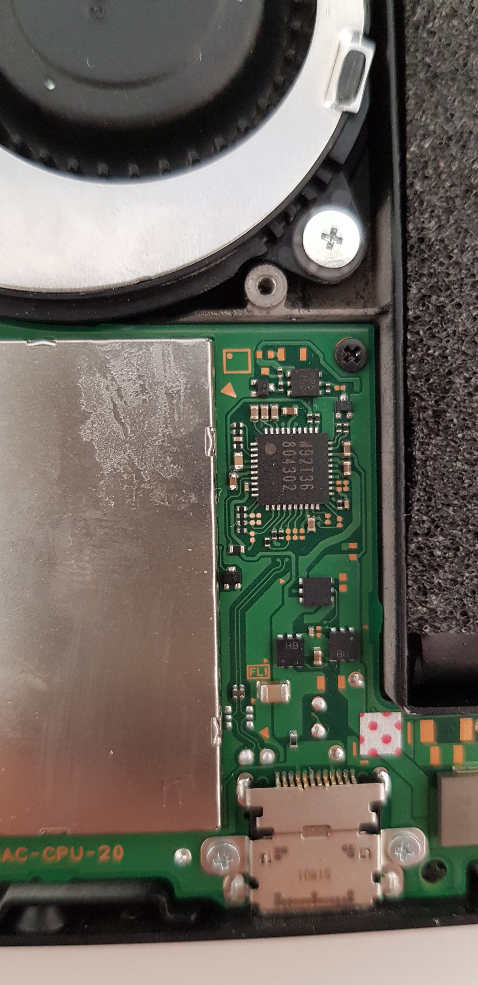

Hi Matty, currently there is no install because i removed the trinked, but here are the images:
Check this cap here in red, use a multimeter for continuity connect to the bottom of cap towards usb connector, and the pin on the ic connected to the trace under the cap
Looking at that picture tho it looks like you used a tool to cut and you may of grounded your trace or cap
View attachment 141075 View attachment 141076 View attachment 141077
You need to reflow that capacitor that Canna marked.
Use a little flux and clean well. The joint is dry and possibl;y bridged to VCCIN (above it). The cap looks undamaged.
Those little caps can take a fair bit of abuse. I`ve had plenty stuck to the end of soldering irons in the past.
Get a nice joint on that and all will be well.
Reactions: Kobazzoni and Canna
Ok, measured for continuity bottom side of the cap to, I think you meant the pin on the ic going to the top side of the cap right? There is no continuity. I am not sure I can repair this, since i dont have the proper tools for such small components. Looks I am out of luck.
Ok thanks Matty, Canna. Will reflow the cap and let you know the outcome.
No continuity not connection reflow like we said and ur going to do. take ya time budd.
