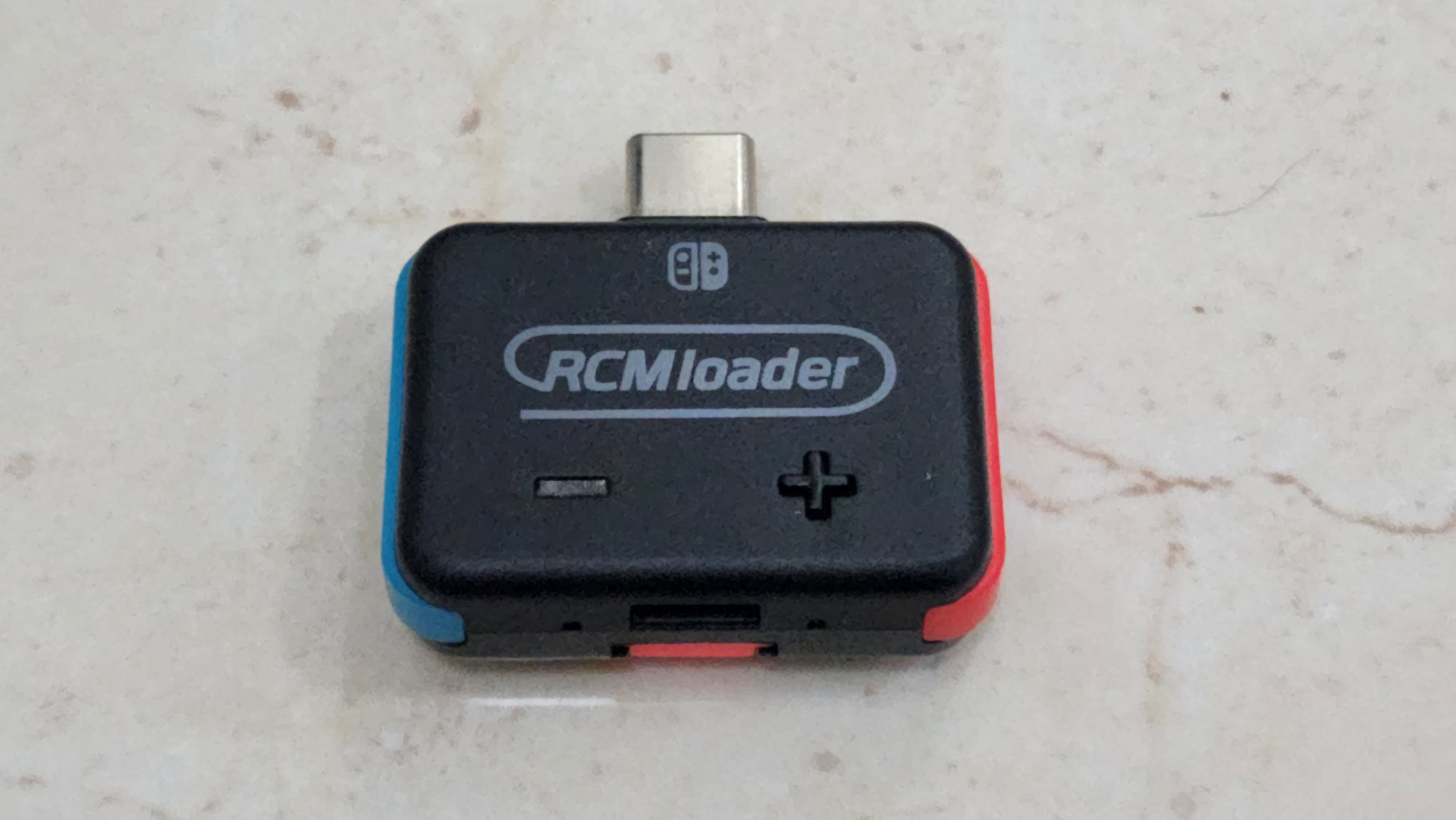

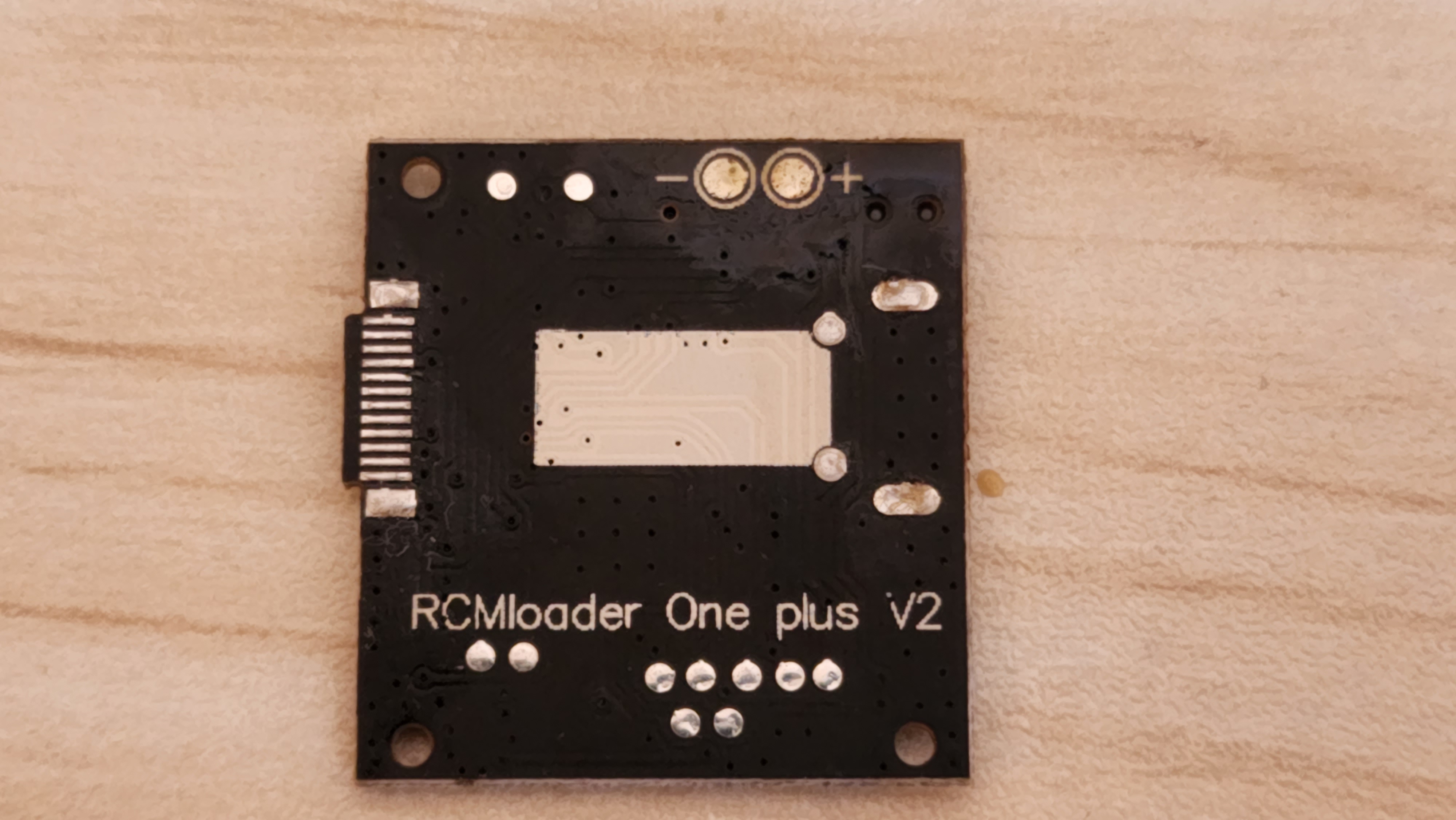

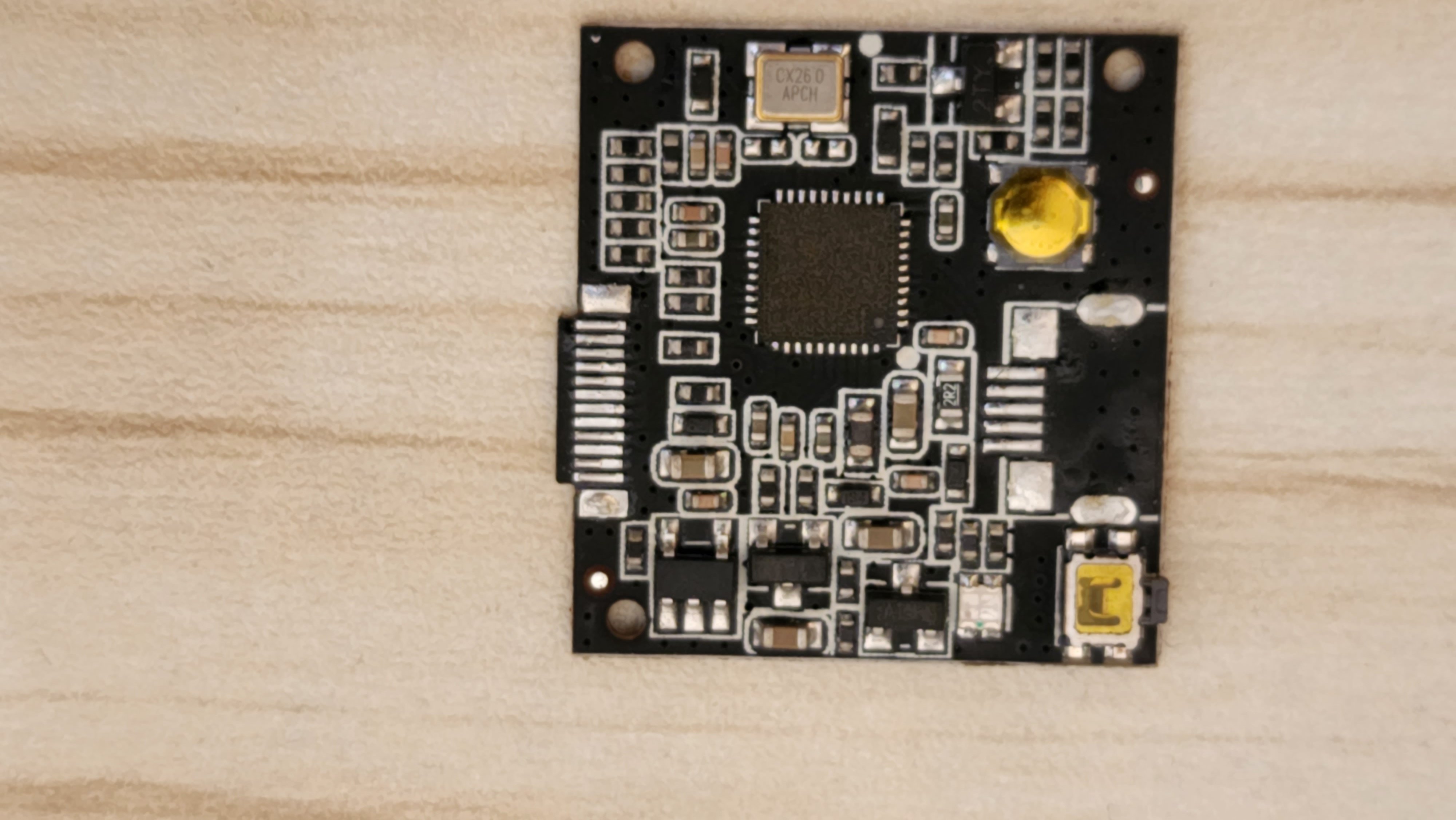

This is the RCMLoader I used:- It's a clone so the injection time is a little longer than the original.
2. To do this you need to pry open the plastic part. It will left you with this.

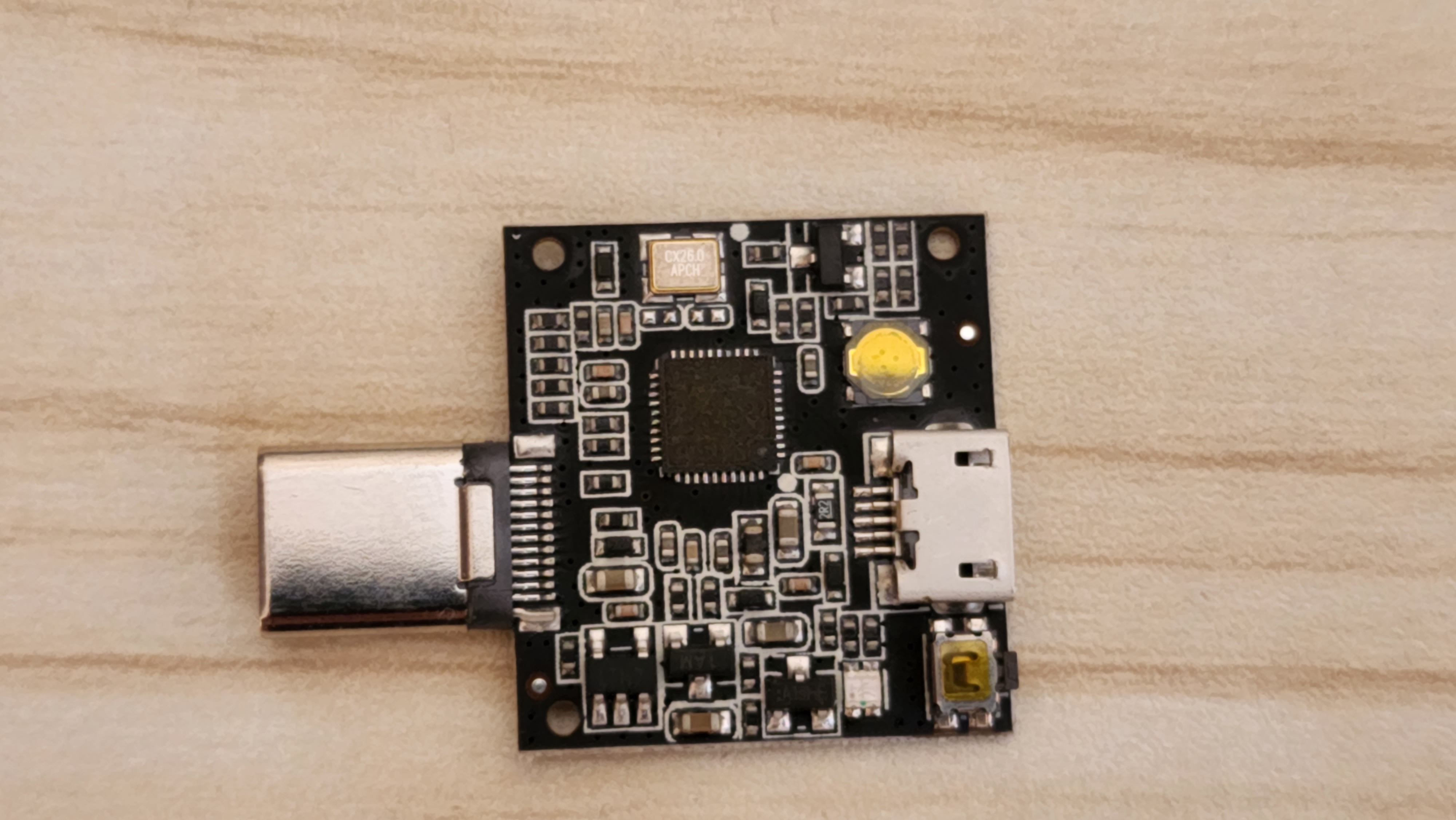

4. Use hot air station to remove Male USB C and Female Micro USB connector (too thick to fit into the Switch's internal). On my 2nd attempt, I removed the reset pushbutton as well. Much more cleaner.
This is the result

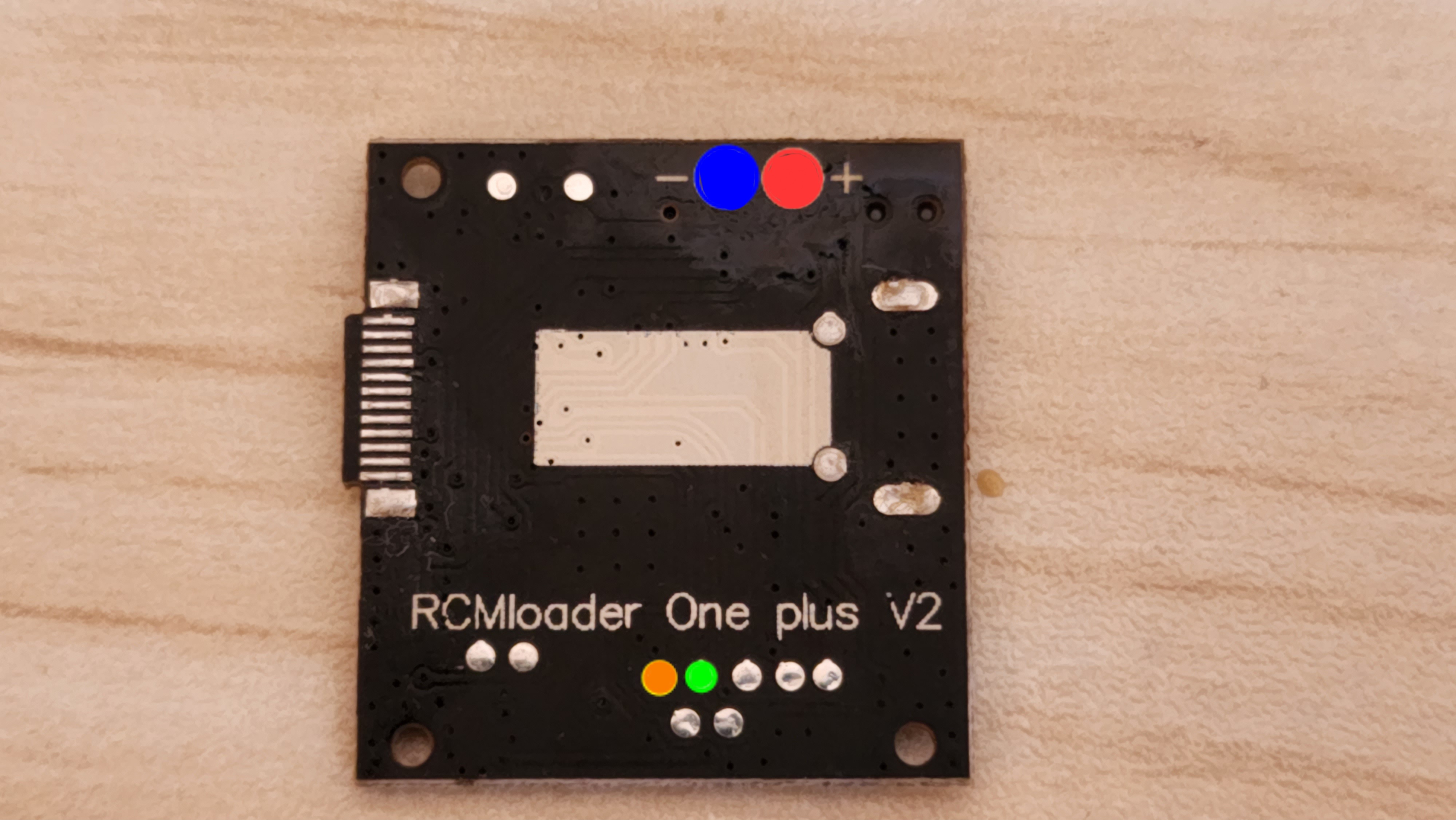

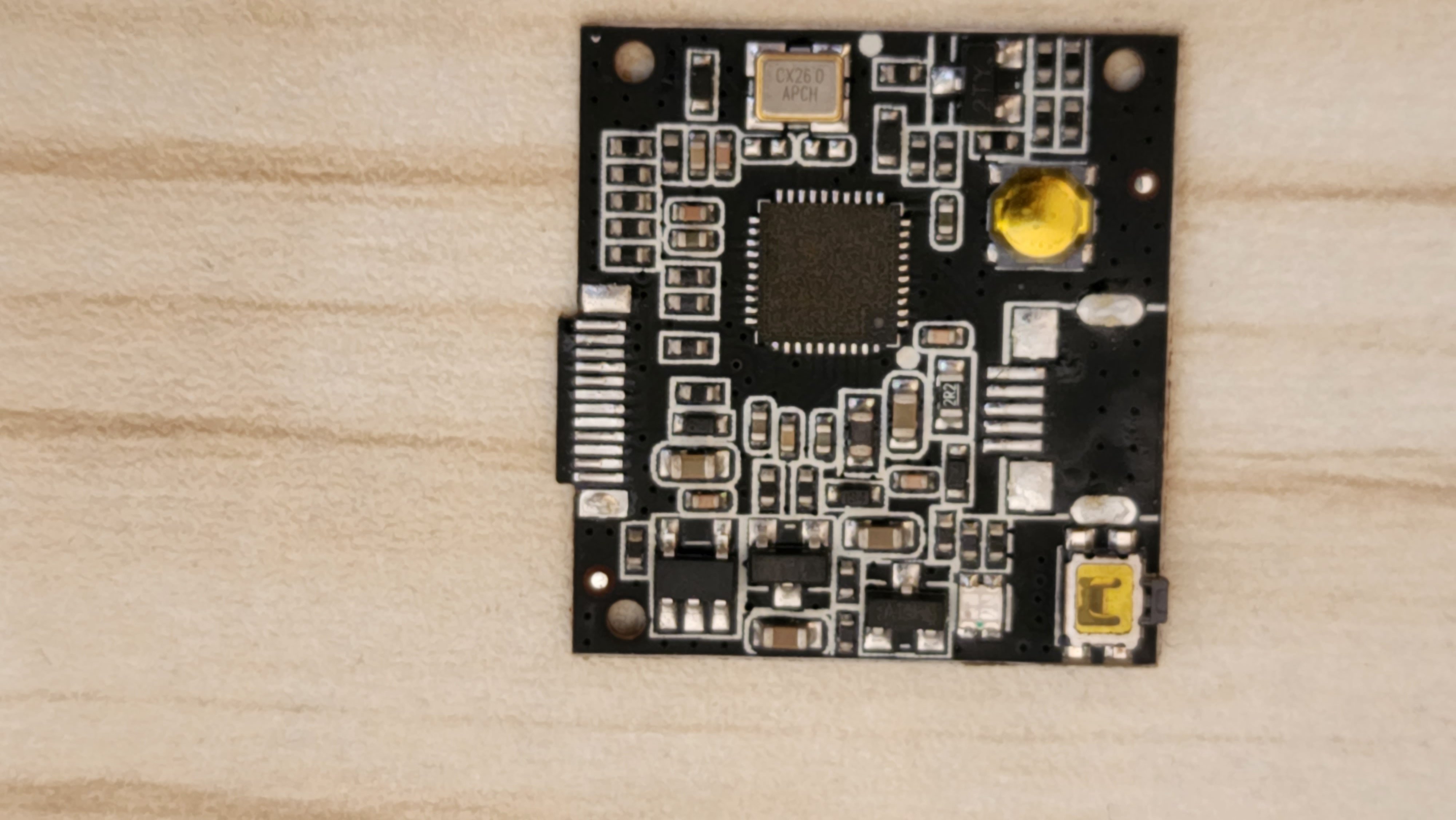

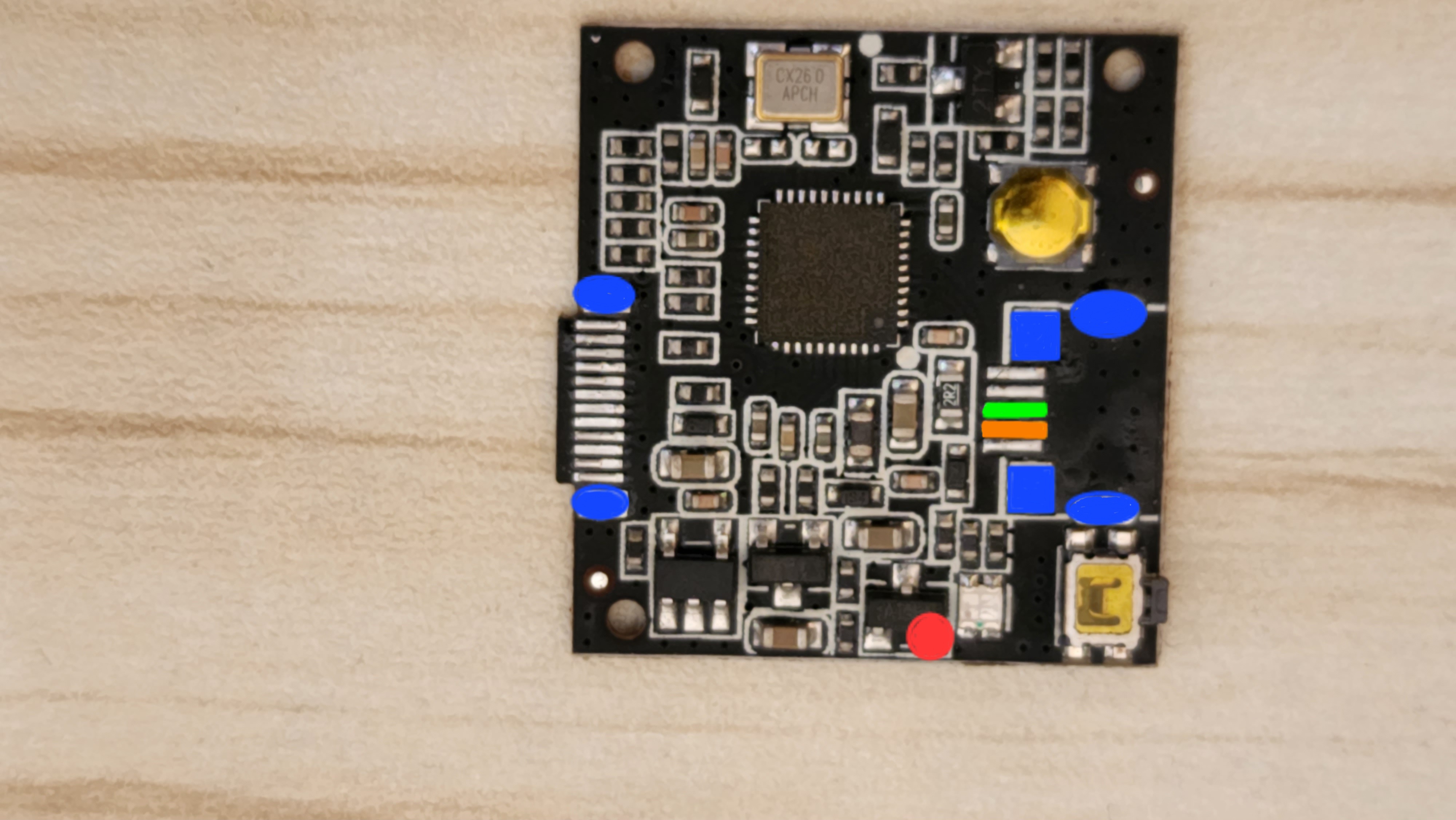

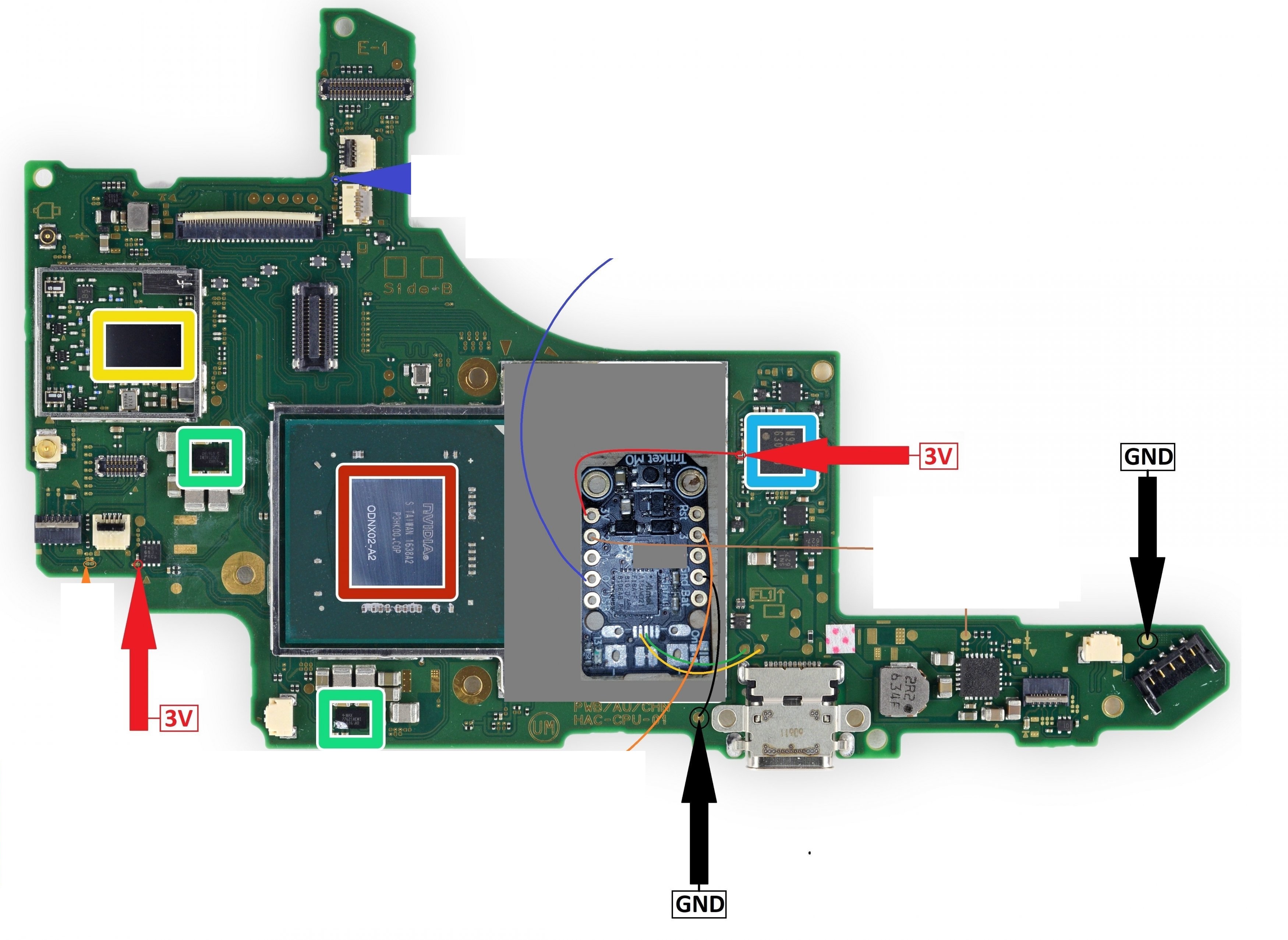

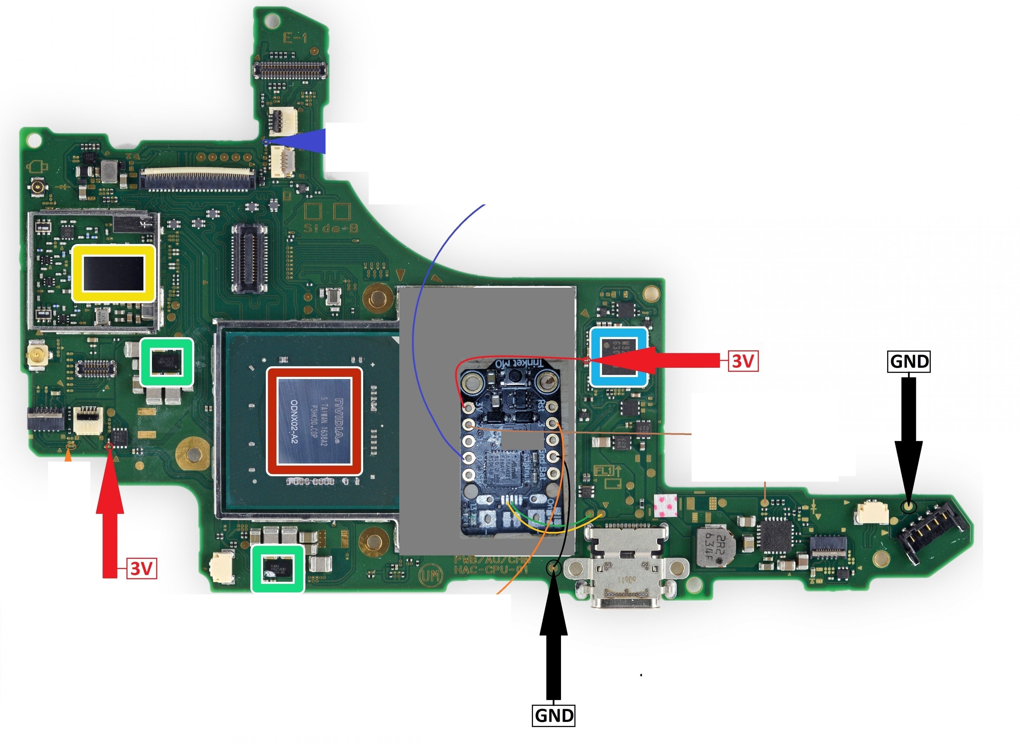

3. There's 2 ways to do this (or combination of both). I marked the points to solder wires.
From Above
From Below
Legend-
RED - +3.3V
BLUE - GND
GREEN - D+
ORANGE - D-

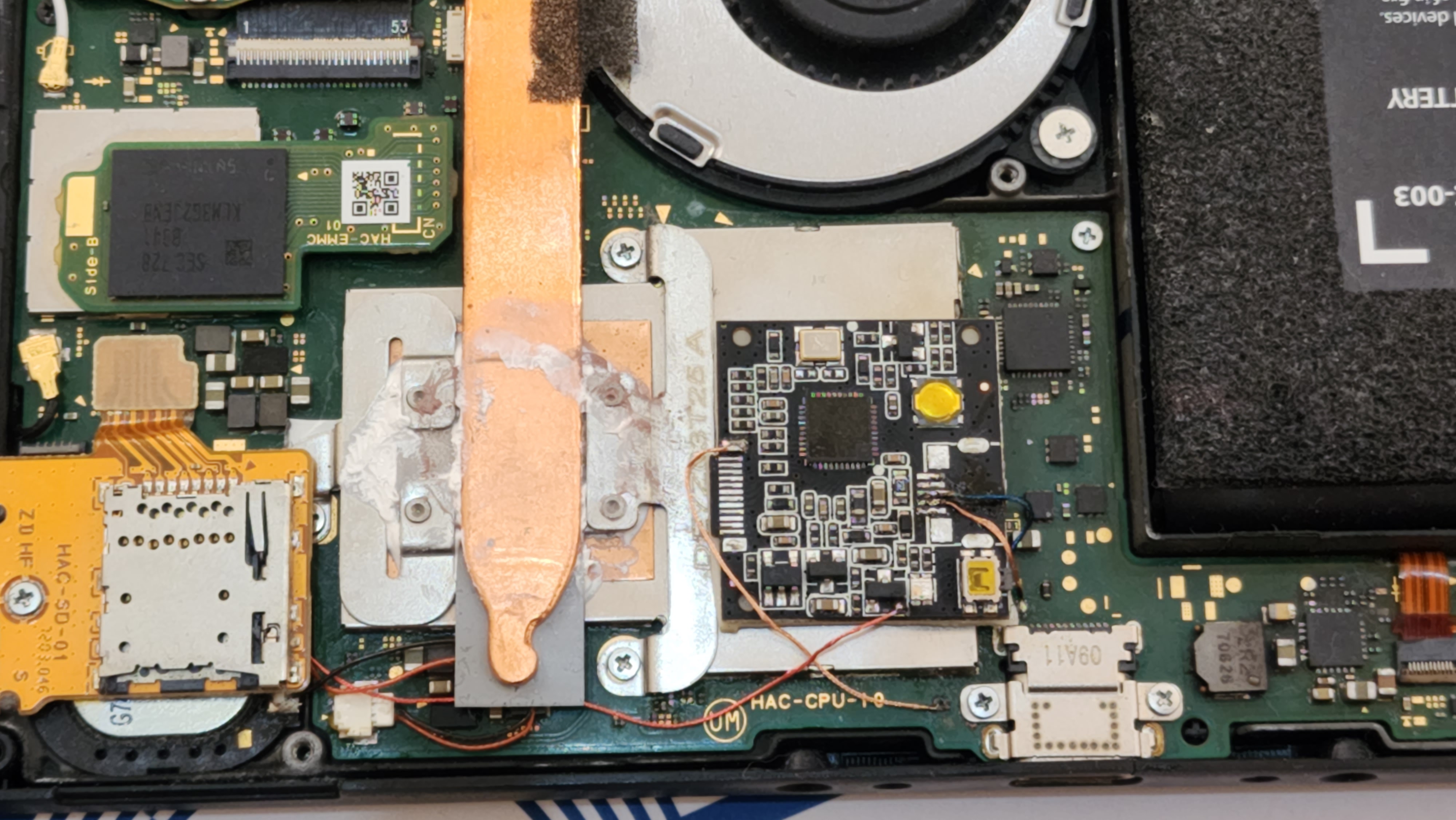

4. Wired them up similar to Trinket M0 wiring. But WITHOUT the Joycon Strap, USB Disconnect, and Vol+ Strap.
This is how I do my first mod
This is the result
View attachment 351021View attachment 351020
From Above
From Below
Legend-
RED - +3.3V
BLUE - GND
GREEN - D+
ORANGE - D-

Well done. I wanted to tap from that capacitor for the 3.3v but don't have enough confident 😅.
You can also trim the USB C edge with cutter just to make it flush.
