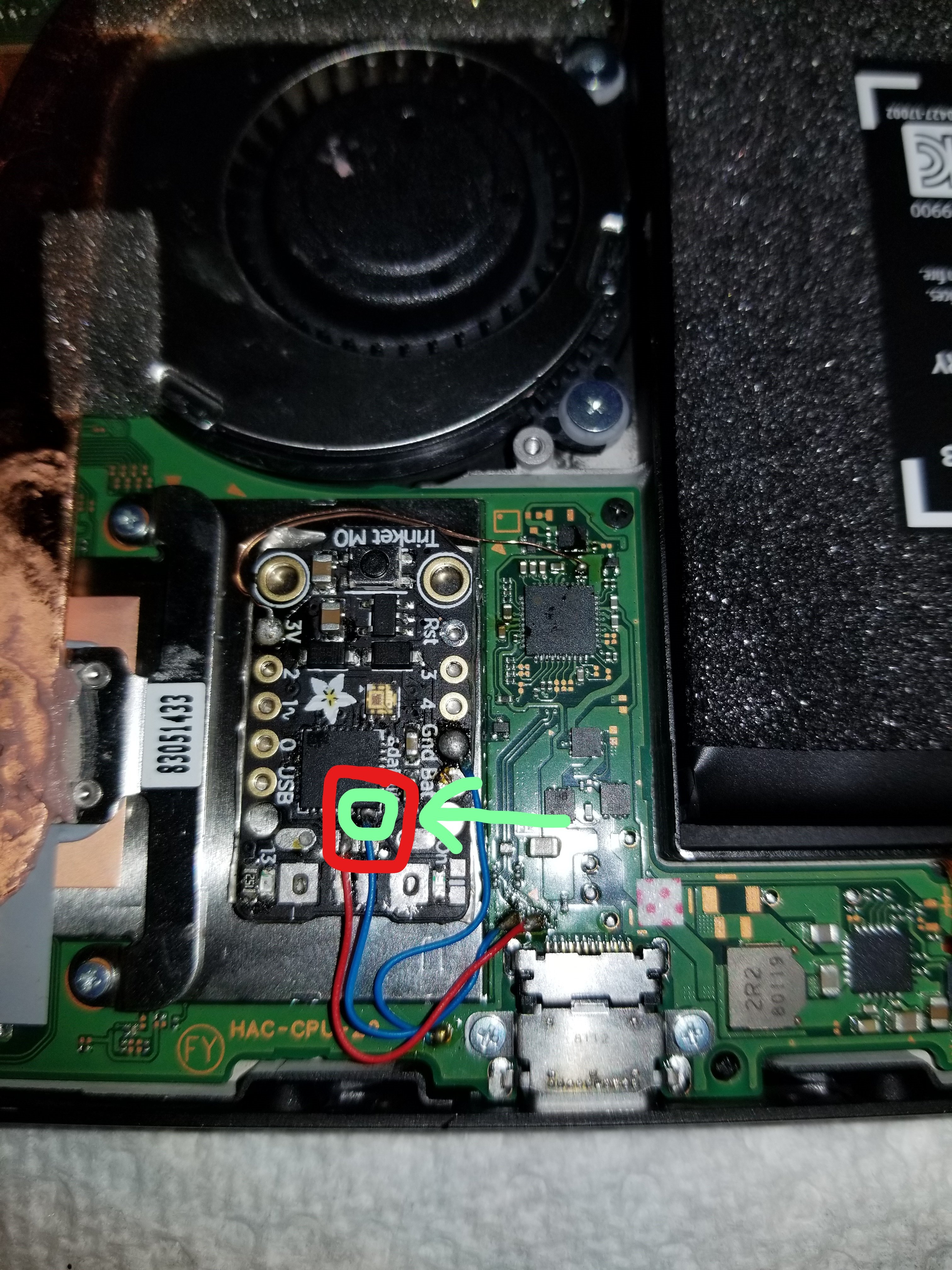

Disconnect USB, double-press reset to turn trinket LED red, then plug in. Should turn green.
For some reason I taped over the light, so I can't see it. Opening up again now.
Can you post a high-res picture of your wiring?
I'll post one after I open it back up.

I think you bridged two pins right there on the green. That may be the culprit of your slow/no boots although i could be wrong.
Disconnect the battery, try to unbridge, use less solder and clean your work and any other residue with a soft brush and a good PCB cleaner.
Let us know how it goes.
I checked those points, and the multimeter shows that they are not bridged (although it looks like it). I will re-do those points though. Thank you for checking it for me.

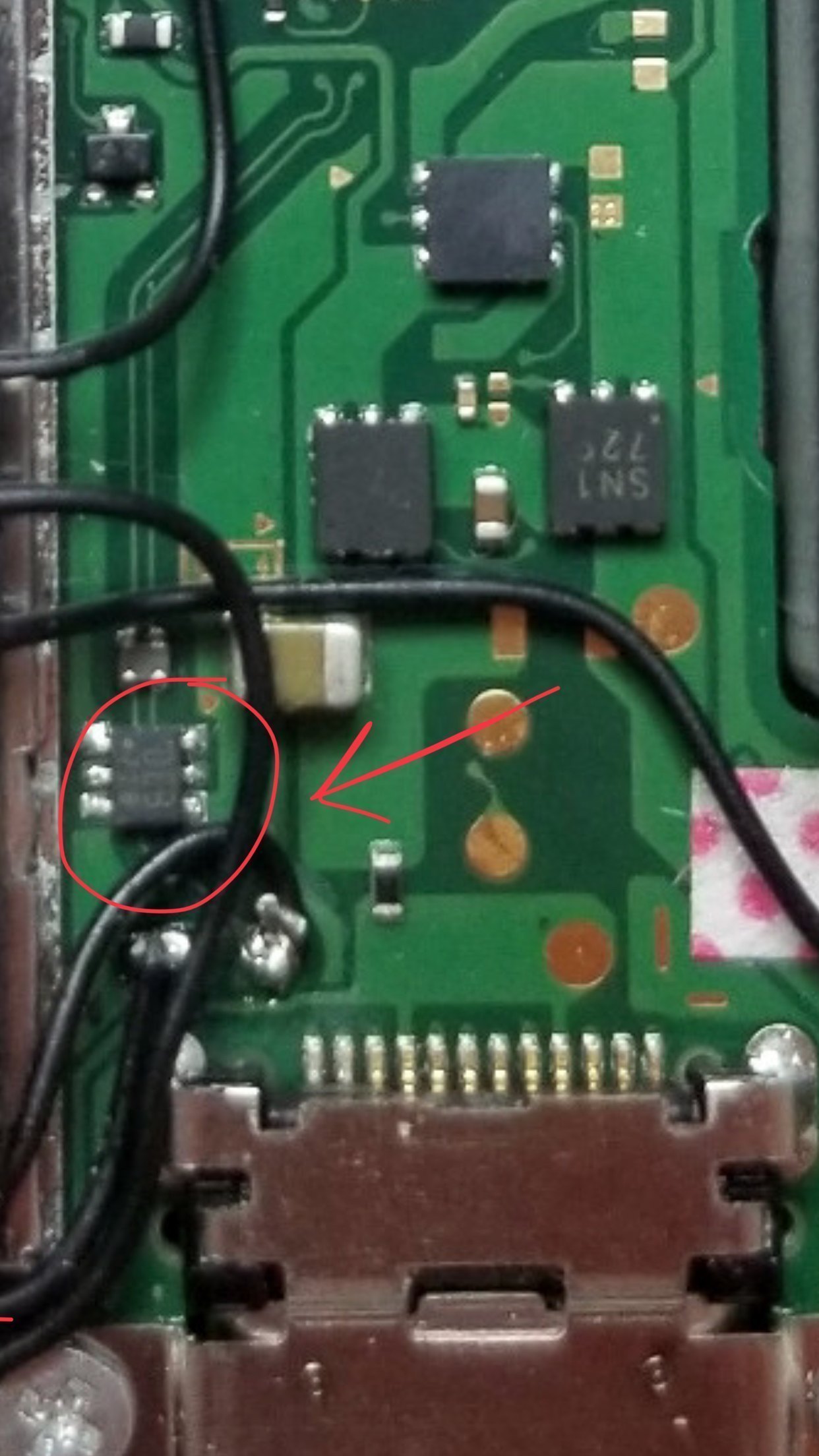

Alright so, I was one of the people who voted on their USB not working while docked. I've tried the new UF2, still the same issue. I installed via method 1 (no autorcm tho, I boot via modded joycon - vol + and power) -- I've tried the new SX OS UF2 and the new Hekate UF2 you put up (AIO) and I still have the same issues. I will take my back covers off tomorrow and snap some pics, but I quadruple checked my solder work post install, and prior to install I flashed the trinket. I feel it's also important to note that if I load into hekate or something and select the option to reboot into RCM mode, and plug the switch into my PC, even with the trinket "asleep", the PC will not recognize the switch :\ So the *ONLY* way for me to load a payload now is done via the trinket, which is driving me absolutely insane as I want to use lakka as well, but I will live with it for the ease of use factor :P
So, USB still a no-go for me apparently :( And I actually think this has something to do with the trinket still being active at all in it's sleep state.
** Note: I've also tried removing the reset button *JUST* to see if that was the issue, and it wasn't. Resoldered reset button to trinket after the tests.

I see. Why not just solder to the pad next to the red one just like the guide says?
Remove a bit of solder from the red wire and you should have plenty of space to solder next to it.
See my install pictures (First page of OP - Completed Installs). I barely used any solder on those pads. Just a tiny bit is needed. That and a steady hand :)
Let me know how it goes man. Good luck!
Yeah, that's why I couldn't put those two wires side-by-side, too much solder. I'm going to give it another shot tomorrow. I'm going to try booting without the trinket also to see if that makes a difference. Thank you for your help. And thank you Mattytrog also.

I am also wondering if perhaps the wire you used for the 3V point is too thin...
Can you try using the same gauge of wire you used for the +/- data points?
The wire is about 34 awg, and I've heard of people using 40 awg for this install, so I don't think that's the issue. But I'll double check too.
OK. Are you sure the trinket is asleep? What thickness wire are you using?
Also... Daft question... The payload is definitely booting isnt it?
Yeah I am sure it's asleep, certain devices like USB keyboards still work when not docked using a USB-A to C adapter, but docked is just a nogo. Tested on 2 diff docks.
The wire I've used is 30 AWG
Are you using Hekate or SXOS normally?
I usually use Hekate, but since I can't launch other payloads from my PC or phone anymore, I changed back to the SX payload about 4 days ago so i at least have the ability to launch another separate payload.
Edit: I did extensive testing with both
Try this...

Nope, same result, in both docks** -- no USB :\
** both docks also tested with my 2nd, un-modded Switch, USB works fine via unmodded switch
EDIT: If you have Discord, send me a DM on here w/ user info and I'll send you a message on there, rn I am going to bed (3AM) so I can pick up working on this tomorrow. I am also working on my own attempted fixes

The only time I have come across this is when a USB testpoint has lifted slightly.
Can you do a continuity test between the USB testpads and the C connector? Middle 2 pins.
I am on method 3 and it HAS NOT given me any issues. I have done about 15 consoles now (mostly my buddies). Working great! :D
Removed trinket and used tegrarcmgui to load sx os and still the same, so I think that rules out the trinket. At least ofw still boots normally.
Yeah I'll check it tomorrow, 3 AM now so sleep time :P
I doubt that's the issue though as I quadruple checked everything in the following days of discovering this problem, but I will check again tomorrow and make sure I didn't miss anything

OK. I get the feeling you have lost continuity between the USB-C port and the testpads.
If you have, you will need to solder a jumper from the C connector to the choke (see alternative points in OP)
