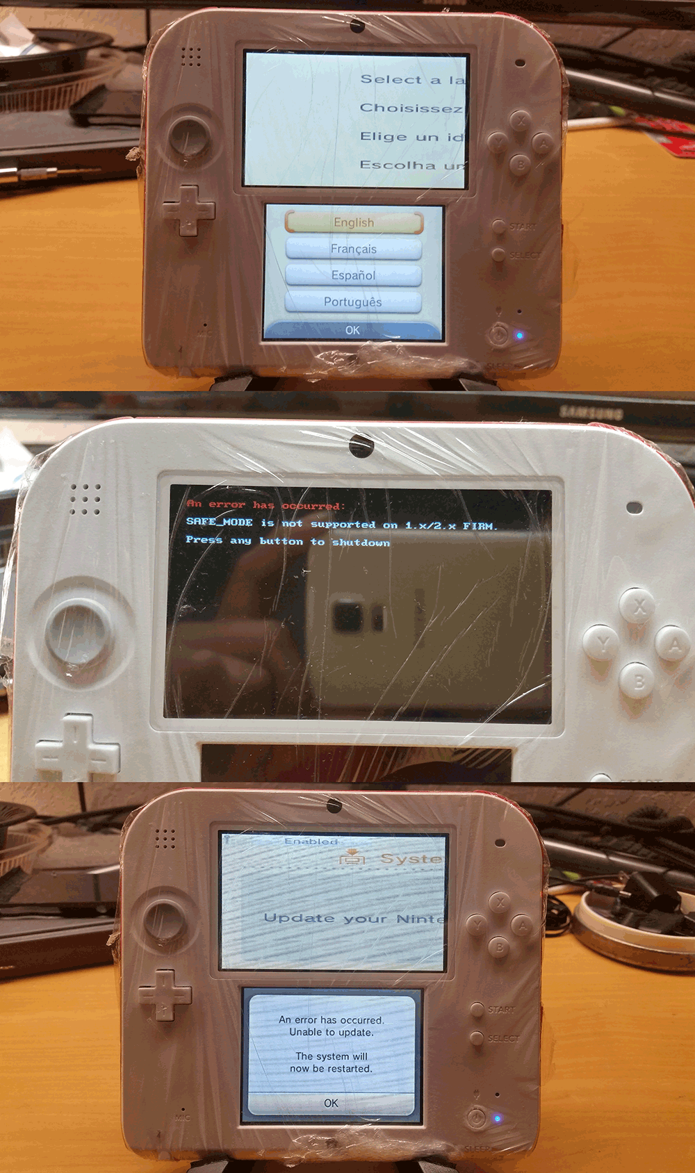

Also, I took a day away from replying to study and gain experience dealing with 2.1.0 CTRTransfer softbricks as my last run-in with very low version firmware downgrade was this:
There are nuances and special considerations when it comes to resolving 2.1.0 CTRTransfer. For those who aren't familiar with the older A9LH custom firmware, 2.1.0 CTRTransfer can really fuck up a n3DS(XL) by MCU bricking from sleep mode and blue screens of death updating on a frankenfirm and foreign o3DS NSCD nand header injection. I wasn't sure what advice would be appropriate for the o2DS, so I did some digging.
After downgrading my (nephew's eventual) 2018 o2DS [newer revision with the WiFi module baked onto the motherboard] with 2.1.0 CTRTransfer, here are the things that can be verified.

  • Updating to the latest 3DS firmware from System Settings does work after you fill out:
    • Profile: User Name, Birthday, Region Settings
  • Leaving the user profile blank will prevent the o2DS from updating with the message:

@Wesleyy, because your softbrick states ARM9 prefetch abort (svcBreak) error, I have a strong suspicion one or more your essential NAND files were erased or corrupted from the 2.1.0 CTRTransfer downgrade using Decrypt9(WIP).
Since standard GodMode9 CTRTransfer didn't work and you don't have a backup of a good SysNAND *.bin image, you will need to resort to CTRTransfer (Type D9) - CTRTransfer.
Unfortunately, I have doubts that the currently available v1.3 of CTRTransfer (Type D9) will fix your brick. From past cases of similar bricks, its code base does not have good handling with garbage and blank files.
However, I'm ~90% certain the (yet to be released) v1.4 candidate script will though. I refuse to publicly release v1.4 at this time because it's not compatible with the latest stable GodMode9 v1.8.0.
