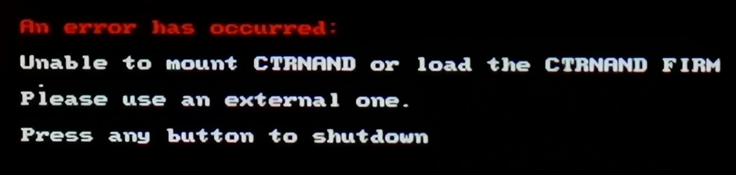

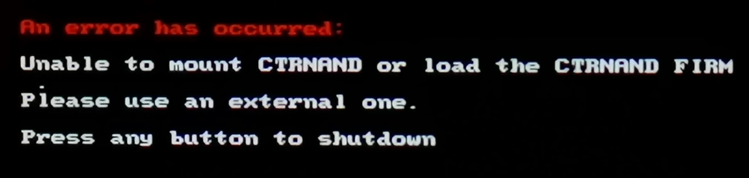

I successfully completed CTRTransfer & CTRTransfer Ticket Copy, but upon rebooting the device (step #23), I get this error:

Oh dang, you're the second person this week that has had this error.
Go from the beginning in following the step-by-step guide found there in posts [9, 11, 13]; you can skip step 9 since you already tried CTRTransfer with GodMode9.
With the exception of step 9, you do not want to skip ahead for the other steps.

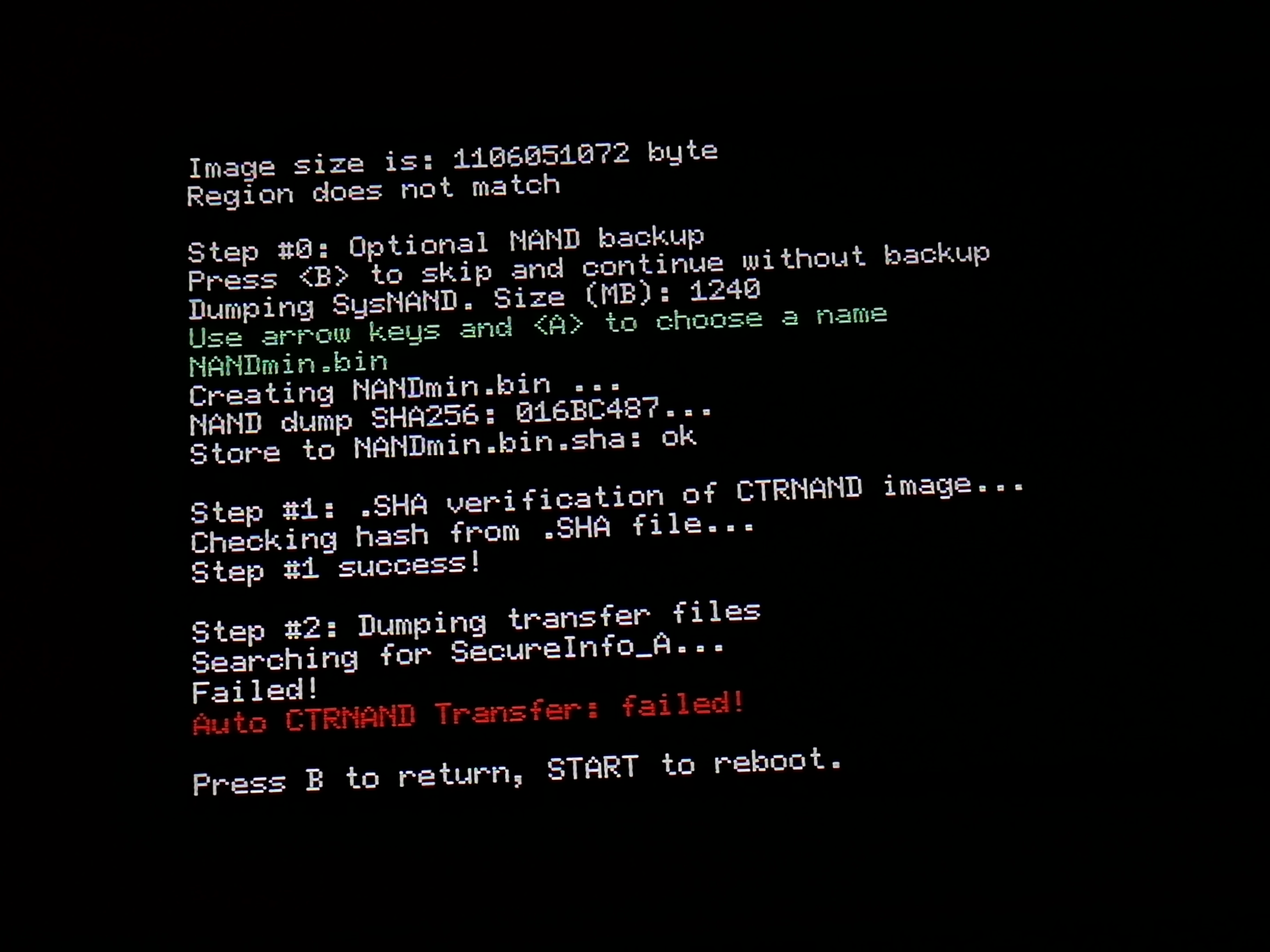

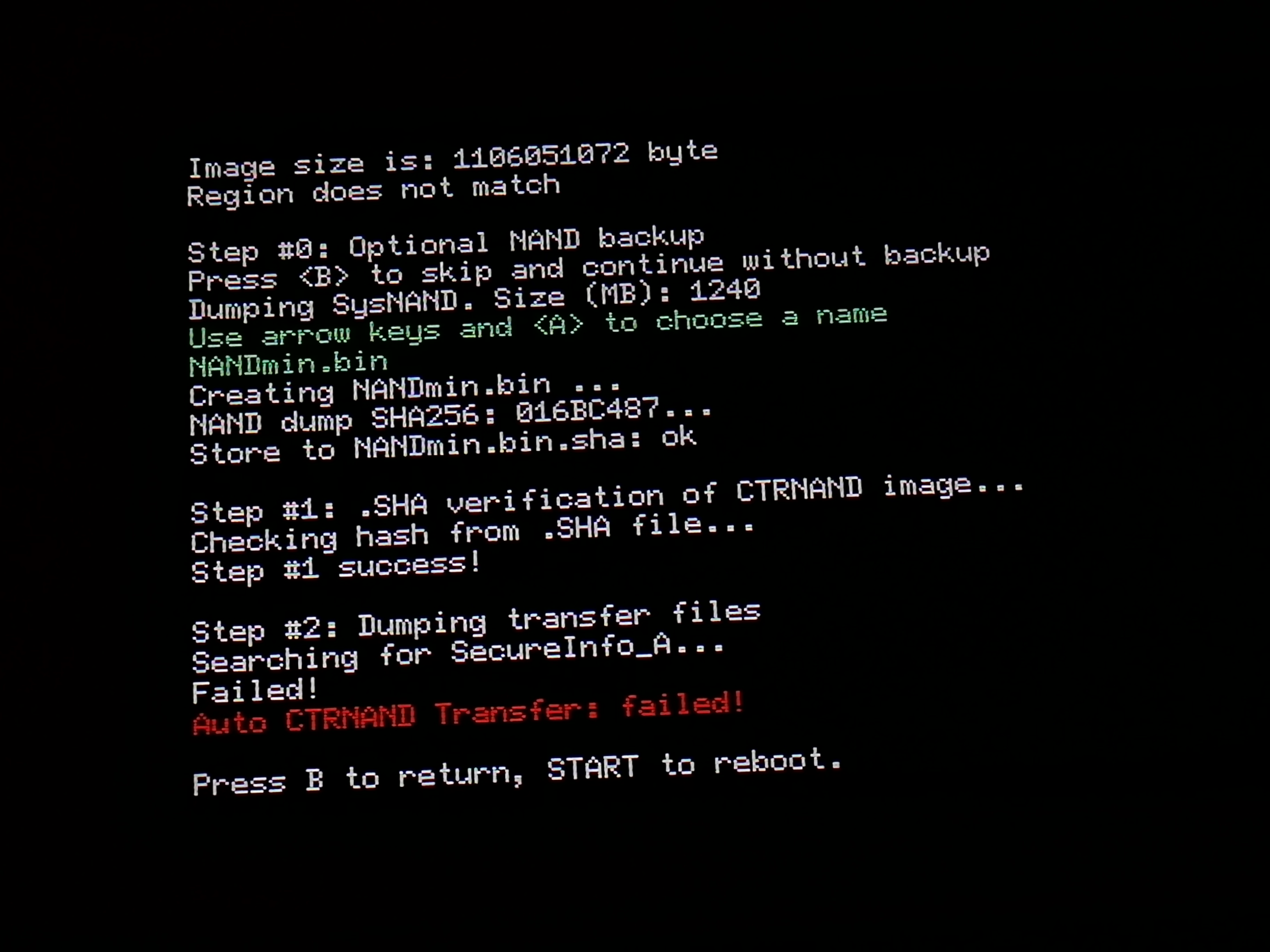

I completed all of the steps up to the CTRTransfer with Decrypt9WIP (step #10). After running the transfer I get this error:
Errh, did you happen to have used the EUR CTRTransfer *.bin & *.sha image on a USA n3DSXL system? My mistake on step 10. If yours USA region, it was suppose to be:

I've seen this failure before helping out someone trying to restore her JPN o3DS that was partially region changed to USA 3DS firmware.
CTRTransfer in Decrypt9WIP won't work if the SecureInfo_A/B at 0x100 offset has a mismatch in region value, or there is no SecureInfo_C to act as substitute. Sorry for that.

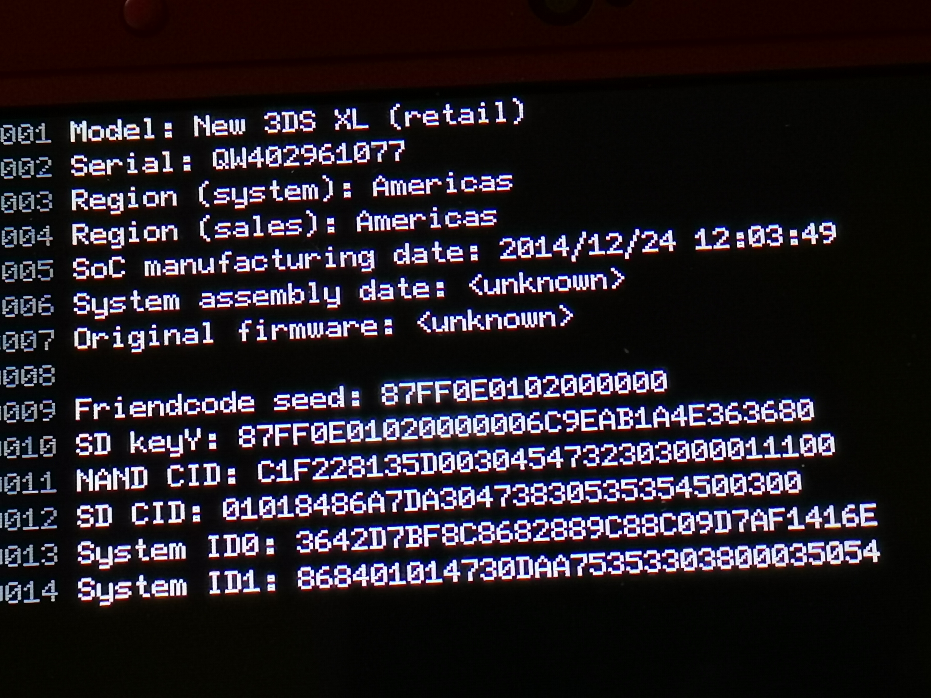

My n3ds is USA, so I didn't use EUR.
system info:
Great, so the error in your first post is expected. Since the new3DS never had a 2.1.0 firmware, one had to be Frankensteined together using bits of old 3DS FW and new 3DS FW. This is the cause of the NCSD mismatch. Your 3DS has an old 3DS NCSD installed due to the 2.1.0 downgrade. CTRNAND transfers don't correct this, which is also why it failed. If you actually have your NAND backup from prior to the 2.1.0 downgrade, restore that. Proceed passed the NCSD error. Restoring your NCSD is what will bring your 3DS back to working order.
