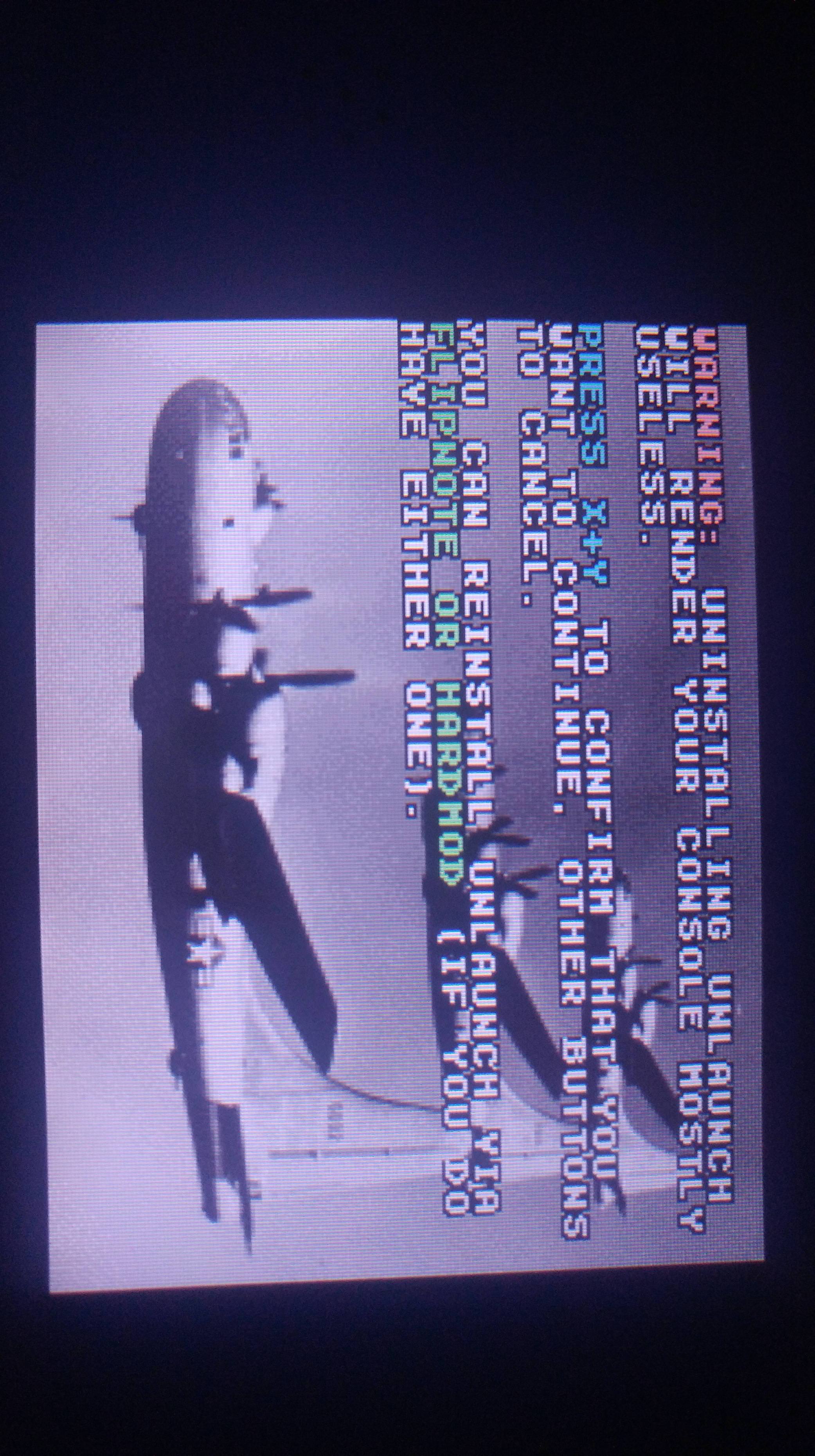

I just want to make sure im doing everything right here, i have unlaunch v1.7, and when i click the uninstall it says this. Should i continue?
Yes, press x+y
Hey my sound is back and no more ugly splash, thanks. I was just kinda worried about the "Mostly useless" message. i think it should be clearer that your homebrew stuff will be the stuff that goes away, not the system itself.

I just bought a ndsi that have a cfw named Unlaunch, i actually dont know anything about cfw and i want to unistall and let the console normal. Is there a way of doing it? I almost clicked in unistall and a received a messege that will make this console mostly useless. Will it brick? please help me
No, it won't brick.
It's just NoCash's way of saying your console will be stock again.
