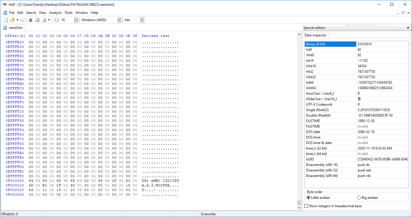

Is there a way to tell if the backup is 1.6 or 2.0? this is what i have
