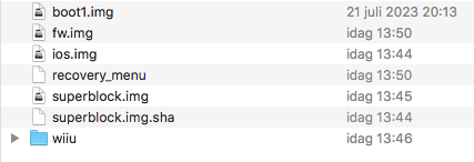

The structure on the SD should look like this:
boot1.img (only for UDPIH)
fw.img
ios.img
recovery_menu   (only for UDPIH)
superblock.img
superblock.img.sha
wiiu
    ios_plugins
         wafel_core.ipx
         wafel_isfshax_patch.ipx

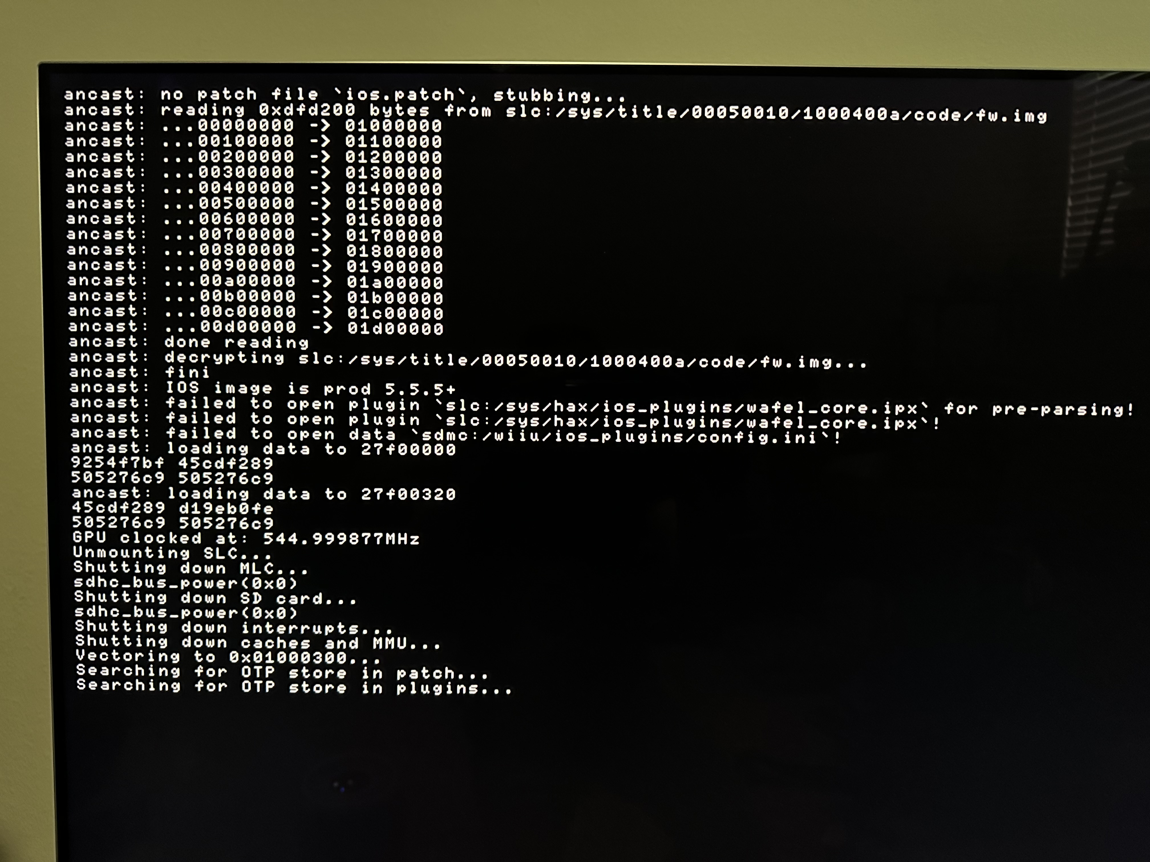

EDIT: I managed to progress a little by going in blindly but the "Booting without SD" part doesn't work for me. The sys directory didn't exist in the /storage_slc, so I had to create it (not sure if I should). I copied the files and followed the instructions but if I select the first option in the minute menu, Patch (slc) and boot IOS (slc), the WiiU doesn't boot.
I think I sorted this out.
If you're using Tiramisu and FTPiiU Everywhere - Storage_SLC that you gain access to is actually /sys folder.

Back again! I was trying to boot
to try testing things from the base system and the boot stops here:
Lapin
Feb 1, 2021
14
136
Belgium
So in that case you just need to create *hax* folder and proceed as normal.
This fixed it, thanks! I still don't have any image when it boots into the minute menu for some reason, so I have to go in blindly, but everything is working perfectly.

Hello,
Iam trying to boot ans istall ISFSHAX using the UDPIH method. But after "Load BOOT1 payload" my console is showing me a red light and there is nothing on my gamepad? Everything works up until I press the proceed.....
Do I have to have it connected to a tv to see the minute menu?
ButtBoyBoris
Jun 16, 2019
36
43
170
Sweden
SDIO
Feb 13, 2023
2,280
28
1,396
Germany
Organe light means there is a problem with the fw.img make sure it is NOT the encrypted one and copy it again to the SD and make sure to safetly eject
