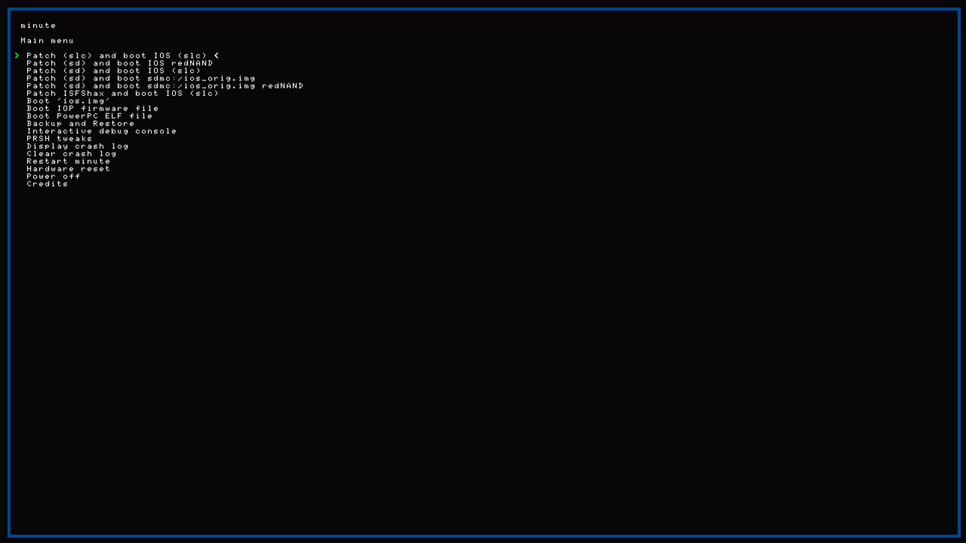

Now you should see the minute main menu. If not, something went wrong. Make sure you have the correct fw.img file on the SD.
In minute you move the cursor with the power button and enter with the eject button (swapped compared to the recovery menu).
ISFShax isn't installed yet! minute is just loaded temporarily and gone after a reboot.
Note: minute only outputs 1080p through HDMI, no picture on the gamepad, and nothing on the analog outputs.
Some people reported that the screen output is not working for them when minute was loaded from the recovery_menu. If you made sure nothing else is the problem (right fw.img, TV supports 1080p HDMI), you can try following along blindly by pressing the appropriate buttons. Make sure to wait long enough between the presses, so the system has time to load. Without display output skip the first backup and go directly to Installing ISFShax.
minute main menu​

For now your Wii U loads minute (fw.img), which then applies the required patches from SD card. (IOSU needs to be patched, so it doesn't fall over the ISFShax superblock).
To boot into the Wii U OS select Patch (sd) and boot IOS (slc) <-- This is the third option, not the first!

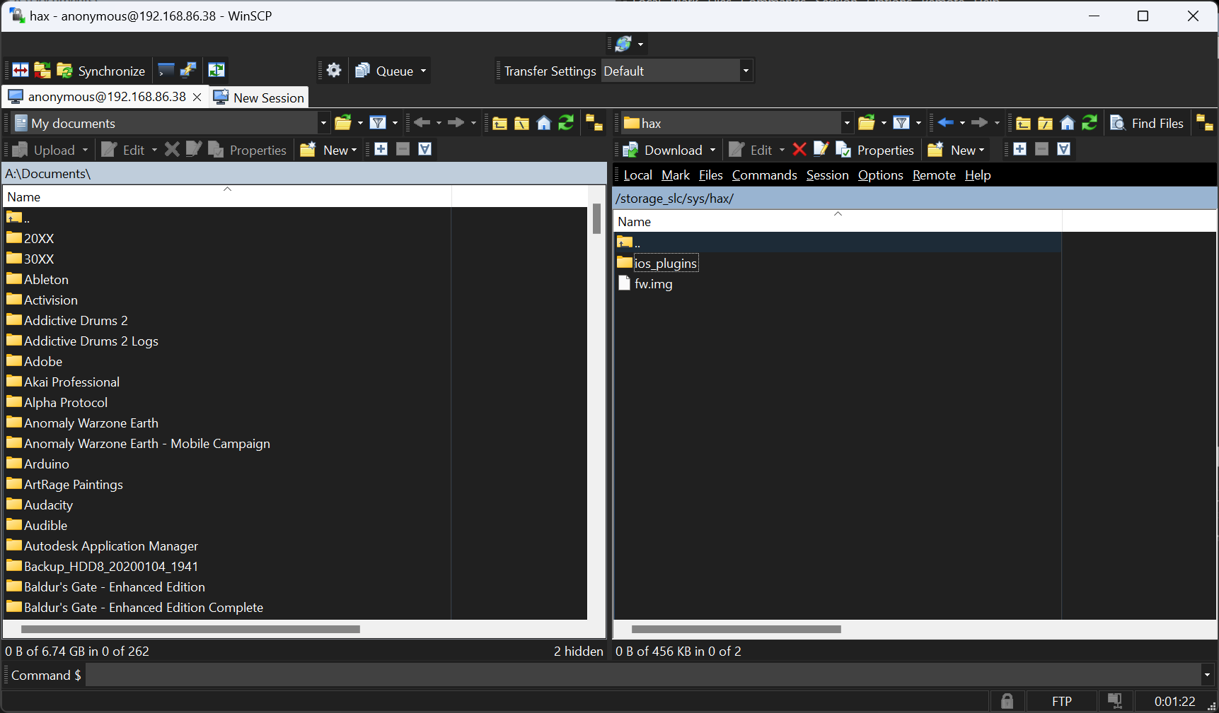

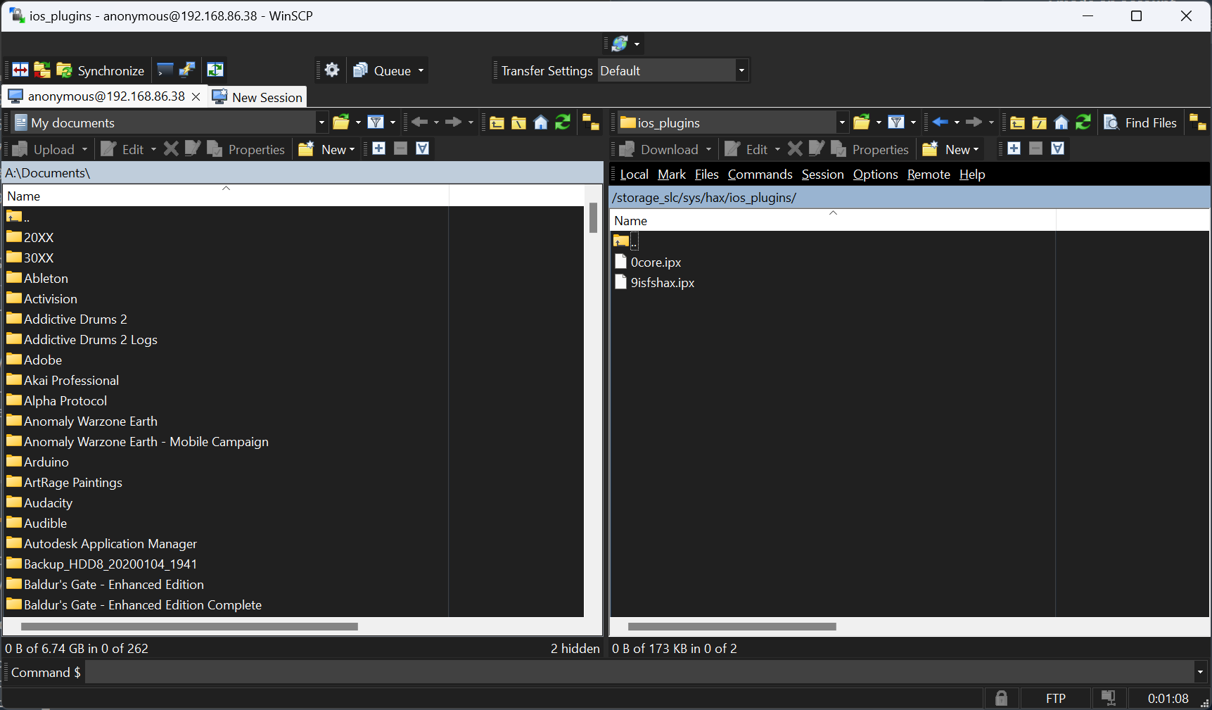

Optional: Installing Plugins to SLC (instead of SD)
Now the Wii U will boot like normal without the SD. To achieve that ISFShax applies a minimal set of patches to the system (to tolerate the ISFShax superblock). Since these patches kept minimal, they are not optimized and some things like leaving the settings will take longer.
To make the full minute+stroopwafel run from the internal memory we can install minute fw.img and the ios_plugins to the SLC. This can be accomplished using FTPiiU Everywhere / the Aroma ftp plugin, which can be launched from Tiramisu and is already part of the Aroma Package (enable Everywhere in the settings) or you can use the haxcopy homebrew. Using haxcopy is recommended for most users.
If you are using haxcopy to update an existing install, make sure that the plugins have the same file name as before, else you might get duplicates, which can cause problems
If you are redNAND user, remove the hax folder and creare a new one and copy the fw.img from the root of the SD into there, before running haxcopy. The hax folder form the download contains the fastboot fw.img, which doesn't work with redNAND. By installing the normal minute and not having the ios_plugins folder on the menu, the Wii U will display the minute menu.
If you downloaded the files from isfsh.ax or used the download script, all the files where already put in the hax folder, so you can skip 1-5. Note that the download uses the fastboot minute (explained below).
  1. create a folder hax on the SD card (this will be copied to the slc)
  2. copy the fw.img to the hax folder
  3. create a subfolder ios_plugins in the hax folder
  4. copy 00core.ipx it to the hax/ios_plugins folder
  5. copy 5isfshax.ipx to the hax/ios_plugins folder
  6. if you want to coldboot aroma or tiramisu, copy the 5payldr.ipx to hax/ios_plugins folder
  7. If you need any other plugins like the wafel_unlimit.ipx, you have to rename and copy it to the hax/ios_plugins folder

Can you show a screenshot of how you set up the files on the slc?
Here are the screenshots. This was done using Patch (sd) and boot IOS (slc)->tiramisu->ftp, which boots up my actual nand. I probably will be able to check again probably after 24 hours since it's pretty late here.
The strange thing for me was that the folders and files were already there. I had refreshed winscp to make sure it was correct. I had retried it and still orange with sd card removed.
Is there an effect if I stupidly did this instruction on the rednand first?
Thanks

I'm having the same issue. I managed to install ISFShax, then replace the fw.img with the non-encrypted one and when I boot I don't see anything on the screen and the gamepad won't connect. I have every required file on the root of the SD and the stroopwafel ones on the required folder. Help.
I saw that you can delete this file SCFM with minute, are you sure it's easy?
No don't delete it. Disable scfm via the ini.
probably it's addressed at minute environment or de_fuse - have anybody tested overclocking the GPU? Question is - is there even any benefit in 3D titles or in 99,5% cases system is bottlenecked by the CPU?
I am not sure if that requires defuse, haven't looked into it. But from what I saw it can improve the performance of certain games like BoW
Try copying the file again. Make sure it is the right (not the encrypted) one. Savely Eject it in Windows, not just remove it.
If nothing of that helps try a file system check on the card (and coping the file again after the check) and if that doesn't help, try another card.

EDIT2: After much experimenting, I did find a way to see the minute menu. If I select the third option, I can enter the WiiU menu, which has Tiramisu installed. Now pressing B while entering the health and safety app I can see the environment loader and from there choose fw_img_loader and now the minute menu is visible. Doesn't sort out the problem but it's a fix.

That's probably a problem with the display init specific to your TV. When you launch it from the fw_img_loader the DIsplay was already initialized by IOSU.
The problem with screenshot would be that they become outdated as I add features.
For each release of minute you can find the commit on left, for the now current release it says 7aeece8 for example. If you click on that it brings you to the commot and there you can cllick browse files. You can then go to the source folder where you find the main.c
In the main.c you find the definition of the main menu, something like that:
            {"Patch (slc) and boot IOS (slc)", &main_quickboot_patch_slc},
            {"Patch (sd) and boot IOS redNAND", &main_quickboot_patch_rednand},
            {"Patch (sd) and boot IOS (slc)", &main_quickboot_patch}, // options
            {"Patch (sd) and boot sdmc:/ios_orig.img", &main_swapboot_patch}, // options
            {"Patch (sd) and boot sdmc:/ios_orig.img redNAND", &main_swapboot_patch_rednand},
            {"Boot 'ios.img'", &main_quickboot_fw},
            {"Boot IOP firmware file", &main_boot_fw},
            {"Boot PowerPC ELF file", &main_boot_ppc},
            {"Backup and Restore", &dump_menu_show},
            {"Interactive debug console", &main_interactive_console},
            {"PRSH tweaks", &prsh_menu},
            {"Display crash log", &main_get_crash},
            {"Clear crash log", &main_reset_crash},
            {"Restart minute", &main_reload},
            {"Hardware reset", &main_reset},
            {"Power off", &main_shutdown},
            {"Credits", &main_credits},
            //{"ISFS test", &isfs_test},
    15, // number of options
    0,
Also note I had set the number of options to 15 instead of 17 in that release, so the menu will miss the last two options.
You find a similar definition of the Backup and Restore sub menu in the dump.c. But when dumping you also have to confirm a few things sometimes. So you would need to look a the code to know when to press which button...
