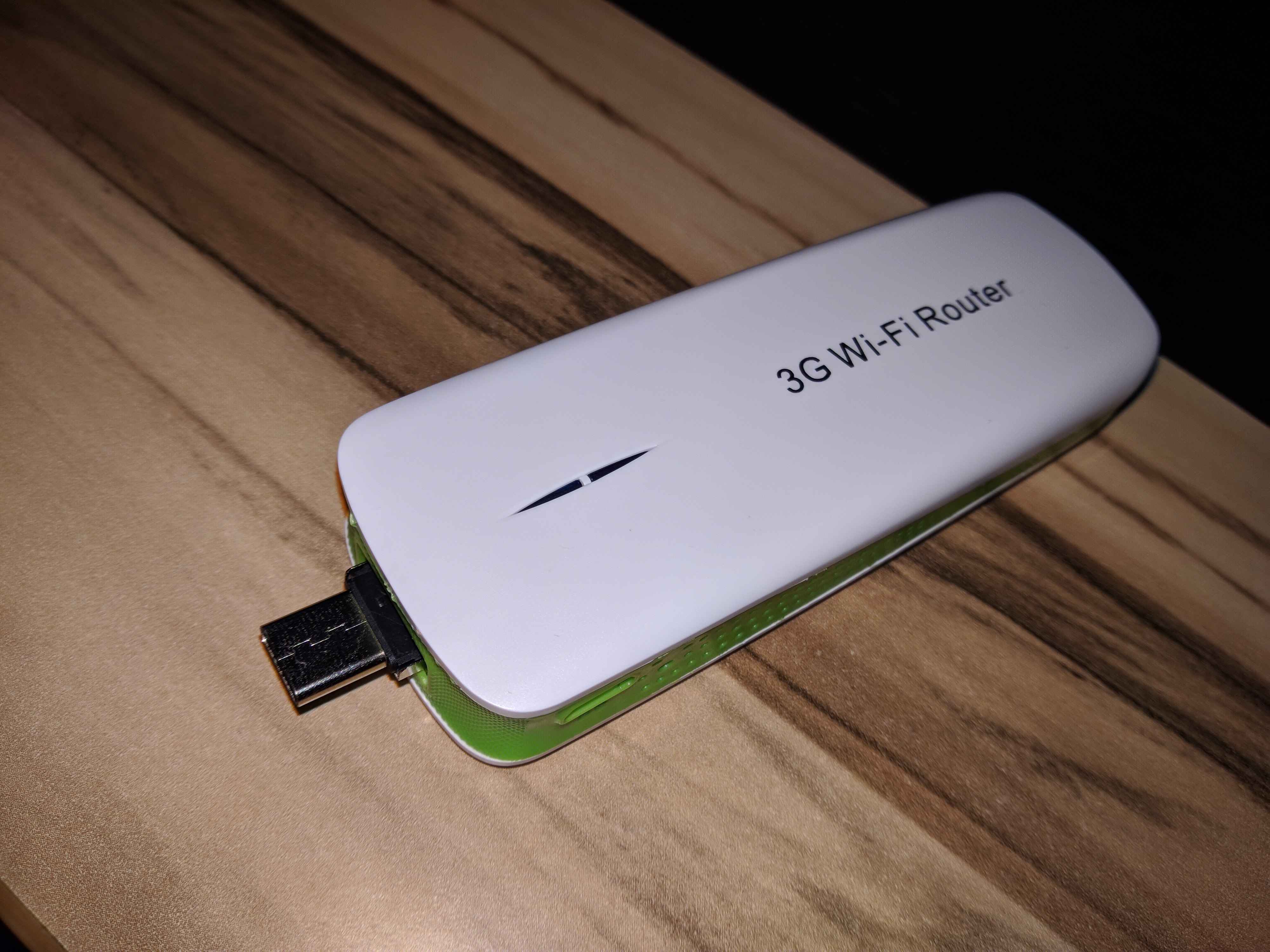

When connecting to the wireless ssid, I am not getting assigned a DHCP address, but a zeroconf one. I assume there was no space for a DHCP server? What is the ip address of the device when connecting via WiFi?
I also assume there is no web UI for the "router" portion, right?
Btw: using a tiny OTG adapter makes this very portable:

After further inspection there is a DHCP server built in but it requires configuring. I'll configure it so wireless functions are always available without ethernet and include it in the next release.
From aliexpress: https://www.aliexpress.com/item/Pra...sk-OTG-Converter-Adapter-For/32849739833.html
You might find cheaper ones as well, that's the exact one I bought.
The adapter sits in somewhat loosely so when I unplug it from the switch it stays in the console and I have to pull it out separately. I am thinking about fixing it in place with solder or some glue, but that would prevent me from easily changing the payload.
I got some of these too and I'm not sure how you got them to work. I can't seem to get them to work with this because of how loose they are (which is because of how the usb plug on the dongle sits, not the adapter itself to be clear).
I just put it in and it works. But come to think of it, I can see how some adapters might not work because they are too loose.
After all, they are designed to be plugged into the front of a male usb plug and the router has a female USB port.
Gesendet von meinem Mi A1 mit Tapatalk
Yeah. I'm just going to get a short cable to plug the adapter into...I imagine that will do just fine. Maybe not as elegant, but it's not worth worrying about it.
