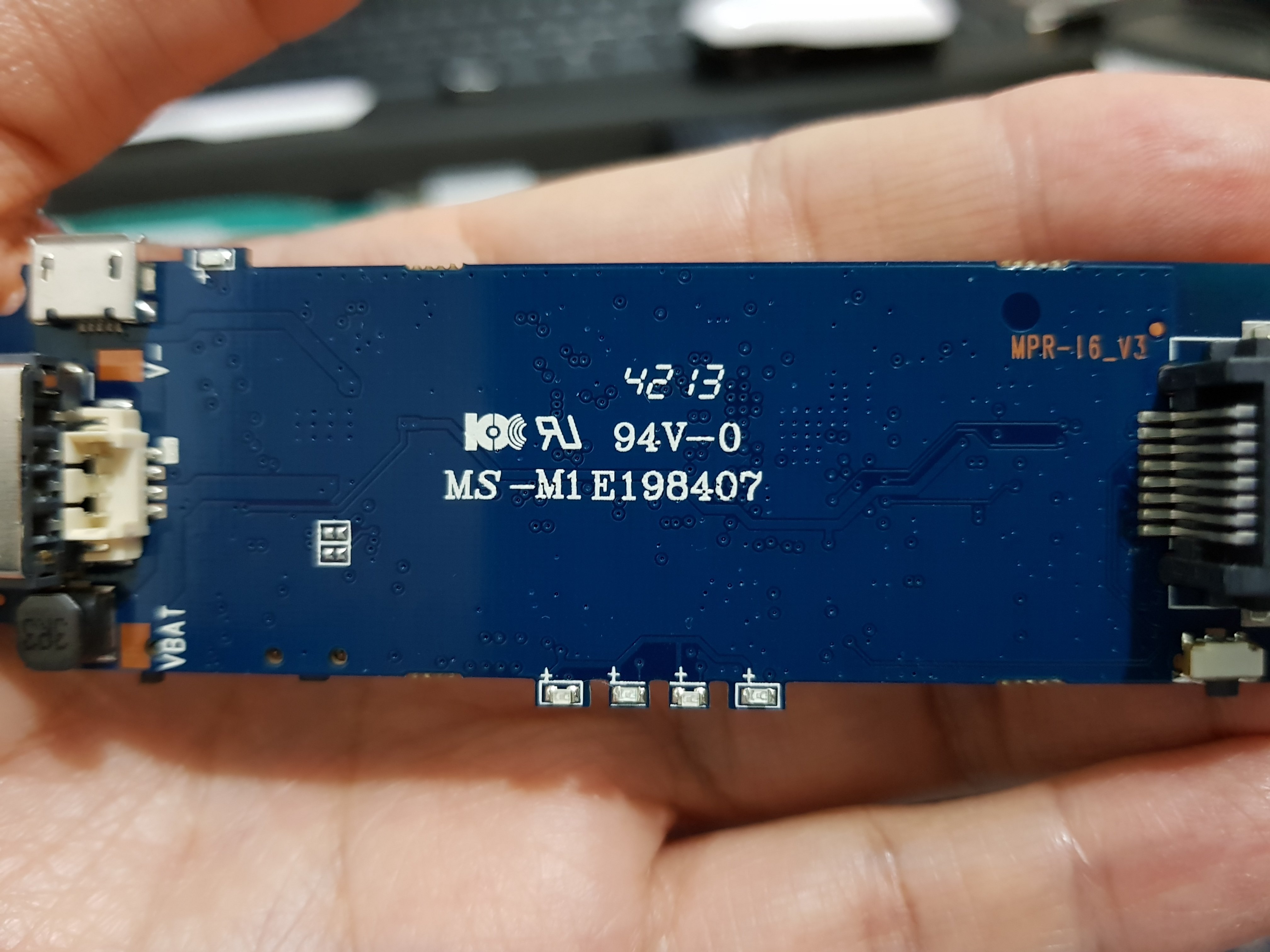

so i bought a battery powered clone of this router
the stock firmware wouldn't allow telnet login. i updated the firmware using the manufacturer provided file. still no telnet login.
both versions wouldn't allow to flash the openwrt firmware using the webpage upload.
so i found another firmware that allowed telnet login, but then i found it wouldn't recognize usb storage and, again, wouldn't accept the openwrt file using the webpage upload method.
finally i found another firmware that would be my final solution. the router accepted it, considered it valid, then... brick.
my only hope is to flash it using the serial/uart method.
i found ground and vcc (3.3v) points on the pcb.
could someone please point me tx and rx points? my pcb is a little different from the ones i found online.
