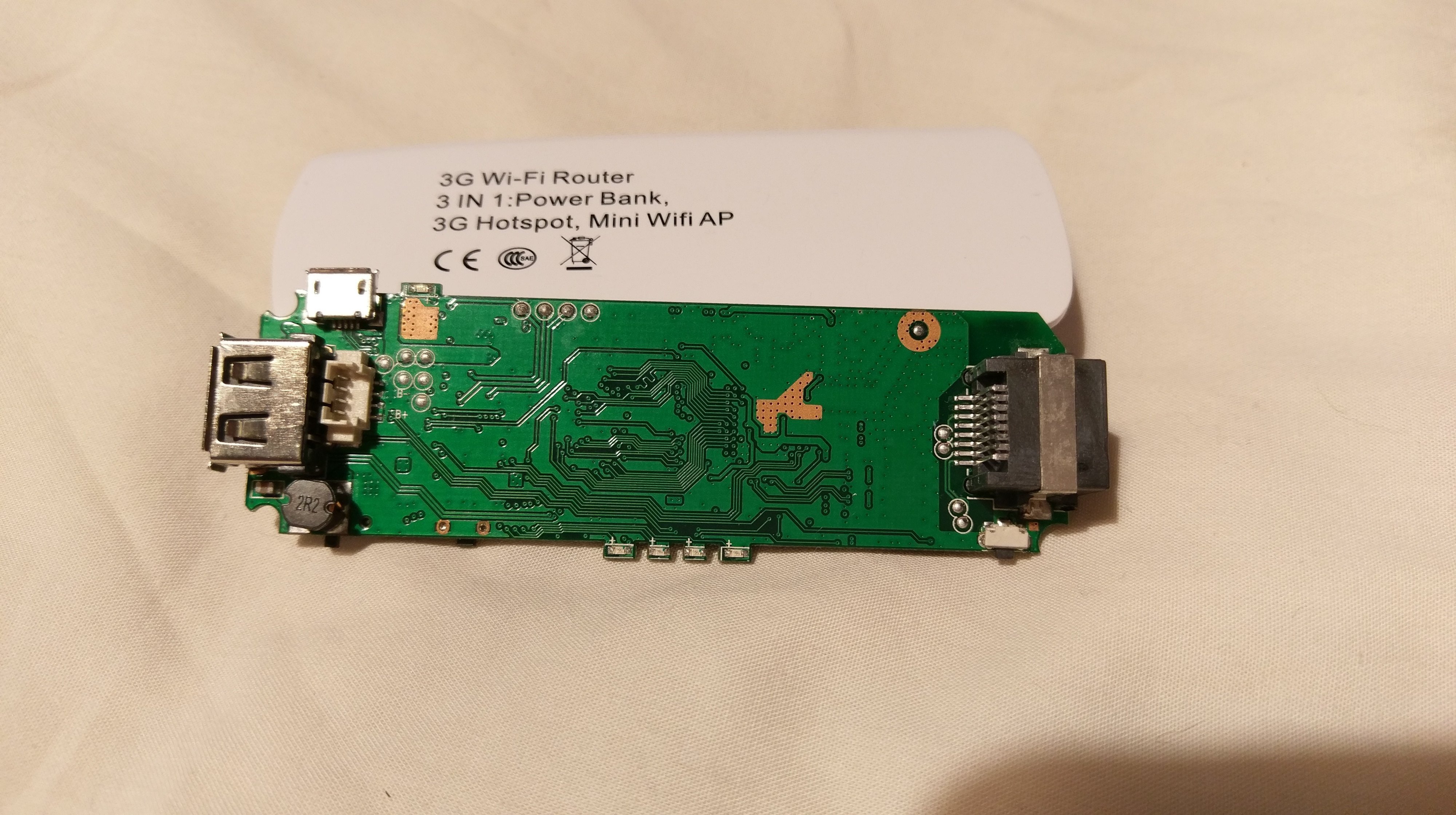

I compared your image to the one found on the openwrt page for the a5-v11 hardware. Their teartdown pics show that there should be a serial interface that is covered up by the green lacquer on the other side of the PCB. Here is a hotlink to the image in question:
you would need to scrape off the lacquer on the TX and RX pads, and scrape off a portion on the ground plane, then prime the surfaces with a small dollop of solder, then attach some jumper wires.
Could you verify that those pads exist on your hardware?
I think they do - however I'm not going down that road, waaay to tedious. Please see picture FYI
If there is a serial debug port, then we can get the /etc/passwd file, and run it through something like jack the ripper to get the default root password for these devices. The presence of the header is kinda required to get that out of the device though. Sadly, GBATemp is either super busy right now or something, as I cannot load the large version of your image at this moment.
*edit
It finally loaded. Those 4 solder pads along the top look suspiciously like a serial debug interface. I would have to go over the top of them with a multimeter checking for activity to see which ones are +3v, TX, and RX. The last one on the right looks like it could be GND.
