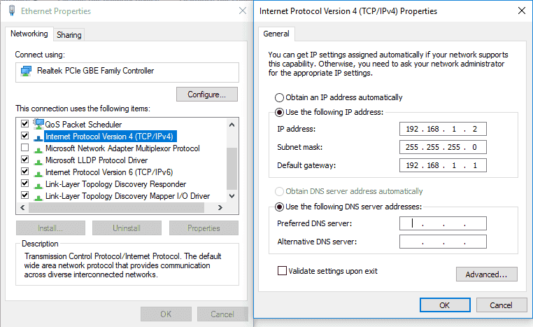

Can anyone give me a hand with this? I've gone through the steps and the dongle does not work at all (no LED, no payload injection, and the ethernet port has stopped functioning as well). Is there anything that can be done?
brick?... whoa..
Very good idea, i was just sharing my personal experience and compiled file, i'm not very good for explaining.
okay, should I just make new thread and point the credit and download for the file here?

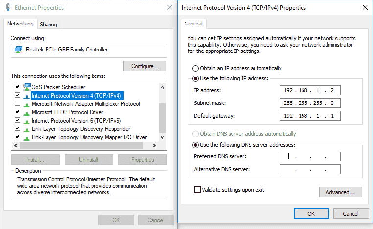

Temporarily change your ethernet settings to manual as in the attached image and see if you can get a response from the dongle through SSH (port 22) or Telnet (port 23).
Failing that you can attempt to reflash by inserting a FAT formatted usb drive containing a stock or custom firmware.bin, and holding the reset button as you turn on the dongle.
If still no response, you've probably bricked it somehow. Maybe incorrect bootloader.
brick?... whoa..
Vefore anyone panics, let me reiterate that this is a problem with the dongle, my switch is fine. I must also admit to not knowing whether this is a brick or something else. I'm technically stuck at the change the ip to *.*.*.2 step since I can't connect to the dongle anymore.
edit.
If still no response, you've probably bricked it somehow. Maybe incorrect bootloader.View attachment 134490

Well that didn't work either (thanks though). However after opening it up I'm fairly certain that it got damaged (physically) somehow. Either in the mail, or before it left the factory (there are some loose solder joints, hell the reset button had actually come loose). I guess it completely broke down when I was making my attempt.

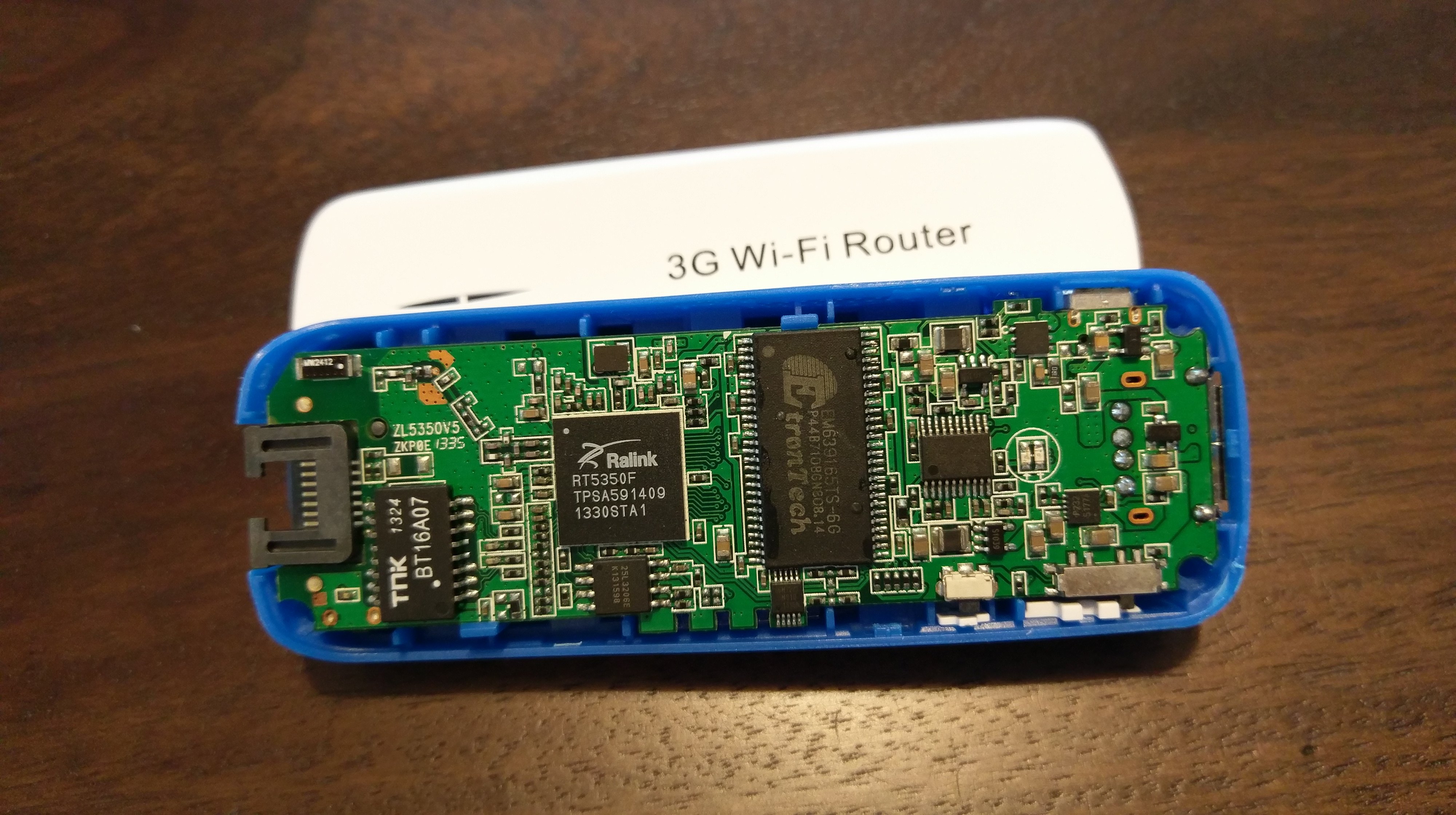

I have been digging into the "WD LOGIN" variant, and found a site about hacking these devices that is in Russian, where they discuss the devices briefly. Sadly, they suggest that this model ALSO lacks a serial debug header. If you would be so kind as to validate this with a disassembly of your affected model, it would be great.
Just gently disassemble the shell, and take a good quality photo of the board, and upload it, if you can.
But of course :-D
Man I love your dedication, russian hardware hacking sites are not your average Joe's source of info :)
If you end up finding the login, I'd be sooo grateful
