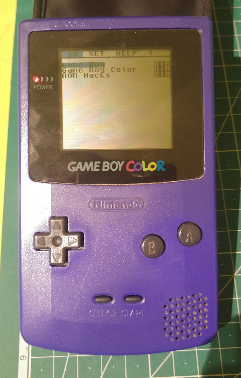

Perfectly working here, on a non-sufix GBC.
For all of you having problems, copying the update to the SD is no enough, that only updates the kernel, for updating the FW (which is where the problem resides), you have to run Update_FW5.gb.
Of course, that requires another working console (another GBC or GBA). If you don't have one, I'm afraid you are on a dead end.
