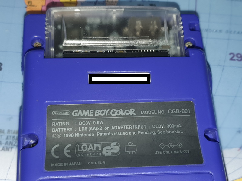

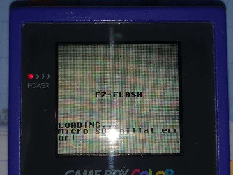

Unfortunately not. At least not at mine.
Kind regards,
Helge

Did not work on my non-suffix Gameboy Color
