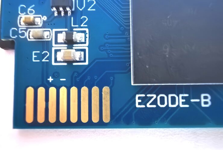

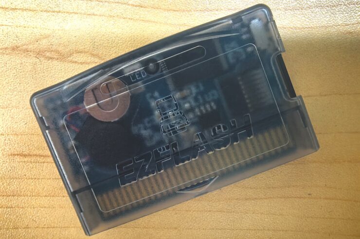

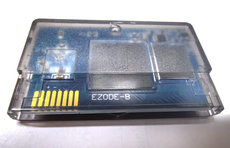

A page has appeared on the official EZ-Flash website with a new product called EZ-FLASH OMEGA Definitive Edition B. As I understand, all the changes relate to memory and the ability to manage NOR memory.
I wanted to ask EZ-Flash2 if there are any other changes in the new revision B.
And will there be a version of the cartridge with sensors (UV, gyroscope, accelerometer)?

Do you mean this?
This post is dated 2022 and it talks about the "new" revision, called "B", that was born because of the chip shortage in covid era.
There's no difference between Rev A and B in terms of features.
The newest product (cheaper than Omega DE, but worst in term of performance) is the EZ Flash Air. It uses a different architecture than previous products, it only has SD and NORFLASH, games need to be written to NORFLASH in order to play.

‘ B version new features
512Mbit+960Mbit Directly run ROMs up to 512MBit (previously limited to 256Mbit). More space for flashing on NOR (previously limited to 512Mbit)
NOR Management Freely delete and re-burn ROMs (no need to delete starting from the last ROM) Check NOR usage in real time.’
Here is a comparison table from the ezflash Chinese community.
In short, compared to ezode revA and ezode revB, ezode-B increases the PSRAM size to 512Mbit (64MByte) and the Norflash size to 960Mbit (120MByte), the same as ez Air.
This allows 512Mbit (64MByte) official video ROMs to boot directly from PSRAM mode without needing to be burned into Norflash.
Meanwhile, 256Mbit (32MByte) games can now support cheat codes and soft resets (previously only some configured 32MByte ROMs supported this).
Norflash now supports free sequential deletion of ROMs, without having to start deleting from the last ROM. After deletion, you need to switch to the file manager page and then back to refresh the Norflash interface to check the current game status.
A new function has been added in Norflash mode: pressing the start button to view the Norflash space distribution.
Furthermore, for unofficial device——analogue pocket, the firmware compatibility of ezode-B is currently the same as ezode revA, and it does not yet achieve the same compatibility as ezode revB and ez Air.
EZ team prioritizes the stability of Nintendo's official consoles. May future updates can optimize support for analogue pocket.

The letter "B" in ezode-B may mean "Blue", not only the new motherboard is blue, but also the update kernel file from officical web is named "ezbluekernel.bin"
Added more:
oh, the name is just shown on flashcard screen——Rev.BLUE

Like others have mentioned, mainly the difference is that PSRAM increased to 64MB (512Mb), and NOR increased to 120MB (960Mb), so now games larger than 32MB, and GBA videos, can run directly from PSRAM, no need for NOR anymore. This really makes it THE perfect flash cart for GBA, period. It's got everything now.
I also read somewhere else in Chinese internet (link below), that there's some change in the hardware. They dropped a MCP chip, where firmware were previously stored. Now the firmware is in NOR, that's why it's 120MB. It's actually a 128MB chip, but 8MB is taken by firmware, so only 120MB is available for flashing games. I just checked their webiste, the 1.0 kernel is released for this new cart. It's pretty exciting.

I also read somewhere else in Chinese internet (link below), that there's some change on the PCB. They dropped the MCP chip, where firmware were previously stored. Now the firmware is in NOR, that's why it's 120MB. It's actually a 128MB chip, but 8MB is taken by firmware, so only 120MB is available for flashing games. I just checked their webiste, the 1.0 kernel is released for this new cart. It's pretty exciting.
https://www.omega.im/922/
