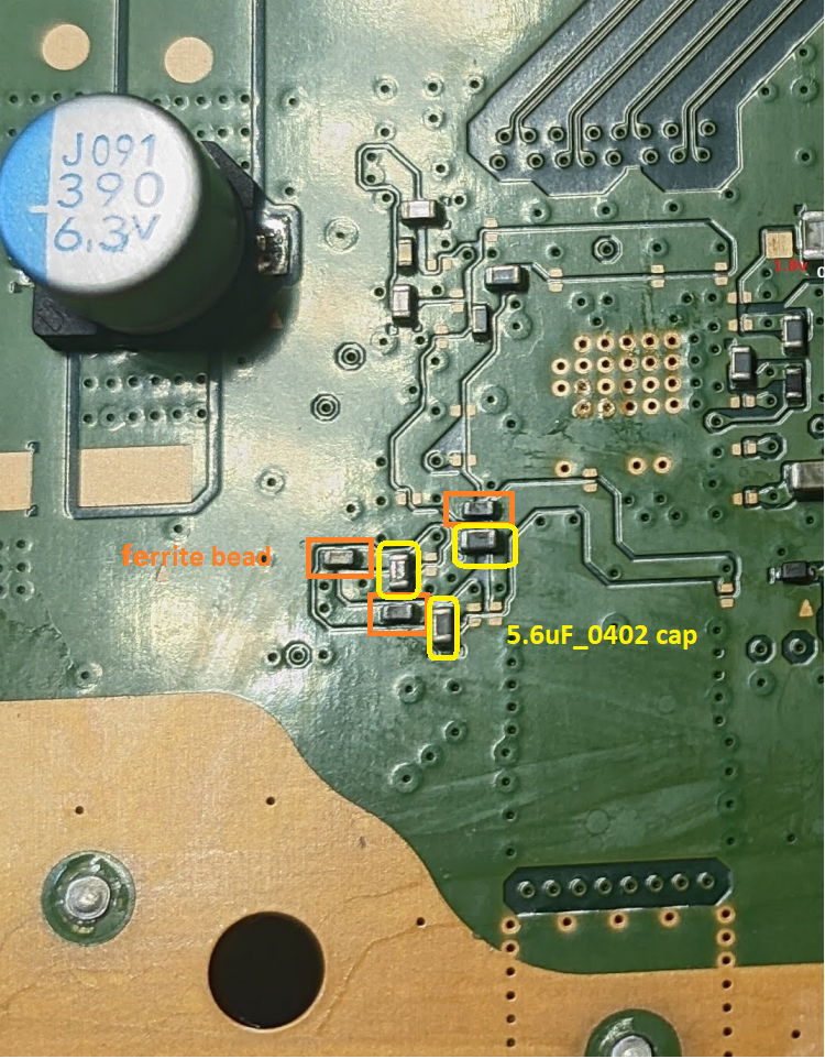

Hi,
I would like to fix ps5 board with missing components. They are missing near HDMI port, but on the opposite side of retimer. Looking at pictures of other boards (there are little of this edm-030) it should be 3 caps and 1 resistor. Thanks for help!

I think they should be same components from EDM-010 or 020 board since the circuit has no major change around HDMI encoder MN864739.
Orange is ferrite bead/inductor, so the value is unknow since no easy way to measure.
Yellow is cap, same value measured at 5.1uF and should be like a 5.6uF 0402_6.3v MLCC

Thanks, that worked :)
