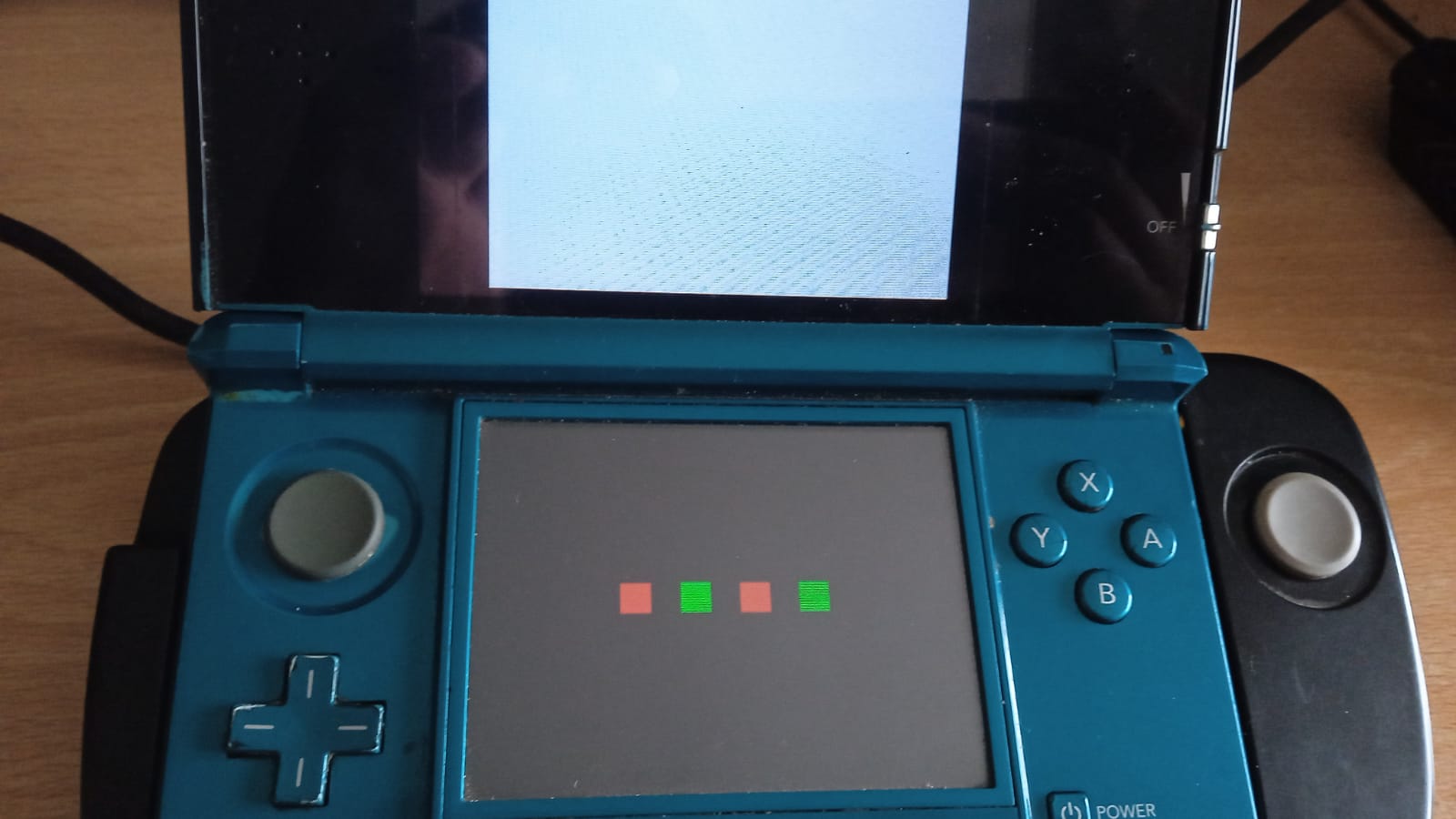

hi, i recently discovered that twilight menu can boot into flashcards, i tried with my "new r4itt purple screw" but i always get this:
searched on internet how can i solve it but i see other pattern on their posts, like a yellow square on the third one, or all red except the last being green etc
Edit: i forgot to say that twilight menu and nds bootstrap are updated
Edit 2: i found on github issues that someone had a problem with this card, but it has another pattern and the r4 icon is a japanese game in my case

I have this problem with my R4 3DS Gold sometimes... seems to be a problem when it is not making perfect connection. Cleaning the contacts and reseating the card properly solves the problem for me.

I think that flashcard is known to not work.
