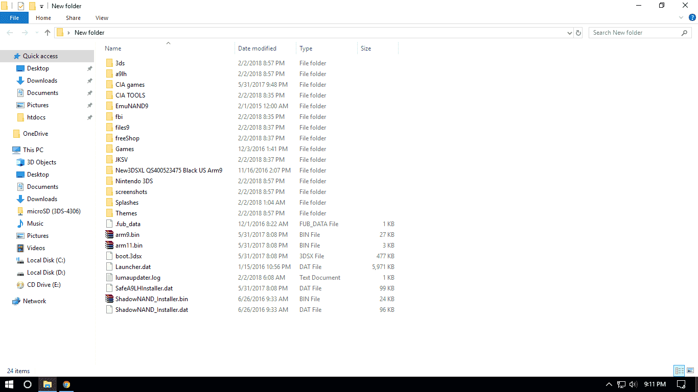

So I bought a 2nd hand N3DS XL with cfw installed with it. The problem is even the seller doesn't know what cfw is installed...
It currently runs on 11.9, it can boot without the sd card, and pressing select on boot does nothing and boots normally... Can anyone help me to identify which cfw is installed and how can I update it to b9s?? I've attached the sceenshot of the SD card for info...
Try putting arm9loaderhax.bin from Luma 7.0.5 on the SD card and see if you manage to get something to show when you hold Select on boot. If not, have a look in CTR NAND in FBI and see what files are there and report back.
Adding the arm9loaderhax.bin does nothing... Here's the CTR NAND content

Only 2 folders. "shared" and "sys". Shared is empty... I've attached the contents of sys folder
That's weird, and it boots up without the SD card in? I don't know anything about shadownand which is what I think you have, try reading the thread to see how you can get rid of it and move to normal Luma: https://gbatemp.net/threads/shadownand.431718/
