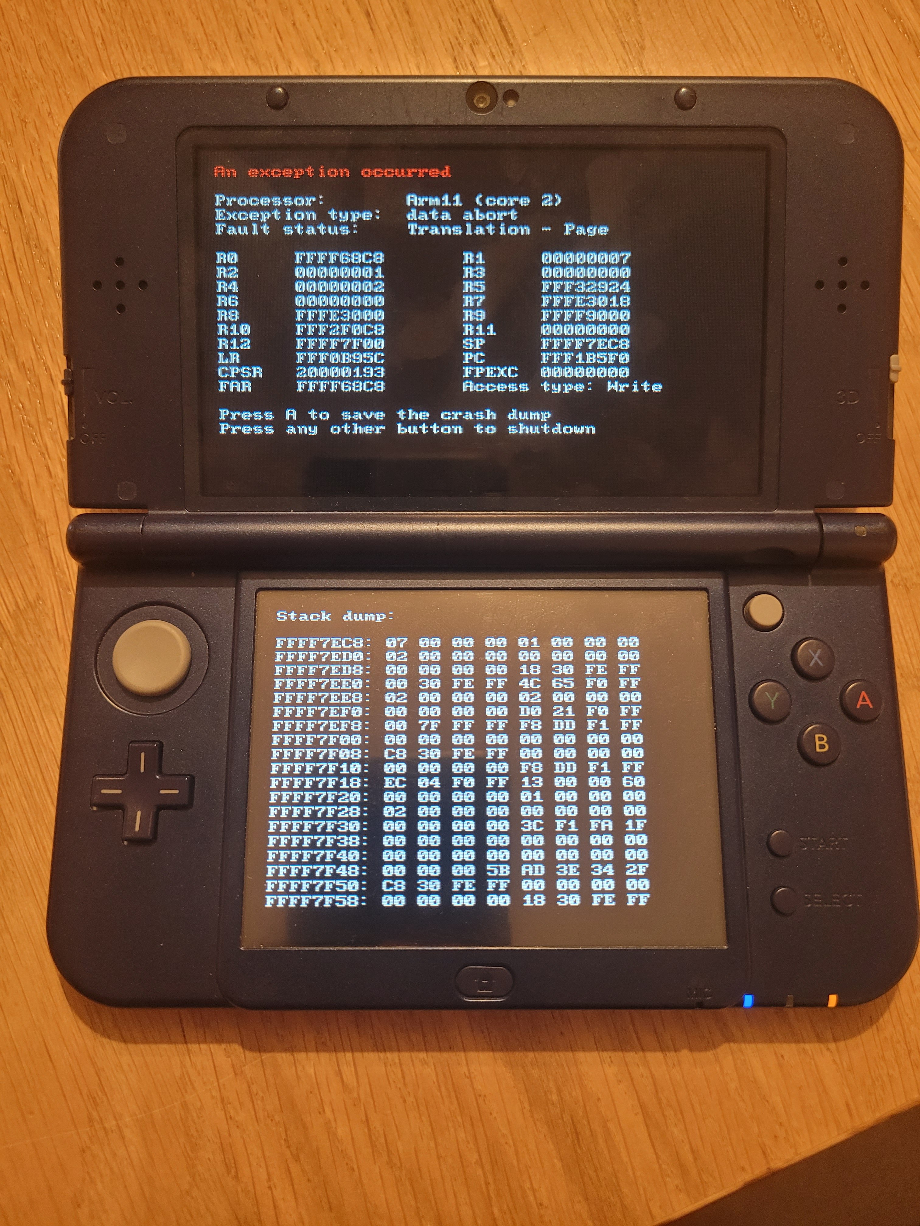

I was using my 3DS, when I got an error screen, I restart my 3DS but the message appears again and again.
Every time I try to connect this error message appears, even without the SD card, it continues to give the same error.
this is the error:
Processor: Arm11 (core 2)
Exception type: data abort
Fault status: Translation - Page
Register dump:
r0 ffff68c8 r1 00000007
r2 00000001 r3 00000000
r4 00000002 r5 fff32924
r6 00000000 r7 fffe3018
r8 fffe3000 r9 ffff9000
r10 fff2f0c8 r11 00000000
r12 ffff7f00 sp ffff7ec8
lr fff0b95c pc fff1b5f0
cpsr 20000193 dfsr 00000807
ifsr 0000100f far ffff68c8
fpexc 00000000 fpinst ee000a00
fpinst2 df5fdf6c Access type: Write
and this was the log generated by ctrchec:
---240102 181727---
Information: You have a stock NAND header. (N3DS)
Information: GodMode9 and Luma3DS are in the NAND.
Information: b9s v1.4 installed to firm0.
Information: b9s v1.4 installed to firm1.
I also updated my luma to the latest version, and I can still access luma and GM9.
Any help will be appreciated, thanks.

Did the error message tell you what the "current process" was?
Unfortunately not, this is exactly the screen:

Did you have a custom theme installed?
Yes, but I already tried delete the 3DS/<ID0>/<ID1>/extdata/00000000/000002ce (mine is EUR), and the 00000098 as well, and remove the extdata by GM9Megascript, and didn't work.
But if you have other thing I could try about that.
ghjfdtg
Jul 13, 2014
1,360
3,282
Does your camera work? Core 2 sounds like it could be head tracking (qtm). Otherwise recently Luma got a feature that can move some game threads to additional cores on New 3DS/2DS but it's not stable for all games. Turn that feature off.

Well, if all else fails, there's always a CTRTransfer.
I already tried this as well, It didn’t change my situation much.
At the end I still with the same problem.
Was woking before, now I can't test.
And this option is already off.
It is more likely that someone will be able to help you if you provide details. What, exactly, did you do? What do you mean by it didn't change "much"? Did anything change at all?
Which option?
Which option?
Ok, first I tried this: https://3ds.hacks.guide/ctrtransfer.html
But because I can not access the home menu I follow this other one, which I don't need access home menu: https://wiki.hacks.guide/wiki/3DS:CTRTransfer/Manual
After I finish it still had the same problem, but now when I start without the sd card a white light flashes and a black screen, nothing else happens.
(But right now the error screen came back I not sure why it changed)
And the option was the one ghjfdtg was talking about, which I believe be: Redirect app. syscore threads to core2.
Which is already off.
anriquegame
Jan 2, 2024
14
24
75
A white light without an SD card indicates that Luma was not copied to the NAND. I'm not sure if CTRTransfer removes that.
https://github.com/SciresM/boot9strap/releases
Did you follow https://3ds.guide when you hacked your unit?
What if you use a fresh SD card with nothing but boot.firm and boot.3dsx on it, as per https://3ds.guide/restoring-updating-cfw ?
I don't remember much because at first I followed a tutorial on this channel: https://youtube.com/@antonretro?si=ZNjrkuV8_iazCdUm
But after some problems, I think, I followed this tutorial that you mentioned.
About sd: No it still doesn't work, in fact recently my 3ds is giving a black screen instead of the error, and when I did this with a new sd only with luma it gave me this black screen.
