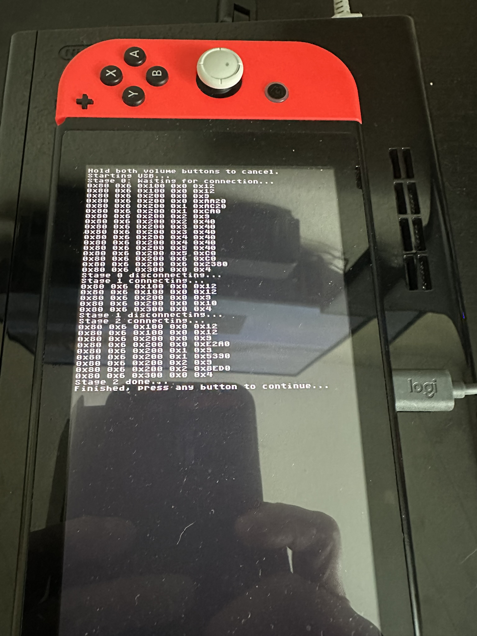

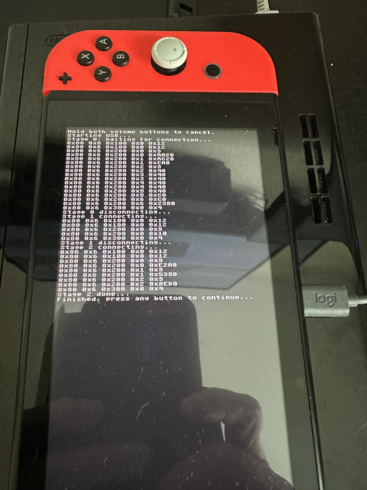

This method has unfortunately not worked for me. I have the same exact issue, black screen, wiiu gamepad is not synced. I ran the script, it completes with error and shows finished, but nothing appears on the Tv screen. I have also tried the other recovery menu that is supposed to output a log file to let me sync the wiiu gamepad, but it never writes anything to the SD card. Not sure what else to try at this point.
I have tried different TVs, HDMI cables, and even used the analog video cables. Anyone happen to know what else i can try to get this thing working?

So I’m having a similar issue, I tried the udpih but nothing, my Wii U is powering on, no screen, and when I try to power it off on the console it won’t power off, also the game pad does power on the console which tells me they are synced but I get a “no connection” message on the game pad, I’m kind of at a loss here if anyone has any further advice
I’m having sort of a similar issue, no video output to either port av or hdmi, however I’m experiencing that the game pad isn’t synced yet the pad powers on the console which tells me there is a connection, also when I press the console button to power off the console nothing happens, I have to unplug it, I tried the pico drive but no luck, does anyone have any suggestions or experienced what I am, one last thing the console was mint in the box with the plastic still on it so I’m pretty sure it’s not a hardware failure
