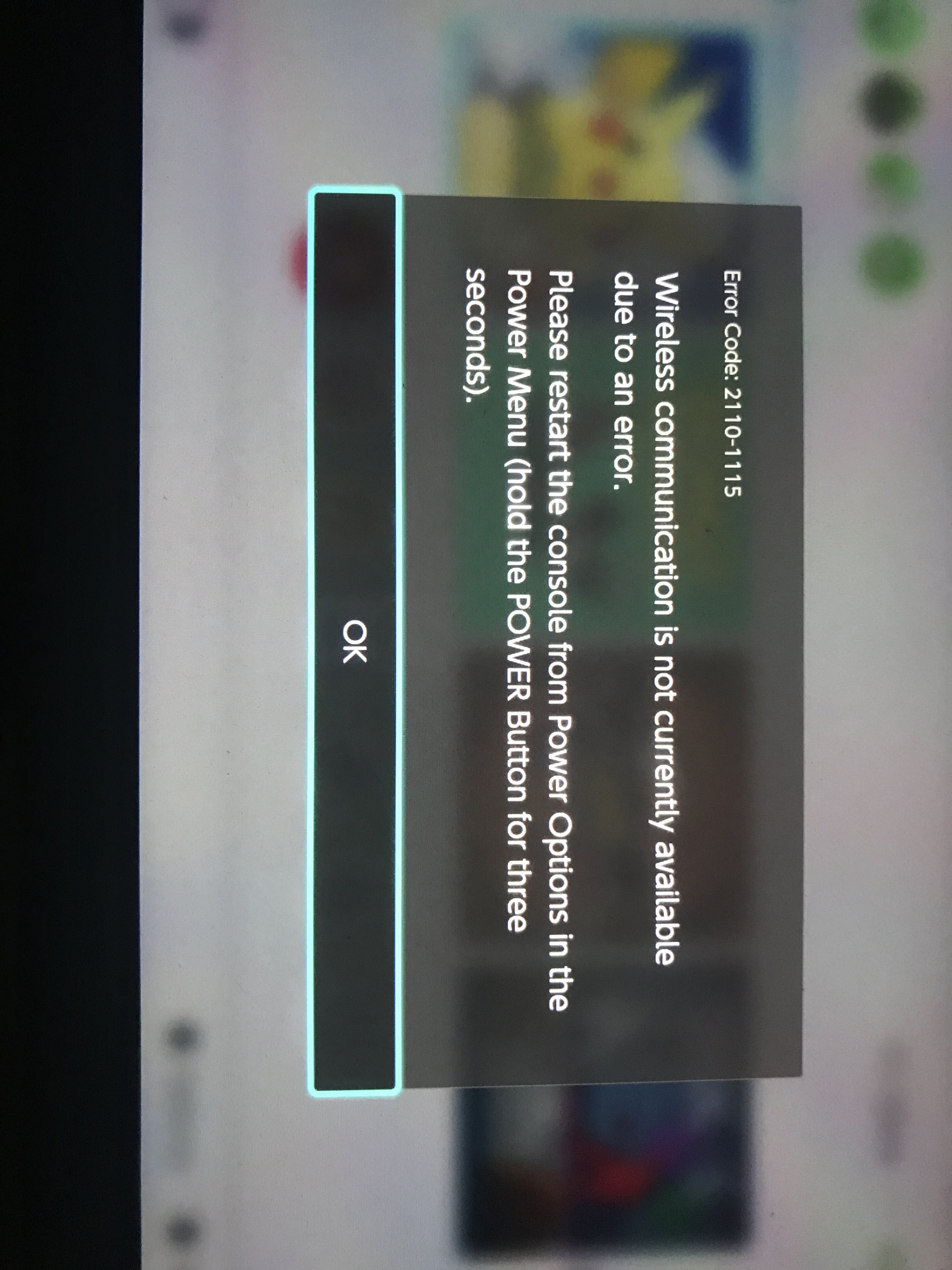

I have a switch lite that has the error 2110-1115. I’ve rebooted it and initialized keeping save data and it didn’t work. I pulled the battery and it still didn’t work. I let the battery die, and when I charged it, wifi started working again. Unfortunately, after another reboot it has stopped working again. Anyone have an idea of how to fix it? Its already up to date

after a day or two without a battery the wifi can work only once and if you stop the switch then the wifi gives an error.
change wifi chip. it's same on switch v1 ,I searched for a long time!! because on my switch error is on boot. not in hos.
