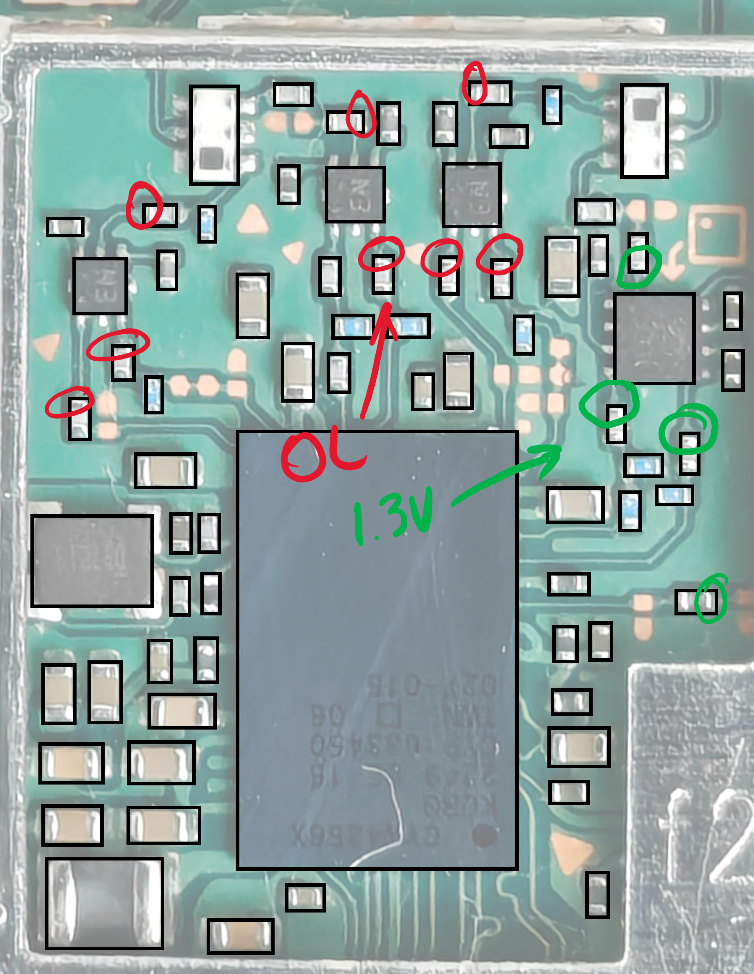

Hey everyone,
Bought a faulty OLED Switch to try to repair. When it was received it was just getting an orange screen which from a bit of research found out it is a wifi issue. I swapped out the Wifi IC from a donor board and I was able to boot up. The issue now is that it is not detecting any broadcasted network and or connecting to any network. Got 2110-2100 initially, reballed it just in case and soldered. Still same issue; I plugged it into a nintendo dock and updated it via ethernet. And got a new error code 2110-1118 when attempting to connect to wifi.
I started measuring all diodes from a working nintendo switch oled, everything checks out around the IC and found out that these are the issue points which can lead from somewhere else. I have OL when it should be reading ~1.3V. The only spot where it is reading correctly is the marked light green. Do you have any idea what it could be?
