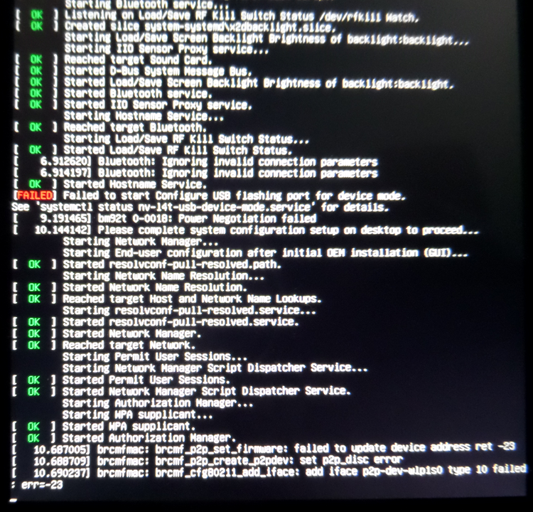

Anyone still have an eye on this thread? I'm trying to determine if this is my issue and what I should do next.
I had toggled airplane mode in ofw and tried to boot into maintanence mode, where I saw the orange screen, and booting ofw is now failing in as others have described. I tried installing L4T Ubuntu, and though I can't seem to get it to boot fully, it is throwing an error specifically about the brcm driver.
Please advise? I can attempt reflowing as I have a heat gun, but I'd like a second opinion about it first.

a reflow of the wifi ic may help
It may, but does the L4T log indicate that there is definately a problem with the wifi chip? I still can't get it to boot L4T Ubuntu fully on a patched v1, it gets stuck before initializing the display and putting up the user experience screen.
I was also wondering if flushing under the chip with a syringe of alchohol might help, if a loose bit of solder is causing a short.
Edit: Is there a way to disable wifi chip in cfw to get a normal boot?

I couldn't get any linux to boot, and I had tried Lakka and L4T 3.2/3.3/3.4 plus tried disabling the wifi driver - (it doesn't seem to save any logs to be able to diagnose boot issue), but I suppose I could try android too~ I'm not nearly as familiar with android, so how can I test wifi chip in android, besides just trying to connect?
Update: Booted Android recovery fine, and installed, but first boot into Switchroot Androd got stuck.
I didn't have problems before it stopped booting, I was going to update firmware 15.0.0 to 15.0.1 but failed to boot into maintenance mode. I had tried recovering/rebuilding firmware though, before learing about the wifi chip being a possibility.
I think I've seen people booting android/linux with a dead wifi chip, and even without the wifi chip.
Looking at the screenshot you posted I think it's indeed the wifi chip that is causing problems, as brcmfmac is broadcom's wifi driver:
https://wiki.debian.org/brcmfmac
Not sure if there's any way to "disable" the chip, other than taking it off the motherboard with a heat gun.
I meant disable in software, and I just now managed it for android anyway! (Thanks for the suggestion to try android)
Specifically I tried mounting /vendor in the recovery console and deleting brcmfmac.ko and brcmutil.ko from /vendor/lib/modules/cypress-fmac-upstream/ (though I don't know if the second one was necessary)
Which, I suppose, confirms that the chip is misbehaving but otherwise the system is fine, and joycons still work.
As to other people booting, well, I suppose it might depend on how the chip is failing, whether it is nonfunctional, or has a shorted or open pin, and which pin if so.
Edit: Perhaps not, it suddenly seems like the chip is working normally again and I am seeing wifi in L4T. Update pending...
