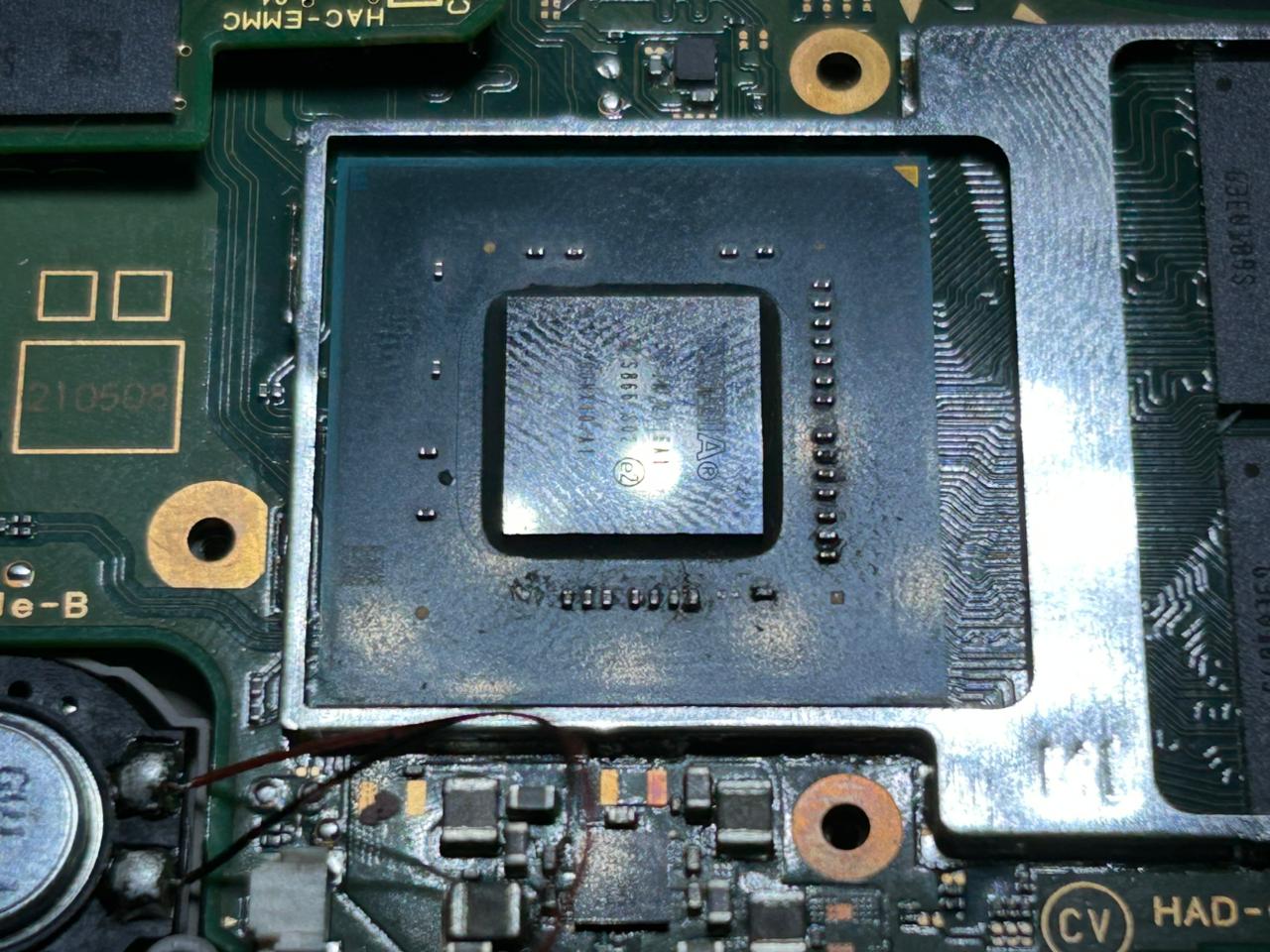

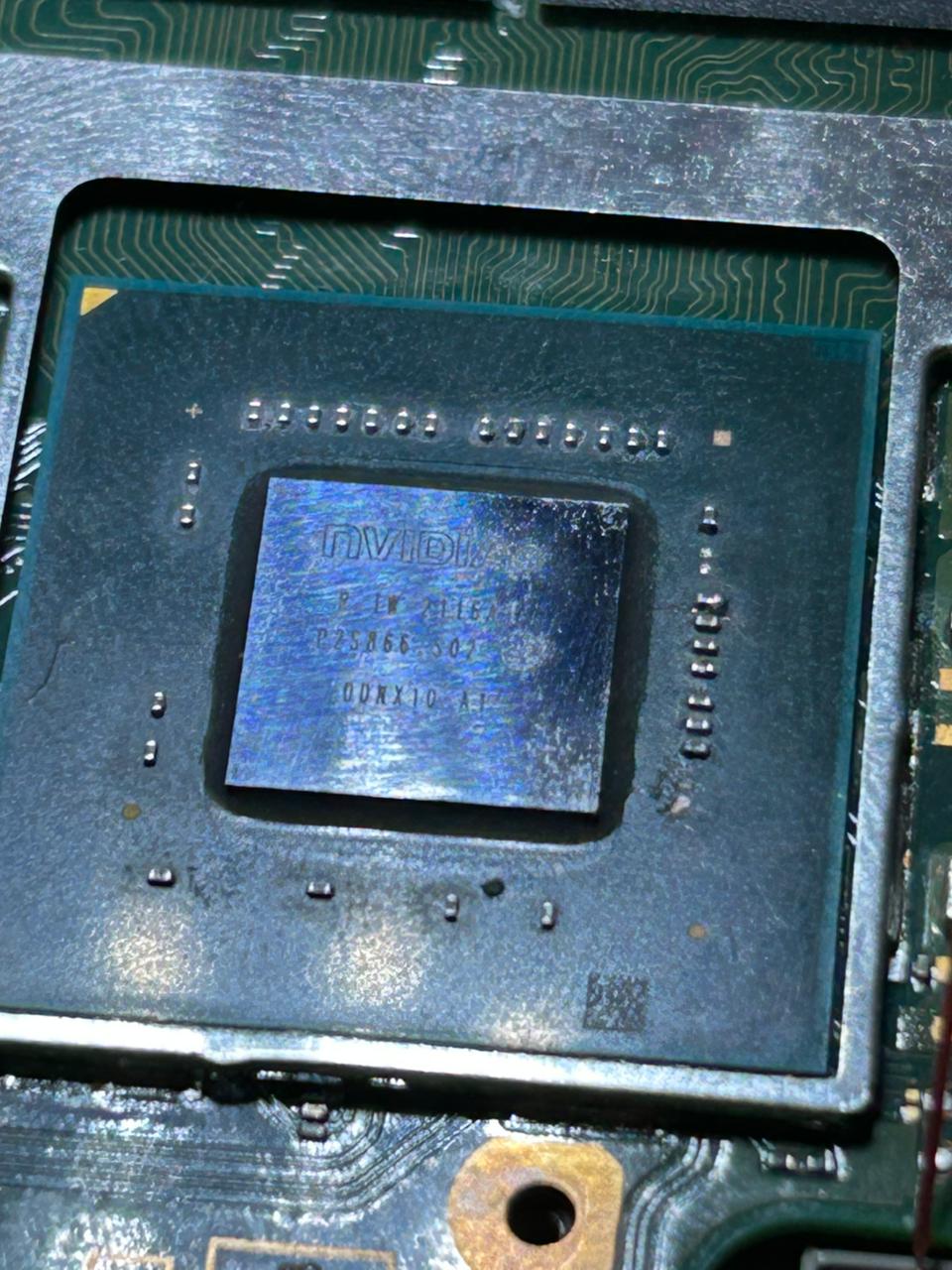

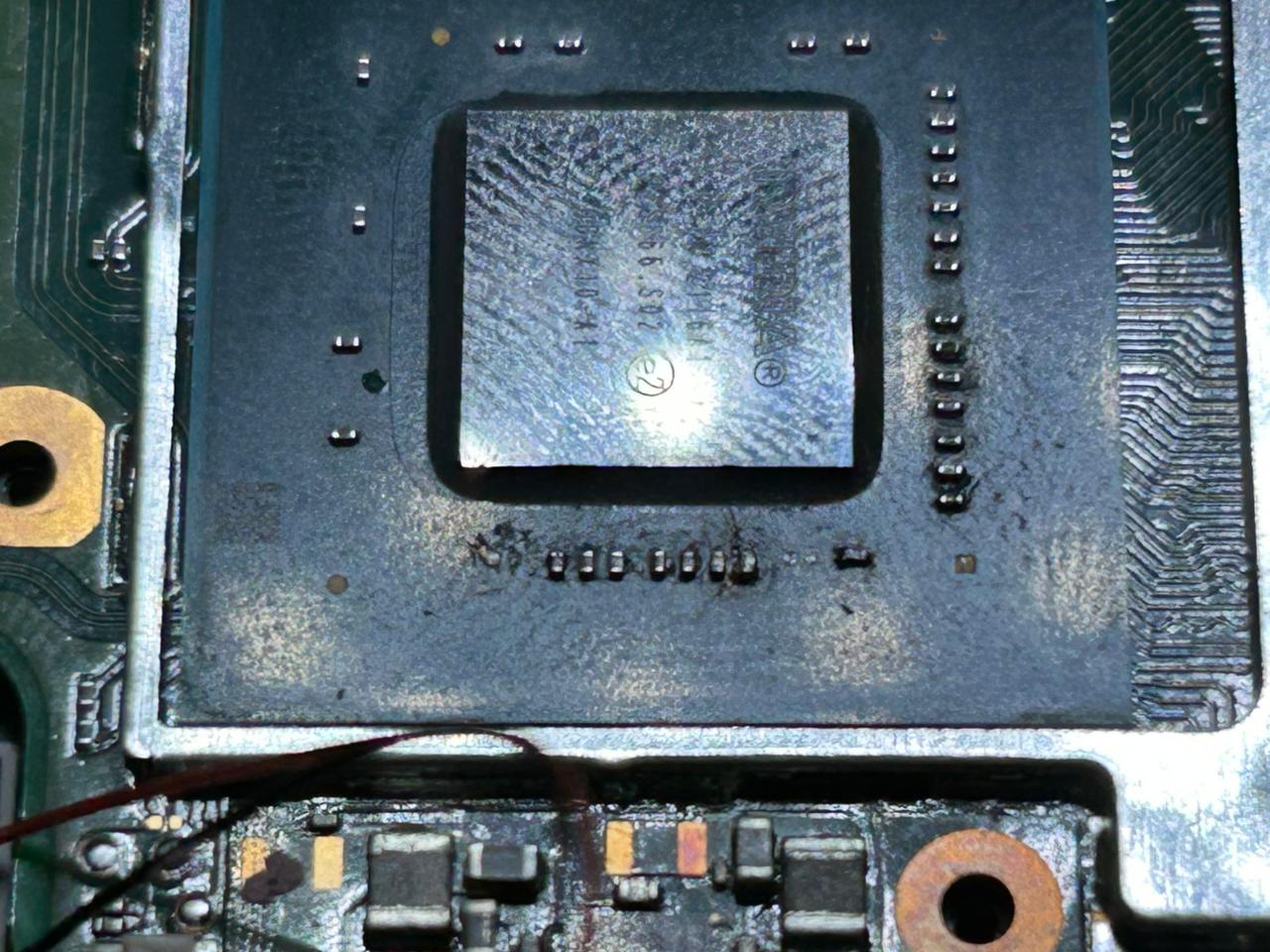

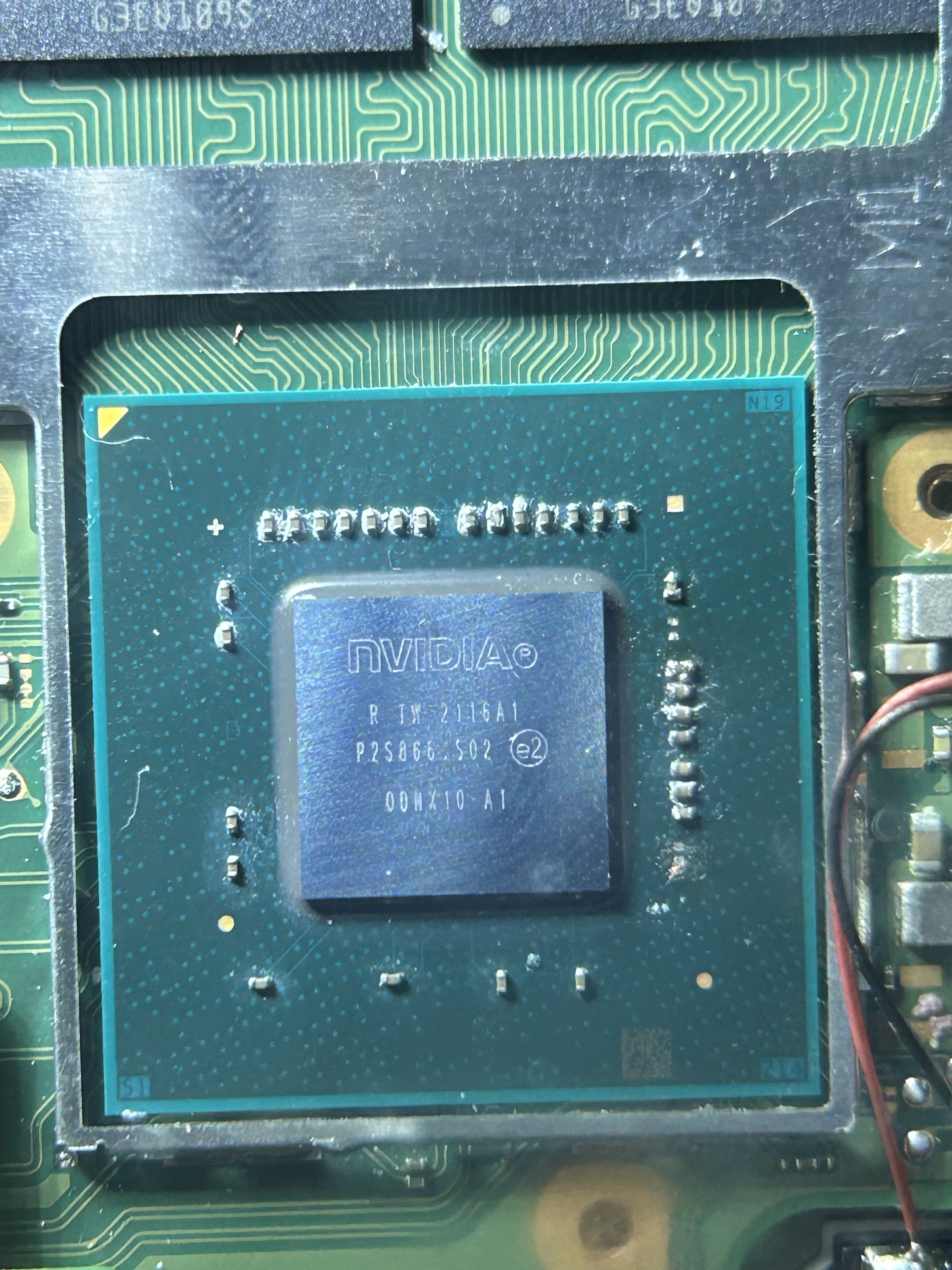

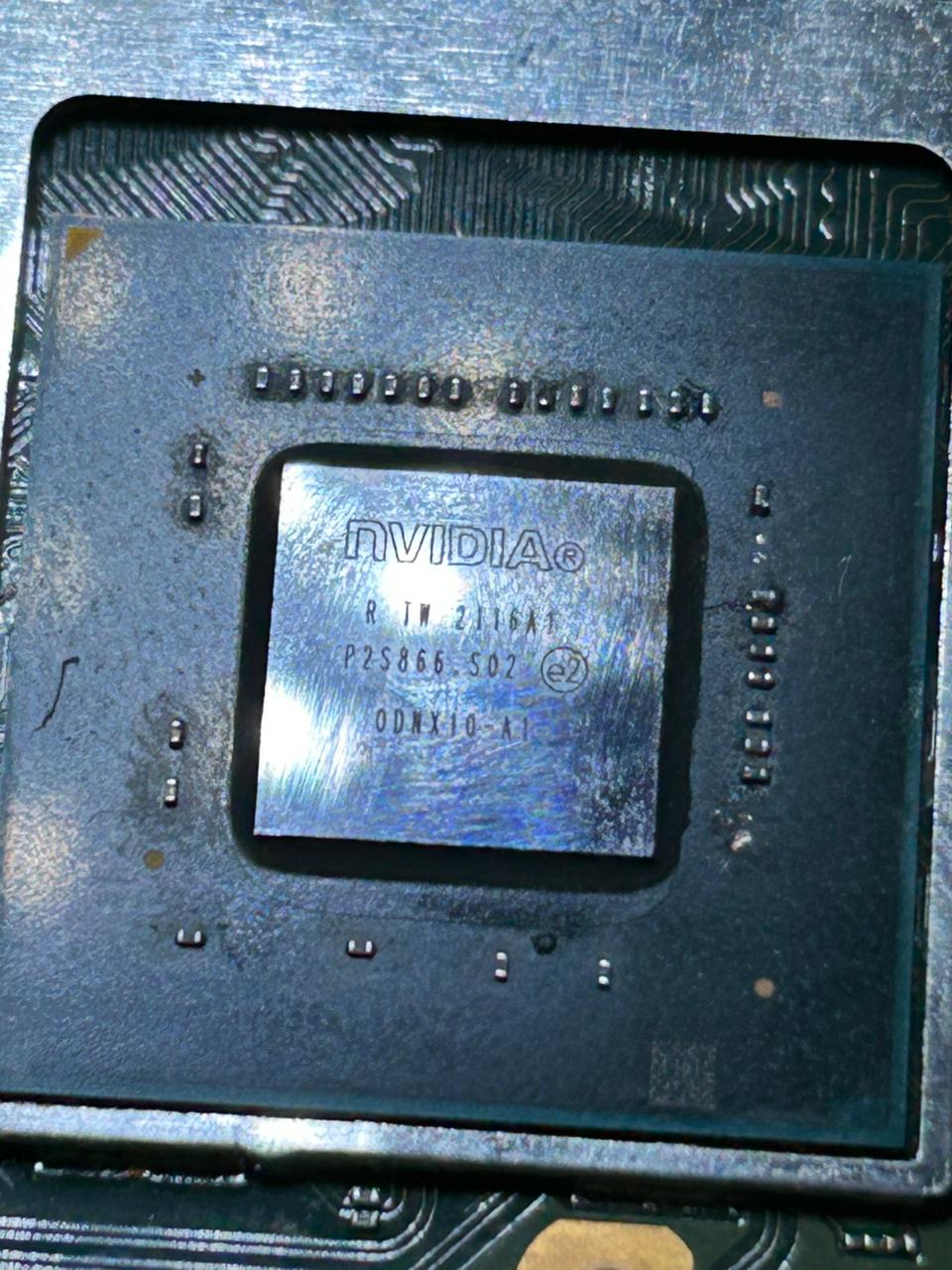

Hey everyone, I come to you in my darkest and most shameful hour, hoping to get some help with a Picofly rp3040 lite chip install gone extremely wrong on my HAC-001 Mariko V2.
During the install I accidentally lifted the SP1 pad while desoldering the flex cable because it wasn’t soldered perfectly. I could still see some copper trace remnant so I tinned it and attempted to reseat the flex but in the process SP2 broke off as well :)
I've since removed the flex completely and cleaned the area as best I can, but i’m getting continuity between SP1 and SP2 with nothing connected. When I attempt to boot the Switch I get a high pitched whine/static sound.
The Switch was booting normally before I attempted to clear the bridge, so the motherboard was healthy up until that point.
Questions:
1. Is the SP1/SP2 continuity likely a remaining hidden solder bridge, or could a component have been damaged?
2. Is there a way to identify which component may have been stressed/damaged?
3. Are there any alternate points I can use for SP1&SP2 if I manage to recover the board?
Any help appreciated.
That is probably a coil that is taking a beating.
This might indicate a short somewhere or something got already blown up.

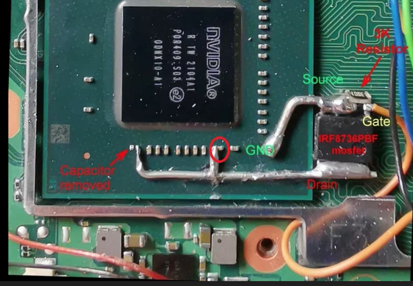

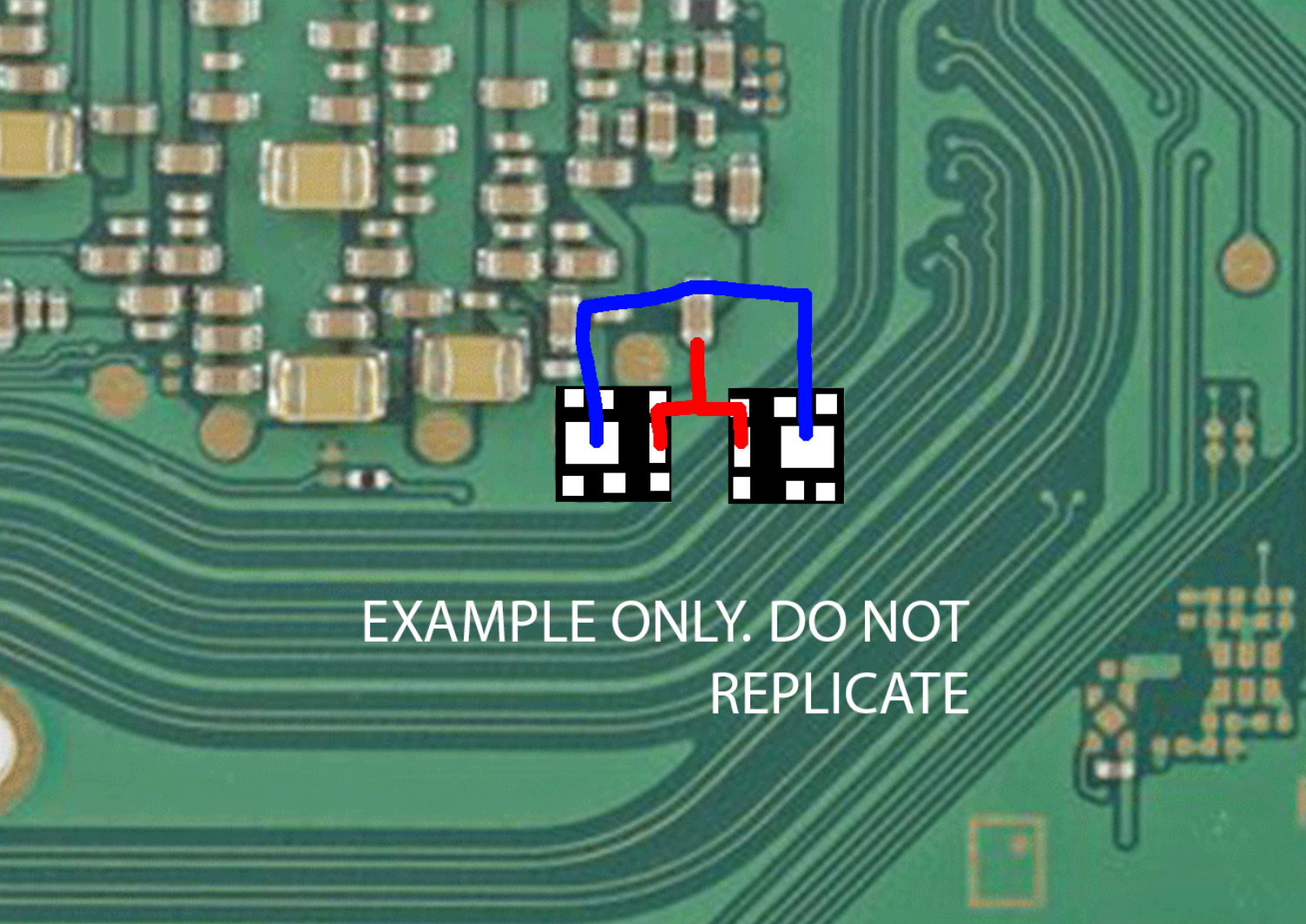

SP1 and SP2 are 'just' connected to the power rails of the MPU.
In the beginning when there were no flex cables, some people installed the mosfets on the backside of the board.
This is just an example where the contact points are :
Search the forum for a better picture or just post a message to the PicoFly thread.

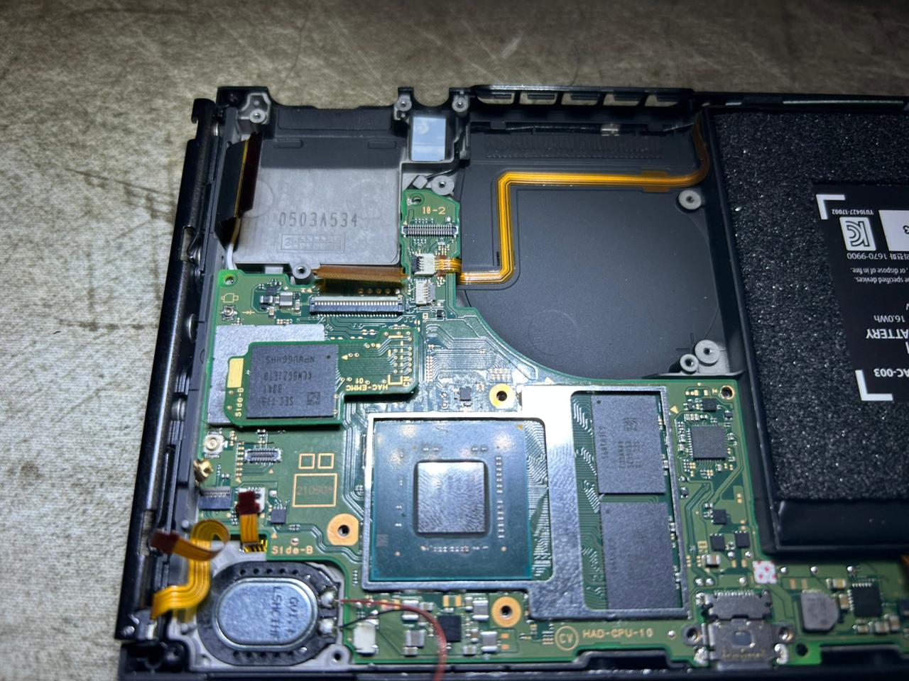

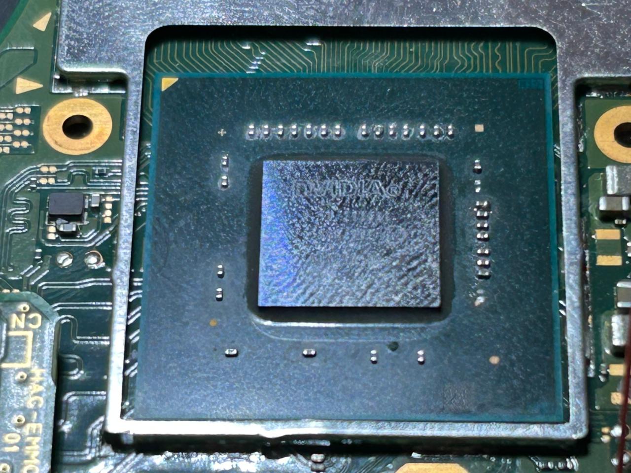

more picture around more area
don't know if this is what you had in mind.

Thanks for the detailed response.
Regarding the SP1/SP2 continuity. good to know that the insides and outsides being connected on the original Switch might explain what I'm seeing. I'll check if the same applies to my HAC-001(-01).
On the coil whine, the high pitched sound is still present when trying to boot. The Switch was booting normally before the bridge incident, so I'm fairly confident something got stressed during that, I don't have a bench power supply, but it's on the way, I'll update the thread with the results for future reference.
Appreciate the help.
this is most due to over current from buck converter, in most case is somewhere has a short. Often time people broke/crack max77812 during removing cpu metal shield, any sometime 3.3v dc-dc converter got short on output caps.
