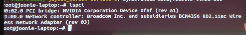

I just installed L4T on my switch and got this output, this is a working switch, I was wondering if there's anyway to dump this firmware/driver and install that on a broken switch with a IC replacement.
I did some digging and found that Wifi firmware is embedded inside the wlan module itself (0100000000000016), and those firmware files used for L4T seem to be dumped from the OFW files.
The BT module and its firmware is found on 010000000000001B,
Maybe it's possible to disable the check from the WLAN module itself.
I also came across the git report that has a script to dump the wlan firmwares used for L4T.
https://github.com/perillamint/nx-fwextract/blob/master/index.js

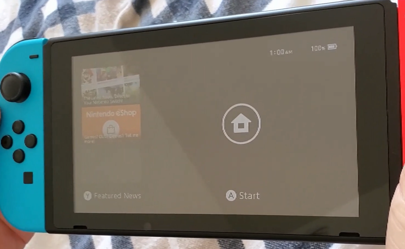

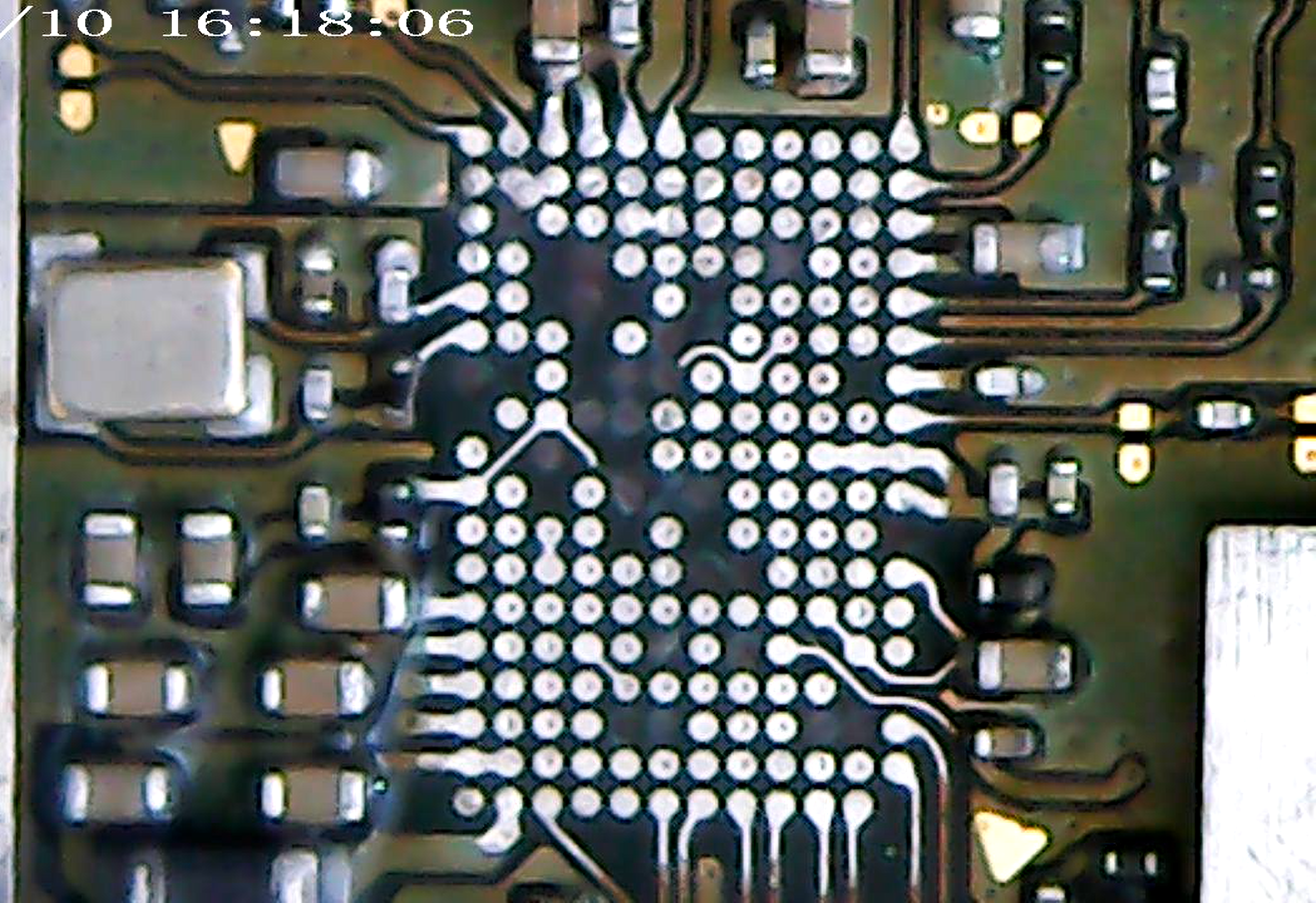

Well I finally did it!! I had already given up hope to ever boot HorizonOS again, because I noticed yesterday that I must have ripped off about 20 pads on the BGA, probably while I was cleaning the pads with my shitty iron and the solder braid was getting stuck to the board. You can see it here where all the brown spots are:
Still gave it another go today, my cleanest transplant to date (tip: reballing with solder paste is a lot faster, and using a minimal amount of flux when soldering the chip back on makes it so it doesn't swim around once positioned and the heat is applied). And voila, it's booting again!!!
Incredibly, both wifi and bluetooth are still working so I guess those pins were non-essential :lol:

I purchased a broken version 2 switch off ebay. It booted to 2nd Logo and that was it. I replaced all the chips but nothing Changed. It would only charge at .41 amps. V2 console would not allow me to inject Heckate so I thought it was toast. Purchased some .25mm solder balls and pulled the WiFi chip off a donor board. Reballed the chip by hand and replaced it on the board. To my suprise the console booted right into its firmware then WiFi and bluetooth work perfect. I am so happy and it's because of the info from Grimdim and Mattytrog. Both of you are legends. Thank you!!
Reactions: Ottoclav
Nice to hear that, now i want to try that with my switch too.
My problem is that i don't have an air solder / smd rework station...
Maybe someone around Vienna is reading this and can help me out.
Hi H0ppus,
Not sure what the infrared station is you mention but a hot air soldering station is sufficient. I would highly recommend getting the right stencil though, I got mine from aliexpress. Just checked and there are a bunch for sale, just search 'bcm4356 stencil'. You'll need solder balls, I use 0.25mm leaded. (haven't tried with paste, might be easier to handle)
Also good solder braid to clean the pads and chip, tacky flux, and Kapton tape to hold the chip in place on the stencil. Careful when you heat the balls to affix them to the chip, as the stencil started bulging so I pressed down on it with some tweezers while heating. This is the procedure I followed, but I'm no expert :
-remove both chips with hot air
-clean the pads on board and chip with solder braid, flux and soldering iron (very important to get it as smooth as possible here)
-apply flux to new chip, tape it to stencil with kapton tape aligning pads to holes
-apply balls to stencil, fumble around until there's exactly one ball in every hole, remove any superfluous balls (magnification required!)
-heat balls until shiny
-apply flux to board and solder on new chip
