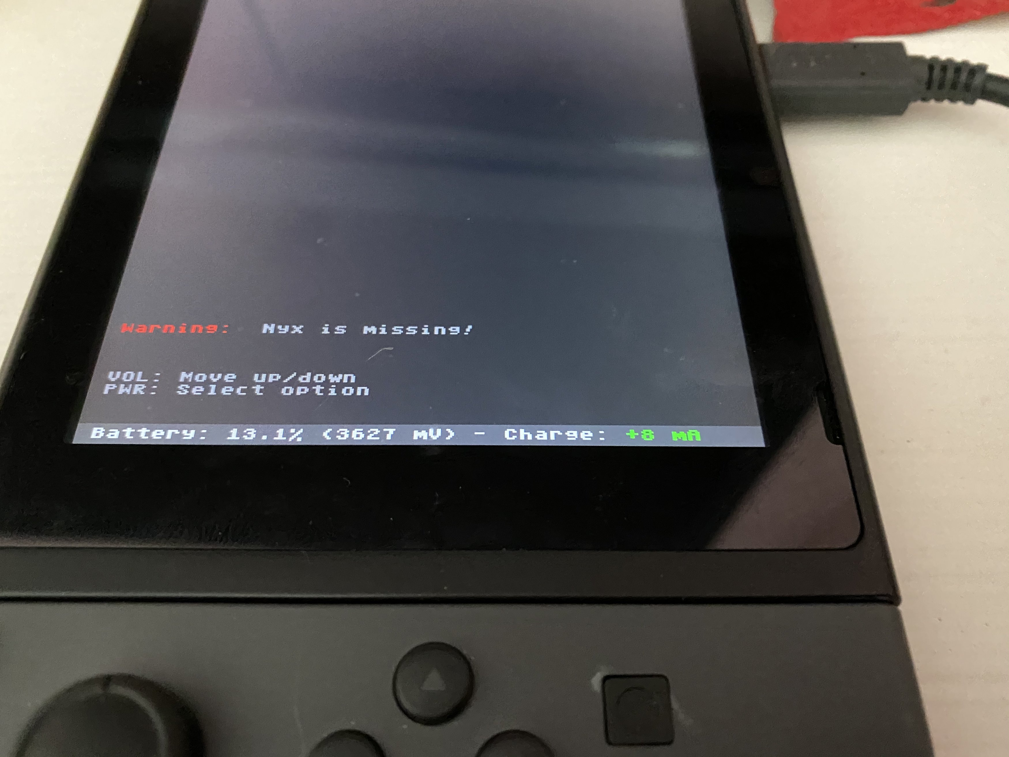

Troubleshooting assistance needed. After running Trinket M0 chip for a while, I am now noticing the switch is not charging.
Plugging in multiple usb c chargers shows the charging icon, but battery does not increase.
Switchboot shows charge rate around 10-20ma, but never higher. Im on v1.5.3beta
I’m ready to pull it apart and recheck all of the wiring.
Sent from my iPhone using Tapatalk

Hmmm...
My first thought would be check your wiring. Check you haven't bridged anything around the usb strap
same problem here...
So I fixed it by booting the switch all the way to the home menu, holding the power button and going into sleep mode and then double pressing the modchip reset button to get into bootloader update mode and connecting the USB cable.
