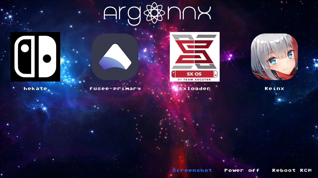

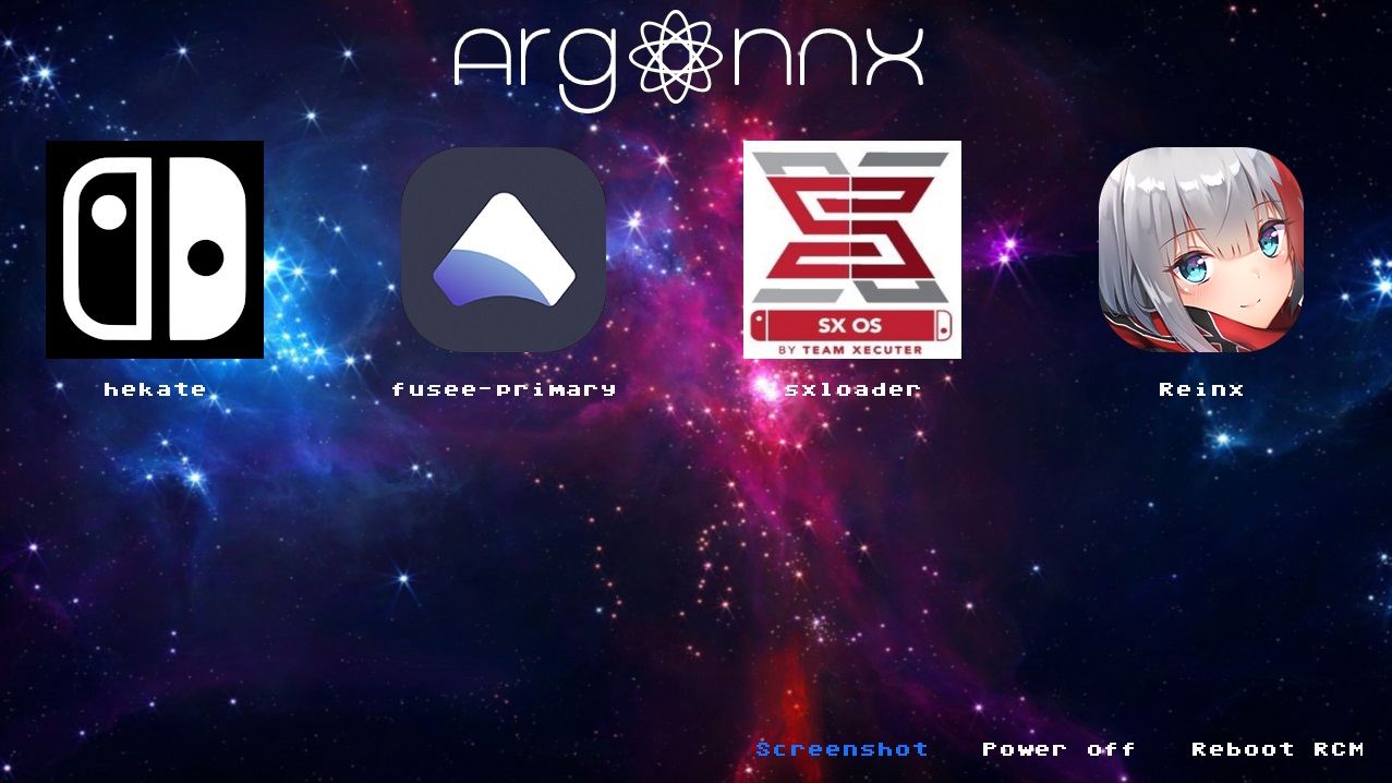

A new mode coming in 0.9.8. Selectable with long-press vol. Replaces the autoincrease modes as nobody uses them anyway.
All gfx is in /bootloader with Hekate stuff to keep things tidy. Uses bootlogo.bmp as background same as Hekate. So configuration is a minimum. Just on test at the moment.
View attachment 156957 A new mode coming in 0.9.8. Selectable with long-press vol. Replaces the autoincrease modes as nobody uses them anyway.
