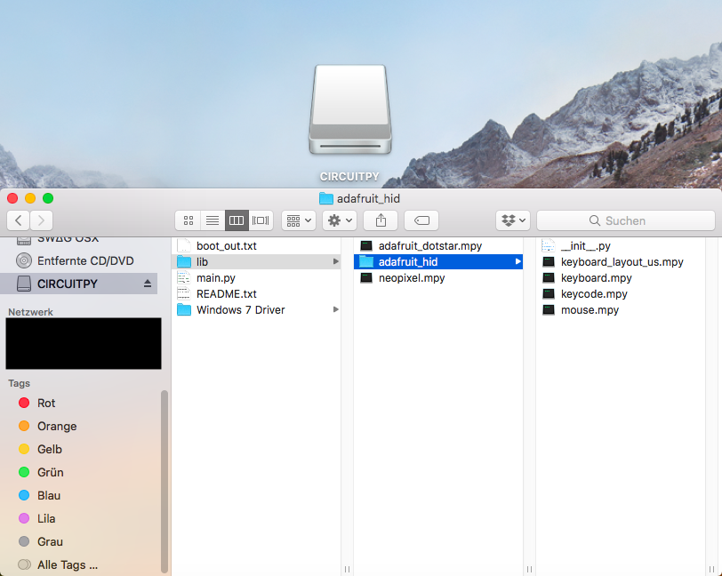

I am stuck at step 4 due to my chip not containing the same data as the example in the guid. I am a bit confused an would appreciate help with how I should proceed from now on. :)
It is a Trinket m0 from Adafruit
Edit:
I fixed it... when I can call it like that xD I guess I pressed the button in the wrong rythm? Hmmm... however now it works like it should (y)

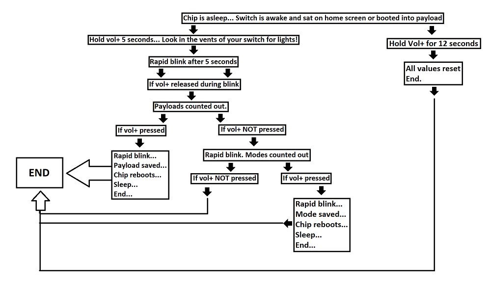

Simple flow chart to explain how the new vol+ feature works in 0.9.7.
Not yet released. Coming. Got to do the pots and housework first!
Reactions: Dougiejones
