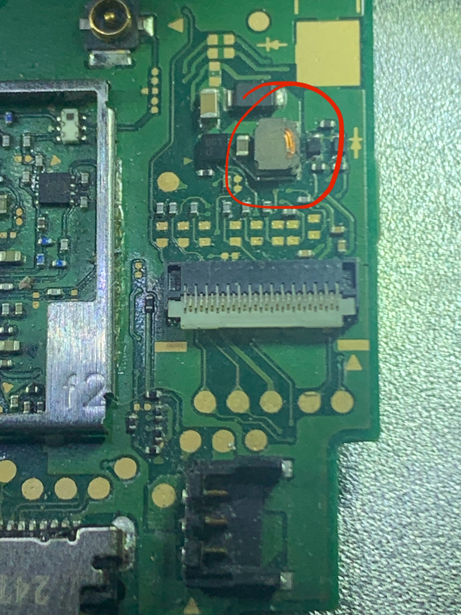

Hello lovely people,
I've used a hacked switch for years now but this morning i needed to update the switch firmware in order to load more games. I made a grave error which ill detail below, can anyone confirm if the switch is fixable by replacing the M92T36 Chip on a bricked switch?
Downloaded new hekate and atmosphere, loaded onto sd card root. Ejected, booted up the stock sys nand and added a new wifi network. Here's where i think i went wrong, after adding the network, i did not block the nintendo servers as im aware you should with a hacked switch, i then went to system, update firmware. I took my eyes off the switch at this point, returned 5 minutes later and it now wont connect to Tegra / RCm, its stuck on black screen. Hard reset flashes up the logo then disappears back to black screen.
Is it now doomed forever and where was my mistake that allowed this to happen?
Notes: i've updated firmware before with no issue but I must have done SOMETHING different this time.
Hoping someone here can advise if there is a potential fix for my stupidity????????
Additional note: There are repair companies near me that offer to fix bricked switches (but in the description of their service, it says to specifically fix switches bricked by using third party docking equipment after 5.x firmware update.
Your expertise is much appreciated
Some things are not clear. You said you're aware you should block Nintendo's servers with a hacked Switch, but you updated the firmware from the system menu? How did you expect to update that way if Nintendo's servers had been blocked? Most people with a hacked Switch update with daybreak, and get their update files online from certain websites. If you have a Nand backup, now might be a good time to restore it.

I wouldn't use the dock, I would plug the Switch directly to the charger to get more juice. Several people offer several different methods to revive a dead battery. Search the topic on this forum.

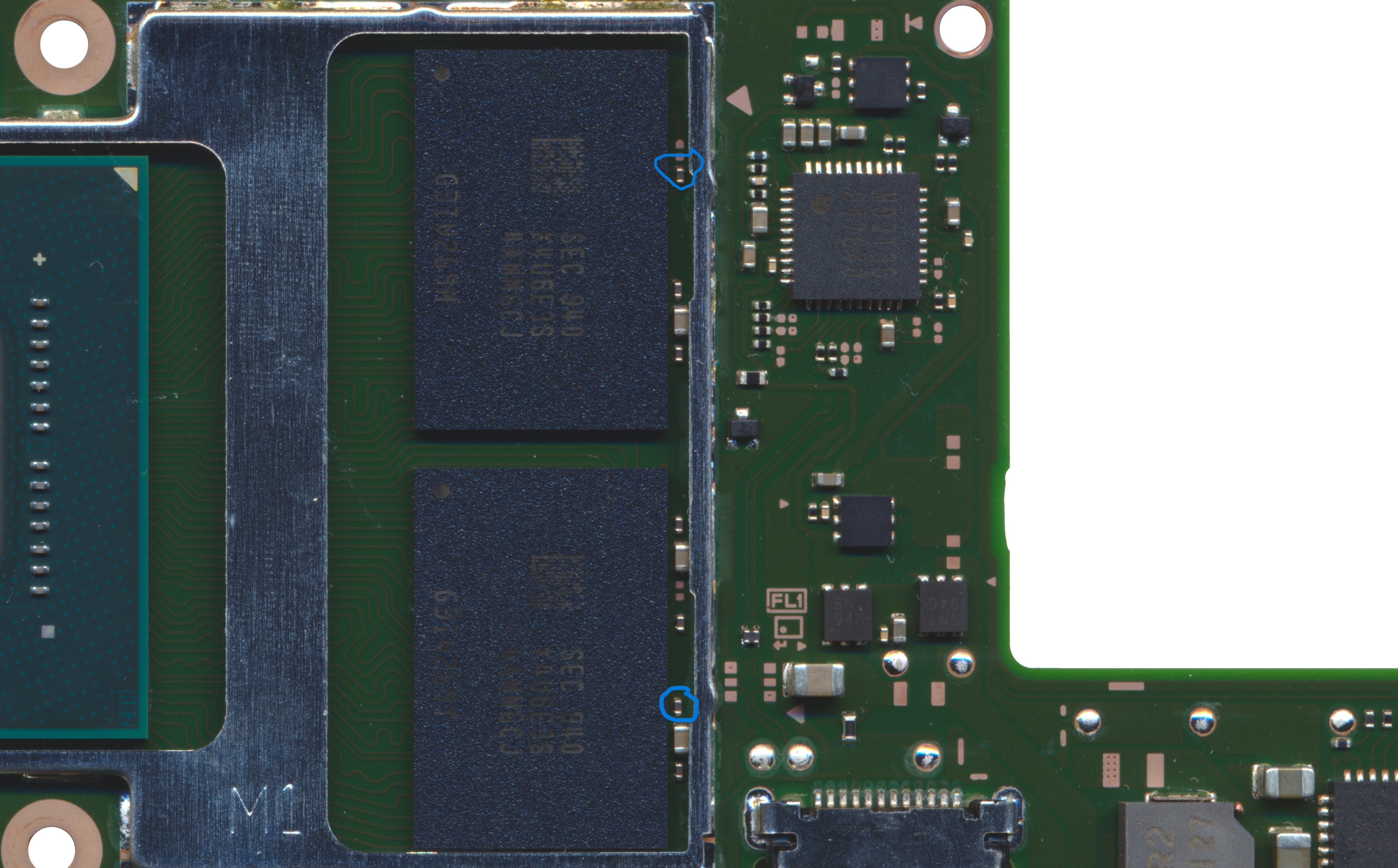

Hello!
I had a switch lite I wasn't really using so I thought I'd have a go at installing a modchip on it. I've had some experience soldering before but nothing this tiny lol. Well something went wrong kinda like expected and I'm not sure if I'm able to get it functional again without successfully installing it (to be specific I think I connected point C to the pad it's supposed to go on and the pad below it which shorted them together. I read elsewhere that this would corrupt the emmc which would explain why it doesn't boot properly anymore)
Anyways what's happening right now is the three long pulse error code for glitch max attempts reached. I'm just wondering what my next steps should be from here.
I've attached pictured of my soldering if that helps
