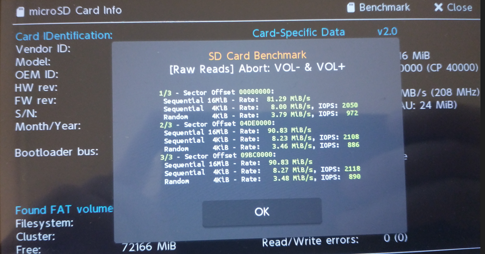

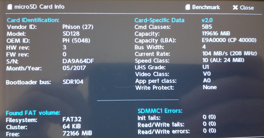

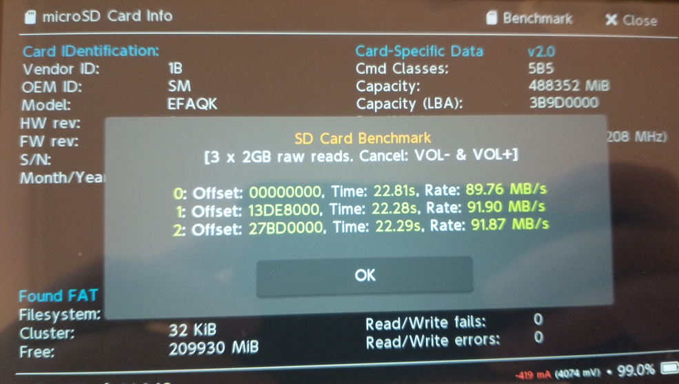

Ok so I did that, got the following info:
Compared to my other switch that is working nicely(sysnand)
EDIT:

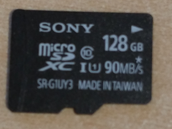

So I put the card from my working switch into the slow one to benchmark. The speeds where equal to the working switch, picture 3 above. So the problem lies in the SD card for sure somehow.
Sd card:
Great work doing the SDCard swap and testing again. If you’re seeing performance problems following the card that’s a strong indicator of the culprit. I would back it up using Hekate to save the emunand (boot0/1+GPP) and then use windows to copy the fat32 partition. Once all that data is safely on your PC, format it to FAT32 using rufus and then restore the data. At the very least it will defrag your data for you and give you the best shot at contiguous reads.
At the drastic (and more likely) end you will need a new SDCard. At least you will already have backups you can copy over to the new SDCard when it arrives.

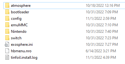

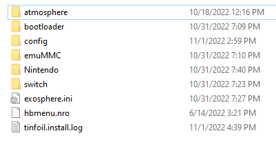

If I want to recreate my Emunand, which folders on my sdcard should I back up before doing so?
EmuMMC and Nintendo and if you have a hidden emunand partition you will want to use Hakate and backup BOOT0, BOOT1 and GPP (make sure you select emunand and not Sysnand when you do the partition backup)
Once you’ve done all that you’ve almost copied the entire card so…you might as well copy the entire card.
What's the Nintendo folder? I see that there is also an emuMMC/Nintendo folder.
If I create a new emuNAND, wouldn't it create the emuMMC folder? Trying to understand the need for backing up the emuMMC folder.
Emummc folder has things like your screenshots and downloaded game content on SDCard. They are under the Nintendo folder. The regular Nintendo folder is the same thing but for Sysnand.

I think I understand better what you are trying to do…you will be leaving the rest of the data where it stands.
If you are just going to recreate a new Emunand then copying the emummc folder and the hidden partition will suffice.
