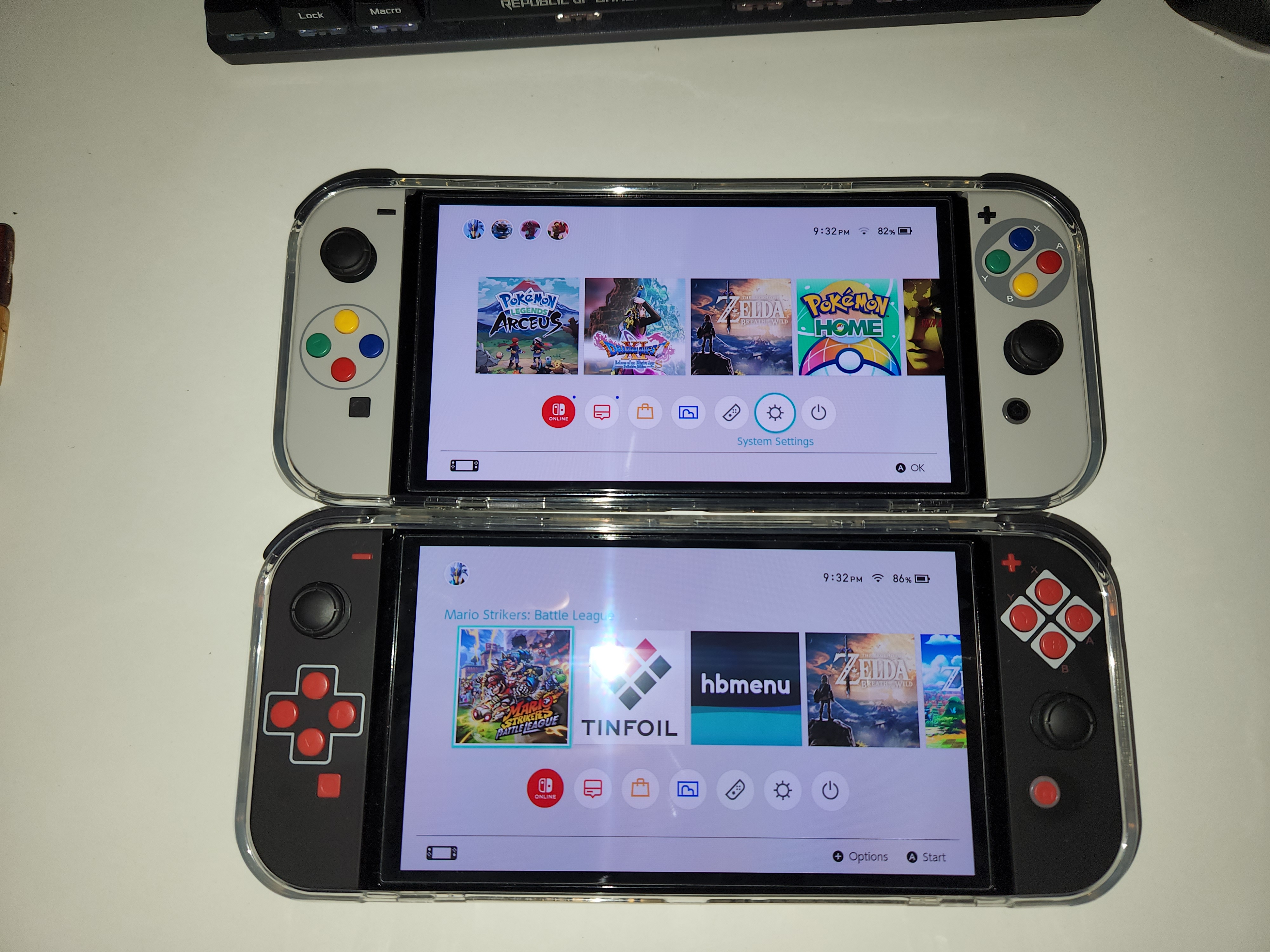

Did the joycon shell swap for SNES and NES theme few months ago.
He specified his gender
Looks really cool.
I did not mention their gender, I'm referring to what model that they have. :rofl2:
