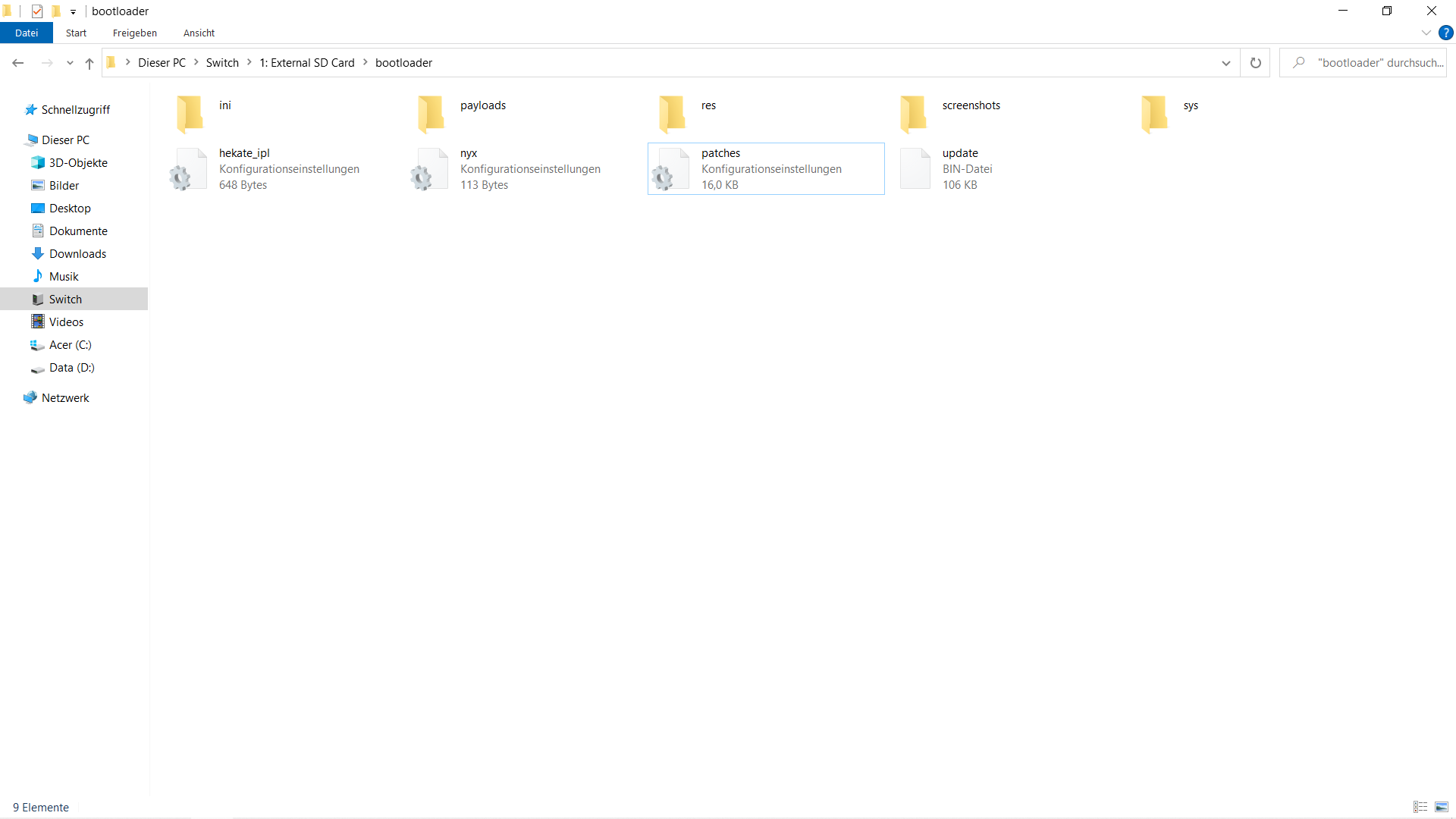

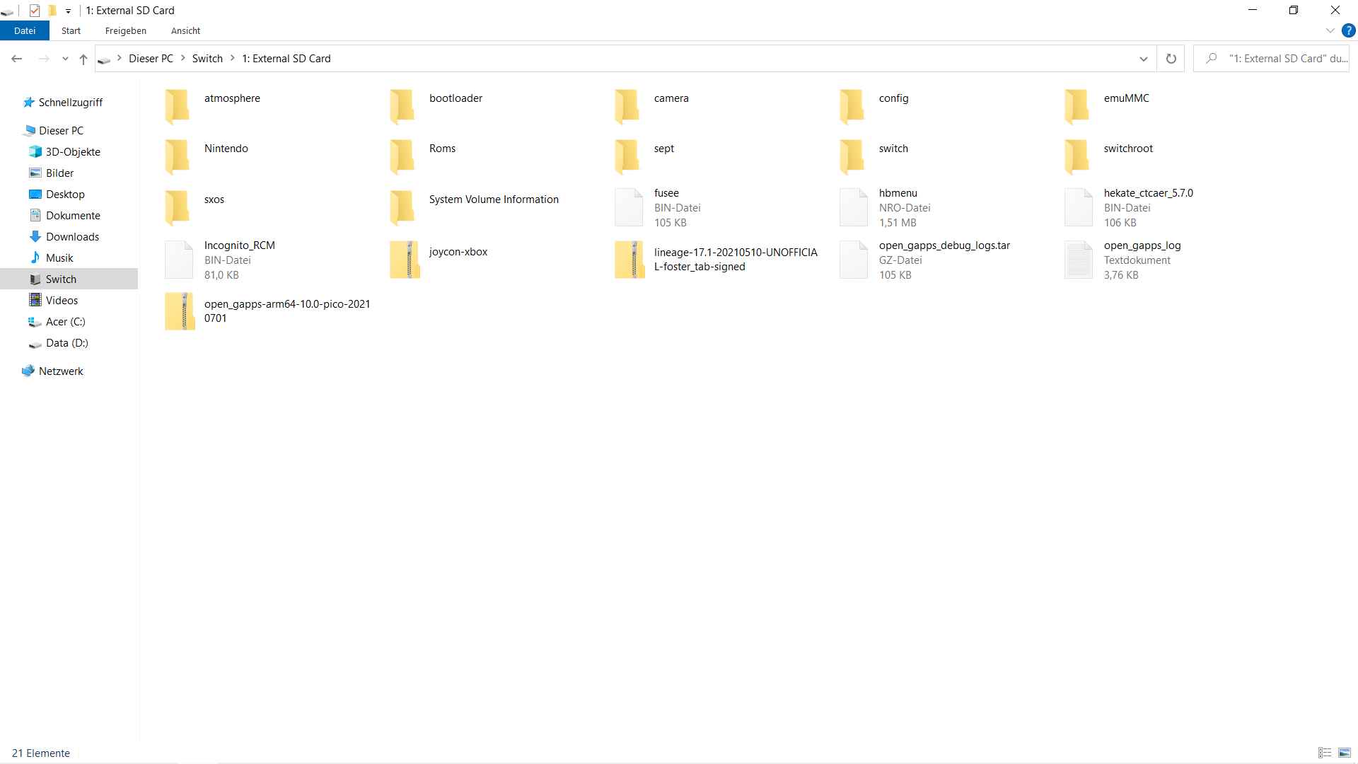

Hey Guys, I can't start "Android 10 Lineage" anymore (black screen), since I updated my "OFW + Hekate and Atmosphere".
Hekate 5.7.0
AMS 1.2.6|E
My Switch was below 4.0.0 and I updated to 13.2.1
I'm using EmuNAND CFW for Atmosphere.
Does anybody know how to get rid of the black screen? Some people say, I need to clean my SD Card and get a fresh install of everything again. That was a lot of work, would like to avoid that somehow. Can I somehow just update my Android 10 Lineage Install? :/
Hekate 5.7.0
AMS 1.2.6|E
Post your /bootloader/hekate_ipl.ini contents to start.
[config]
autoboot=0
autoboot_list=0
bootwait=1
verification=1
backlight=100
autohosoff=0
autonogc=1
{hekate with sigpatches}
{Provided by: WiiDatabase.de
{--- Custom Firmware ---}
[CFW (SYSNAND)]
emummc_force_disable=1
fss0=atmosphere/package3
kip1patch=nosigchk
atmosphere=1
logopath=bootloader/bootlogo.bmp
icon=bootloader/res/icon_payload.bmp
[CFW (EMUMMC)]
kip1patch=nosigchk
atmosphere=1
emummcforce=1

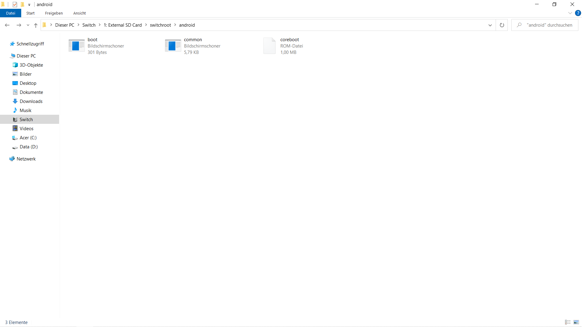

here the android ini:
[Switchroot Android 10]
payload=switchroot/android/coreboot.rom
id=SWANDR
id=SWANDR

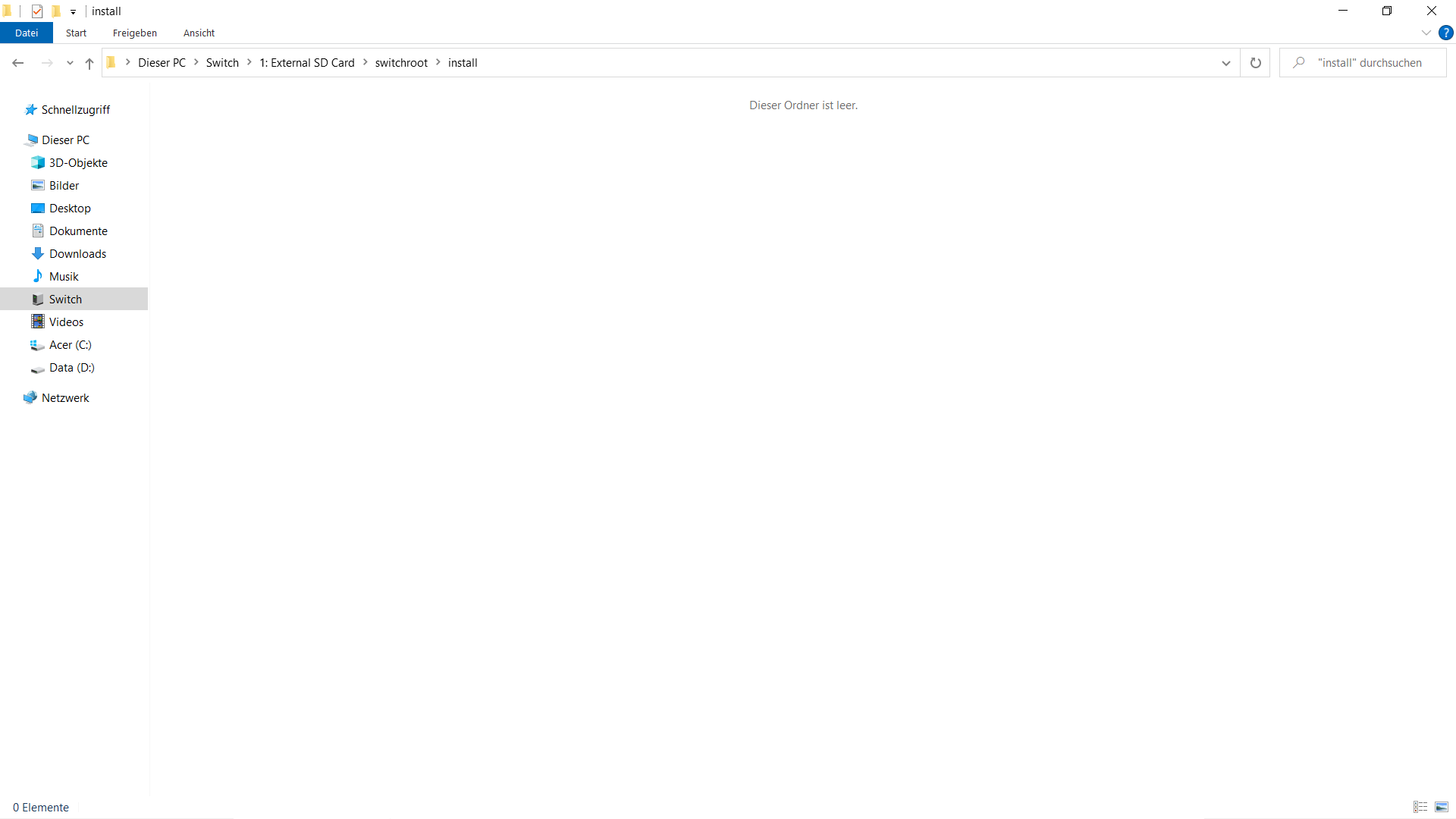

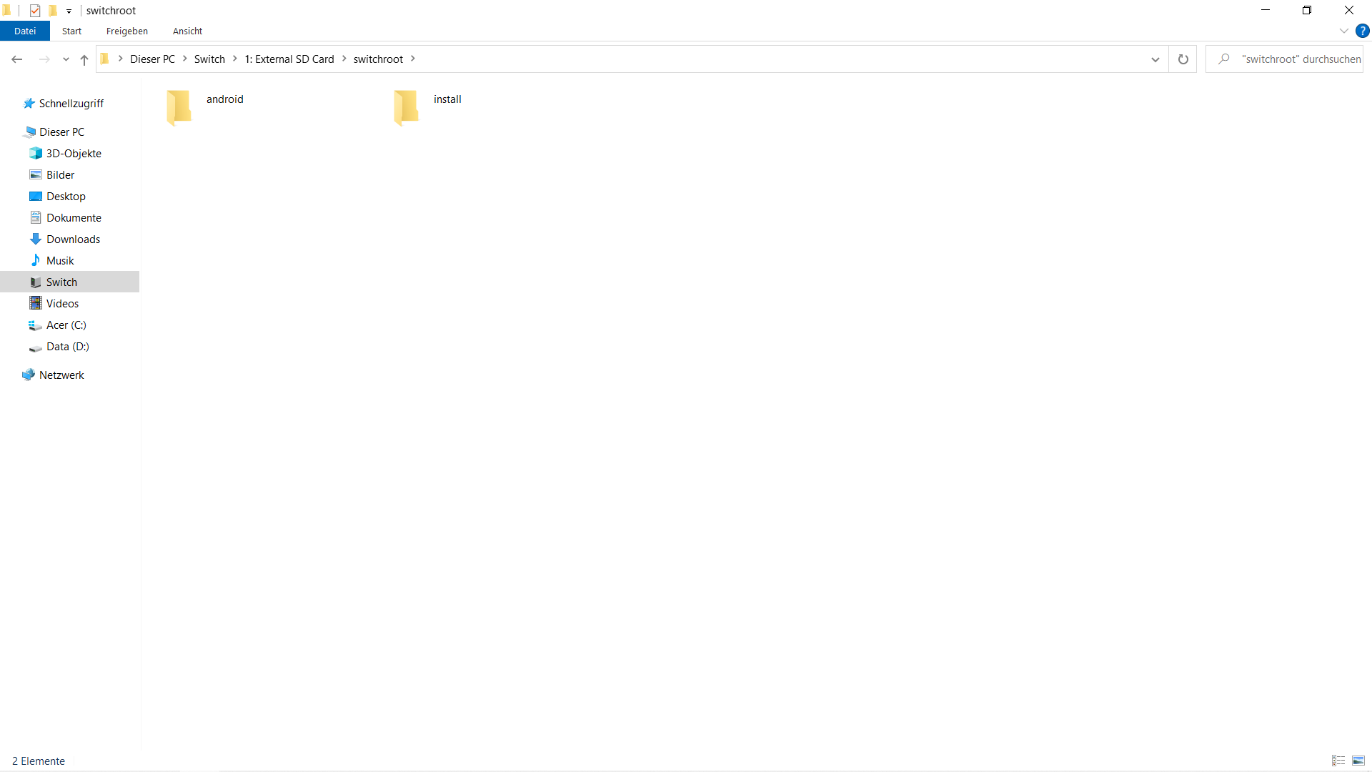

Thanks for interpreting correctly…android.ini is what I was actually after. (Was thinking maybe it got overwritten in hekate_ipl.ini but that’s clearly not going to be the case.)
Does everything look good in /switchroot/android? coreboot.rom is intact?

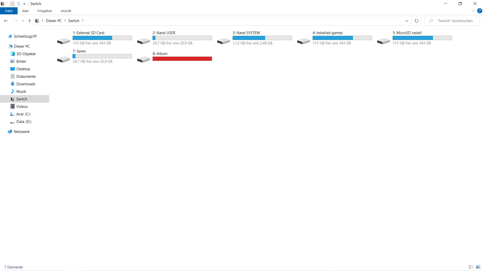

Next we need to look at partitions using something like AOMEI or EaseUS. Make sure all the partitions are intact. Please post a screenshot of your partitions.
Thx for your help, really appreciate it :)
Here are some Screenshots of my Partitions, Switchroot folder etc.
I'm using DBI to navigate through my SD Card btw.
